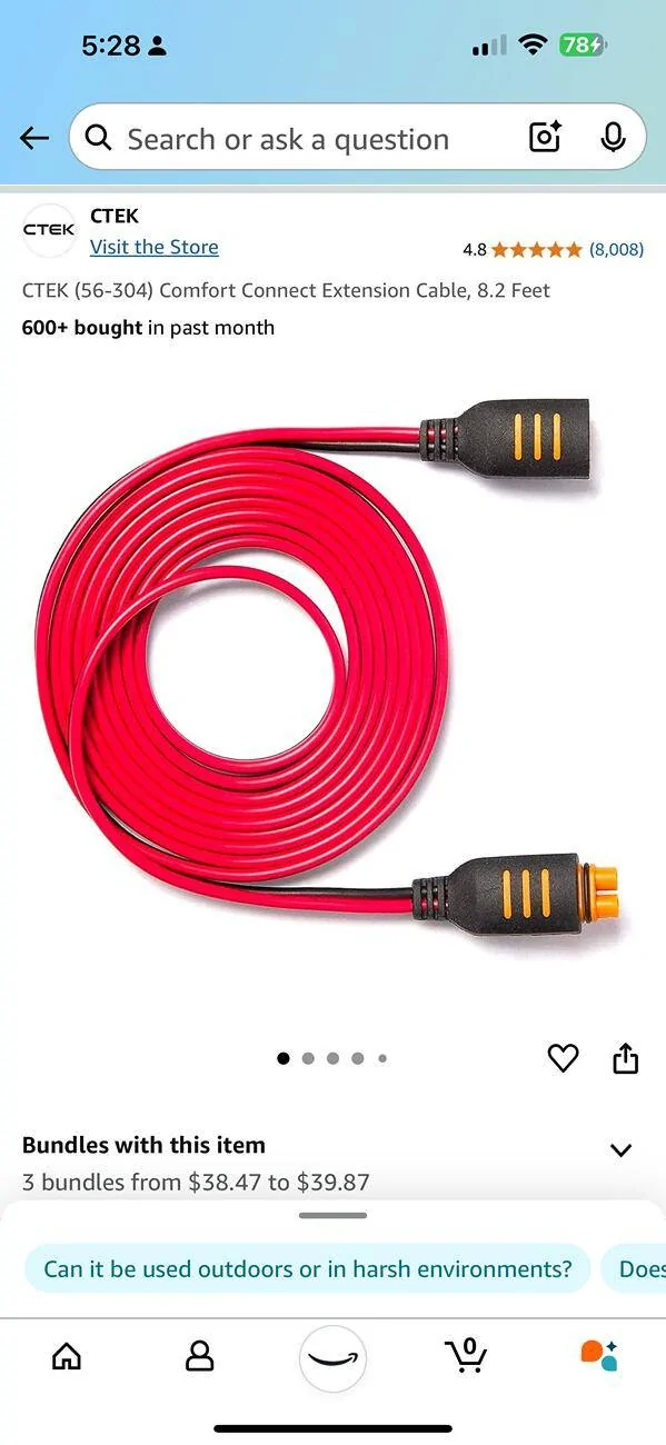

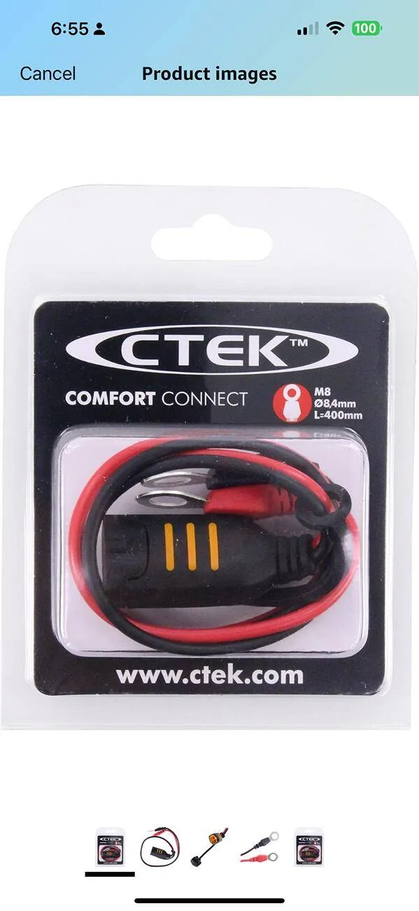

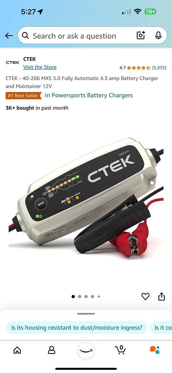

Had another thought. I have an ‘03 Mercedes SL500. Has 2 batteries - 1 in engine bay for starter only, and an AGM battery in the trunk that runs all accessories, etc. If it sits idle for too long the battery can get low, so I often keep a CTEK smart charger on it.
To keep things simple, I picked up the charger and one of their extension cables. The charger also comes with a short cable with lugs that can be installed directly to the battery cables/terminals. The other end is a weather proof “plug” that can be plugged into the charger or extension cable, etc.
Is there any reason we couldn’t just install a cable like this directly to the battery, and perhaps route it to somewhere externally where it could be accessed if need be (behind front bumper, etc)? I haven’t had anything apart, so no idea how tight everything is in there. But this would sure make access a whole lot easier, and prevent the need to cut holes in panels or have to open the frunk to get going again. In the event the 12v is dead, I’m wondering if we couldn’t just connect that to one of the recommended jump start units (via a DIY adapter cable made from the CTEK extension cable)?
Note: The cable connecting to the battery is available in either 6mm, 8mm or 10mm eyelets.
