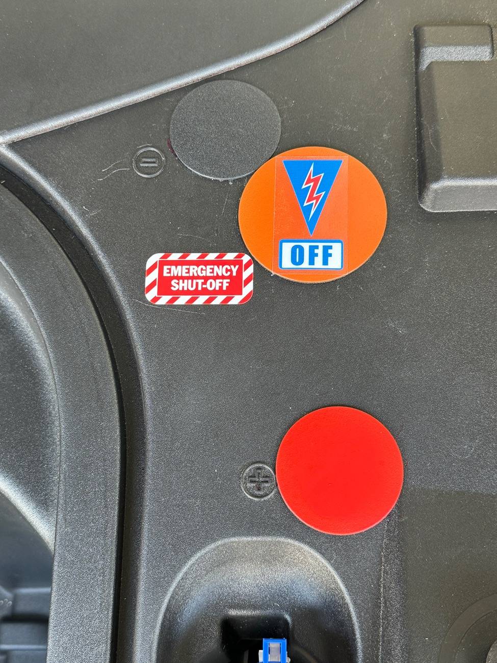

Many European cars have batteries hidden in the trunk or under the seats behind panels. They often have remote terminals to allow jump starts but you can still get locked out and not access the battery without power. I'm not calling out that this is a good idea just more common than one might think.
I may be incorrect in this, but I seem to recall seeing images of other EVs whose 12v batteries are similarly “hidden”. Although not the greatest design from a maintenance point of view, it’s not unique to Ford.
But, it It seems to me Ford could incorporate a cheap, cost effective, solution for at least accessing the jump points to avoid some of the frustration and aggravation of a dead 12v battery. For example, see the attachment, and if I could do this surely Ford can do it.
There are other examples on the forum, some are truly elegant solutions, like Steve’s, @HuntingPudel , but the simple access ports have a benefit of being a cheap solution not requiring sourcing any hardware or additional wiring.

Anyone have an idea as to how Ford Lease might view this mod (assuming done neatly) upon vehicle turn in? I have 3 yrs to go on my ‘24. Would like to create easy access to the terminals - now, while I don’t heed it. However, don’t want to get dinged a bunch of $$$ for cutting holes in that panel. Thoughts?

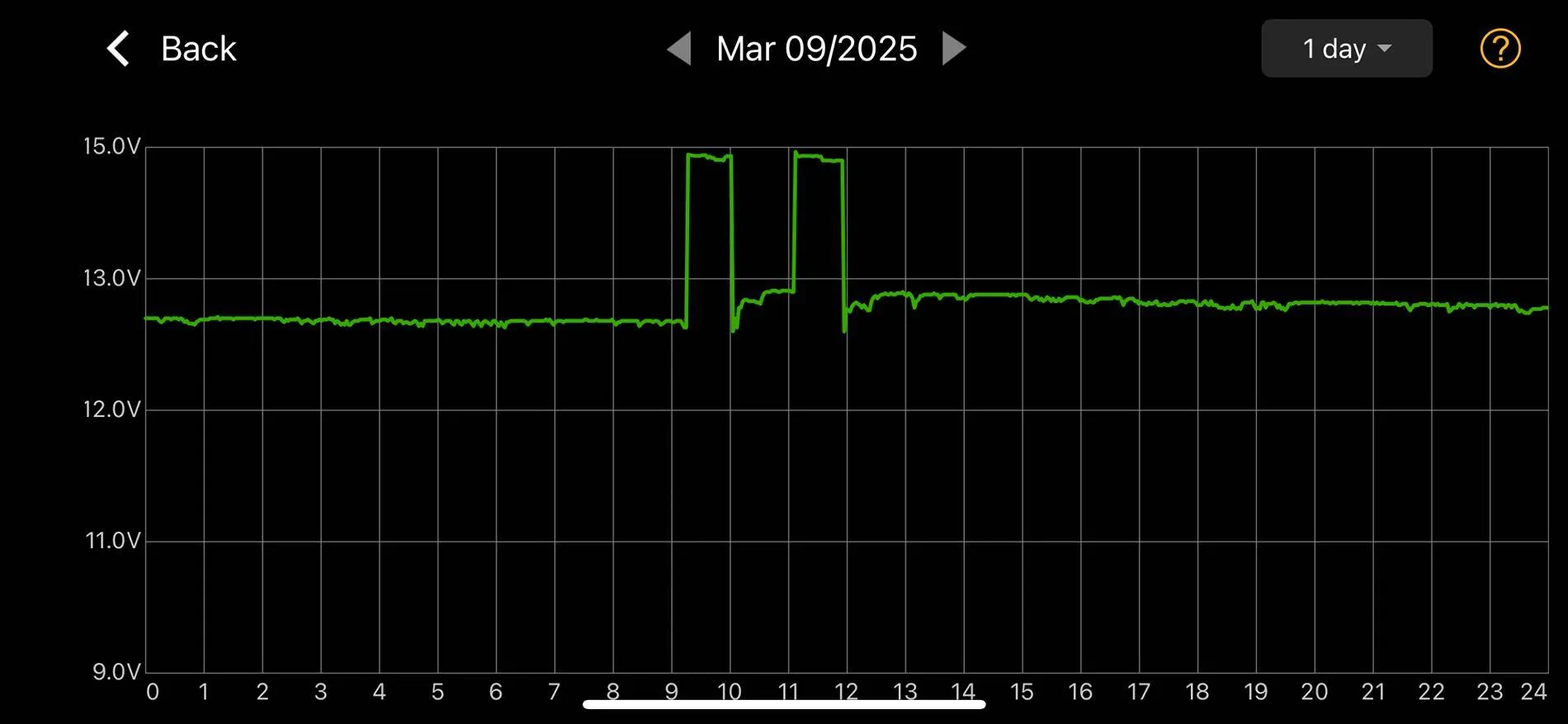

When the car is turned on it does provide a 15v charge to the battery charging the entire time you are driving. Turtle mode more would in theory indicate something is wrong with the big battery….which probably cleared itself out once the car was rebooted.
Ford Mustang Mach-E Mach E left us stranded IMG_5555
Can always tell when I’m driving based on my batteries logs.
Could buy a spare panel, can’t find the part number currently but I believe it was under $200.
They won’t be able to see it. If you follow these instructions, it’ll be almost invisible.
https://www.macheforum.com/site/thr...nect-relay-for-safety.4107/page-7#post-309362

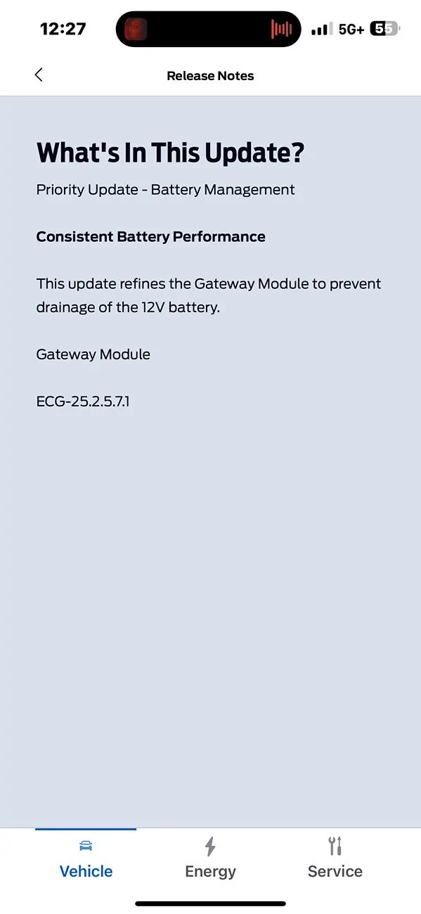

Yeah I think you’re right. The update I received on Saturday was for 12 volt drain but it was related to the gateway module.
This looks like an OTA update. I don't think updates via FDRS show in FordPass. You might be the first car I've seen get ECG-24.2.5.7.1. Are you in the EAP?
I've seen Lightnings get ECG-24.2.5.7 last month to update the GWM.
