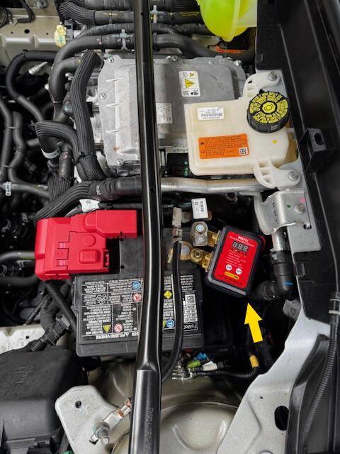

I don't think I want to ever have to leave my MME or Lightning at airport long term parking (I have an ICE Expedition backup for that), but if I did, I'd make sure to press the "Off" button on the extra remote attached to my keyfob that disconnects my 12V battery. It's also great if you ever need to do a complete "reboot" on the car. And you won't lose any panel clips this way.....
Ford Mustang Mach-E Mach E left us stranded MME_Battery_Cutoff2
I got it from Amazon. I put one on the MME after we all went through the "gateway bug" late last fall that was causing lockouts. I put one on my Lightning as well but that battery is a lot easier to get to. Better to have it before you need it.

That’s the first I’ve seen one of these. Seems like a great idea. Also an added theft deterrent.
When off, other than no updates, no alarm, etc. - any other drawbacks to leaving the 12v disconnected for extended periods? Can see a lot of upside.
Nothing comes to mind really. I haven't had to leave it disconnected for any length of time, but unless @Mach-Lee can envision a suboptimal scenario, I don't think it's gonna hurt anything.
11,365
25,025
Nope, it would reboot all the modules, clear some codes, and resets some adaptive strategies, but that would probably be fine for occasional use. I just would recommend you do not use it frequently.
