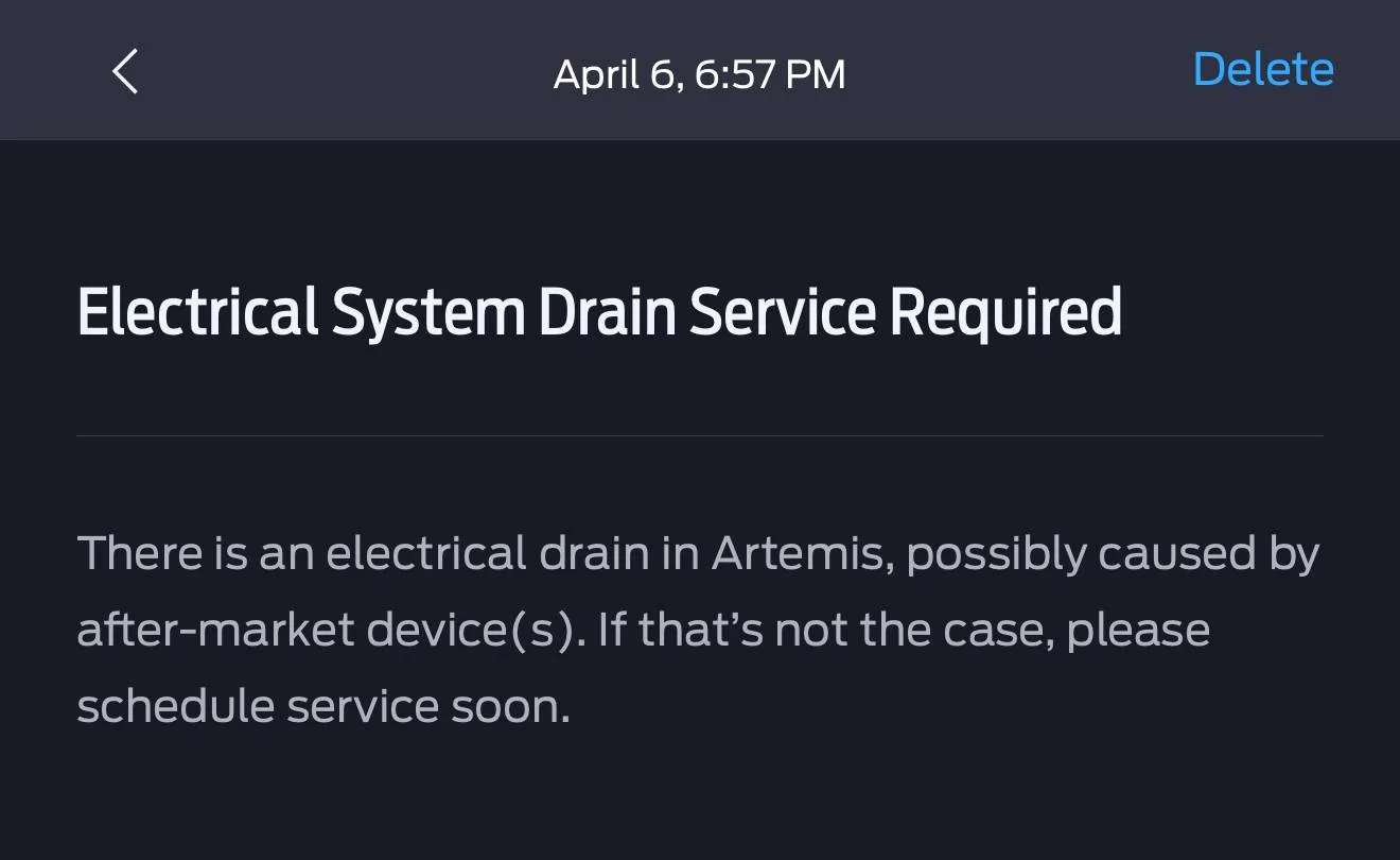

Well…. The saga continues
Ford Mustang Mach-E The stranded saga continues IMG_1638
there are no after market devices installed, to be clear

Sorry you've had to go through all of this. One thing you said about not having issues parking at work, but having them when parked at home made me wonder how close to your house you park the car... I wonder if the proximity of one or more of your fobs is causing it to consume more 12v accessory juice at home. That doesn't explain why it doesn't get recharged, etc, but maybe start dropping your key fobs in a cookie tin at home?

Ok, so it sounds like it’s not the easy stuff.
Have you looked under the cover to see if there are any chewed wires? Sounds like it could be a rodent problem.

2021 MME4x Prem
