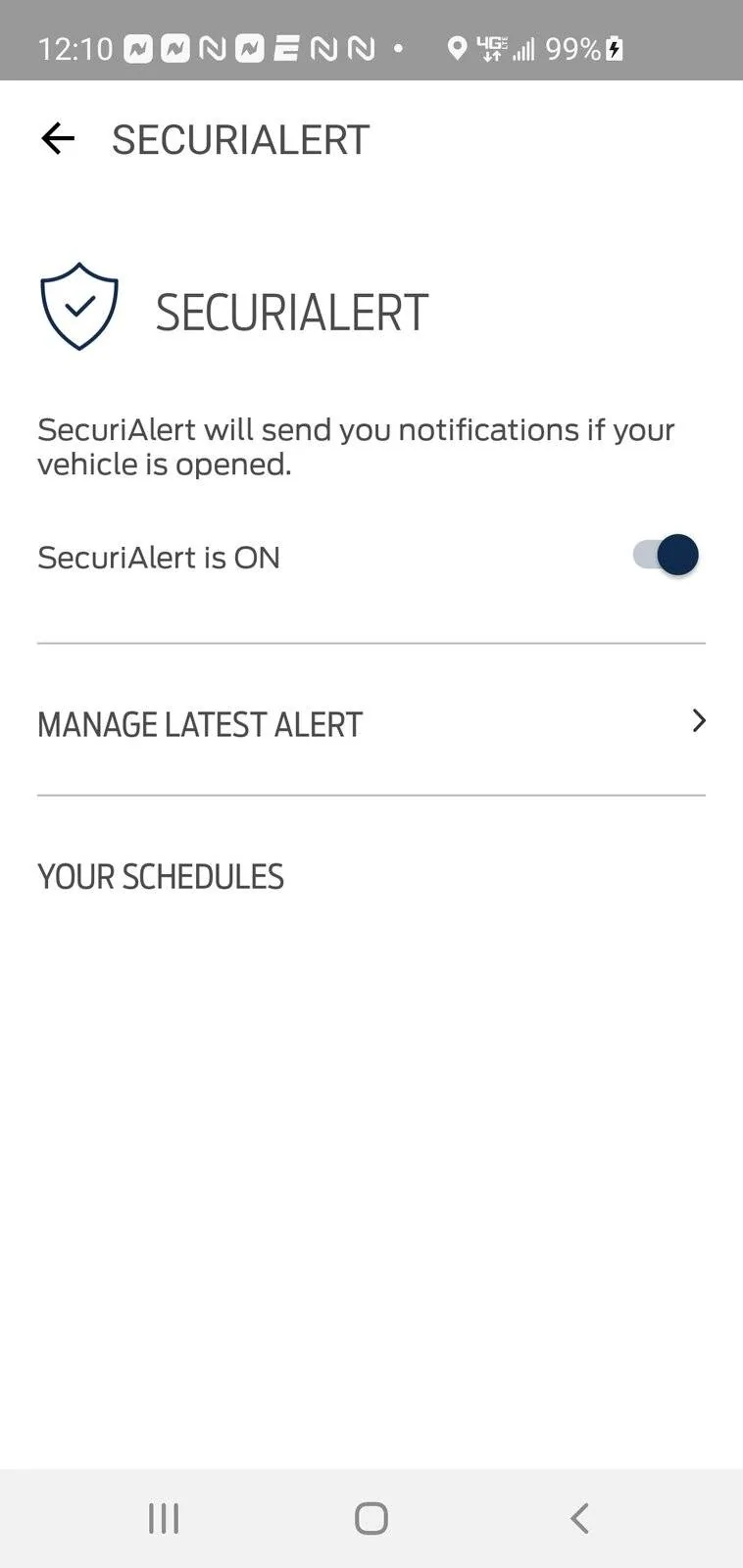

Mine says it will send an alert when a door is opened. I presume with or without the fob?

Just older MMEs have SecureAlert?
Yes the newer ones don't have SecureAlert. Not sure why. I think it was just a 1.4 thing.
Well if it's with a FOB do you get an alert every time a door is opened during the schedule? I don't have it so I can't test it.
Yeah. I kept getting alerts and it was fairly annoying so I keep it turned off except when I leave it in an unfamiliar area.
Learned something else only for a feature that I don't have ... thanks!
I think they might have gotten rid of it for now because I've seen nothing but complaints about it being too sensitive.
