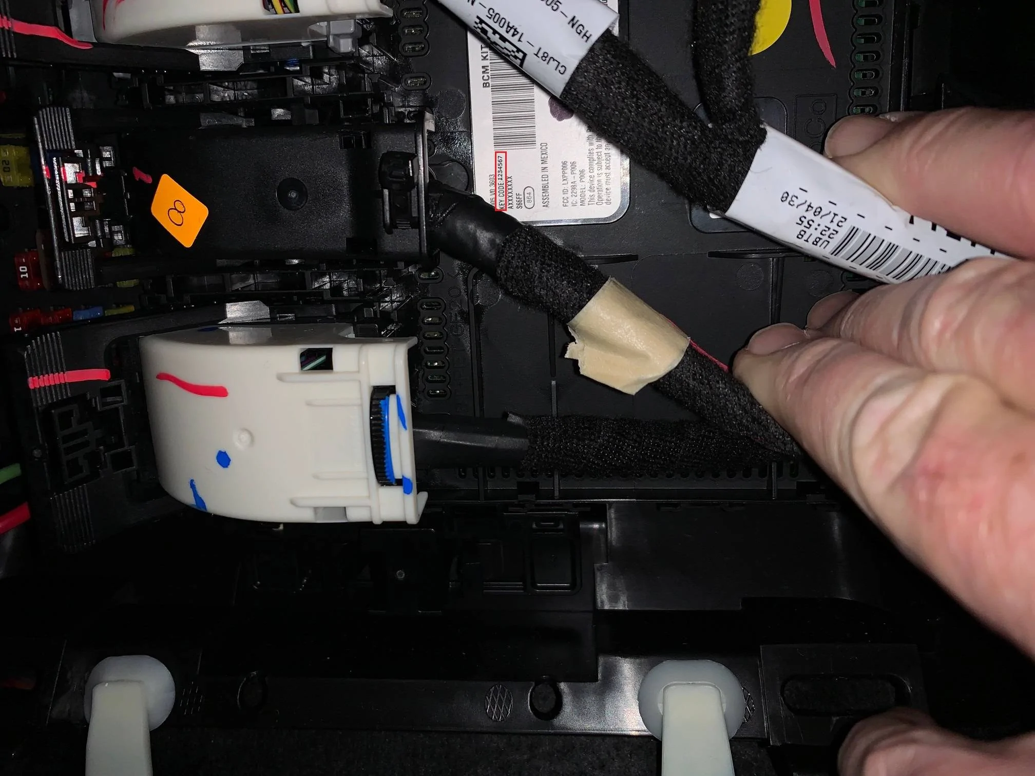

Passenger side footwell. Pull up and back on the panel on the floor to reveal the BCM module with the code printed on the sticker (red box) . In the US only 5 of the 7 digits are used. In other locales all 7 numbers are used as the door code.

You cannot change the factory door code without replacing the BCM. You can only add your own number.
