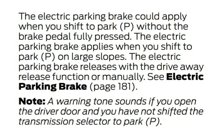

So I know it's off track, but since there were a bunch of posts on this. Is it put the car in park and then apply the parking brake. Or vice versa?
I have a steep driveway, which is why I'm asking. Also, I have yet to determine when the parking brake comes on automatically...

Before or after shifting to park doesn't really matter. The main thing is to apply the park brake prior to releasing the service brakes.
If you figure out the criteria for automatic application let us know. ?

Found this on page 172 of the manual.
Ford Mustang Mach-E MY22 Changes? Screenshot_20210817-184636_Driv
