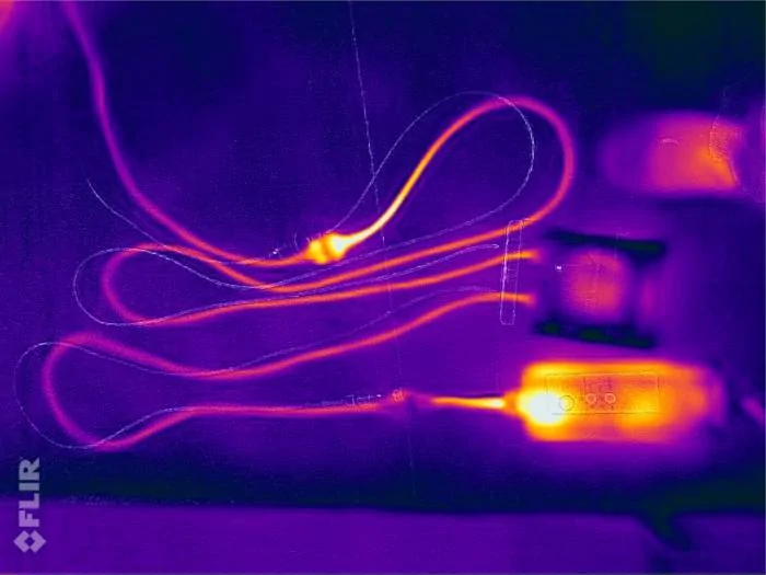

Can you explain that? I would think the the connection to the liquid cooled cable would act more like a heat sink than a source of additional heat.
The end connected to the Supercharger cable would get some cooling from the Supercharger side, yes. But the other end would not. If you take a look at this thermal image, you can see the cable next to the plug and socket connection is warmer. Connections are warmer because they usually have increased resistance compared to the cable itself. So in that case the cable is acting as a heat sink for the plug connection. The average heat dissipation per inch of cable is higher near the connection.
I hadn't realized that until I started researching a little, but it makes sense that the liquid cooling is more about the connector than the cable itself. Weakest spot, and also where we have to grip it. Don't want the handle getting uncomfortably hot.

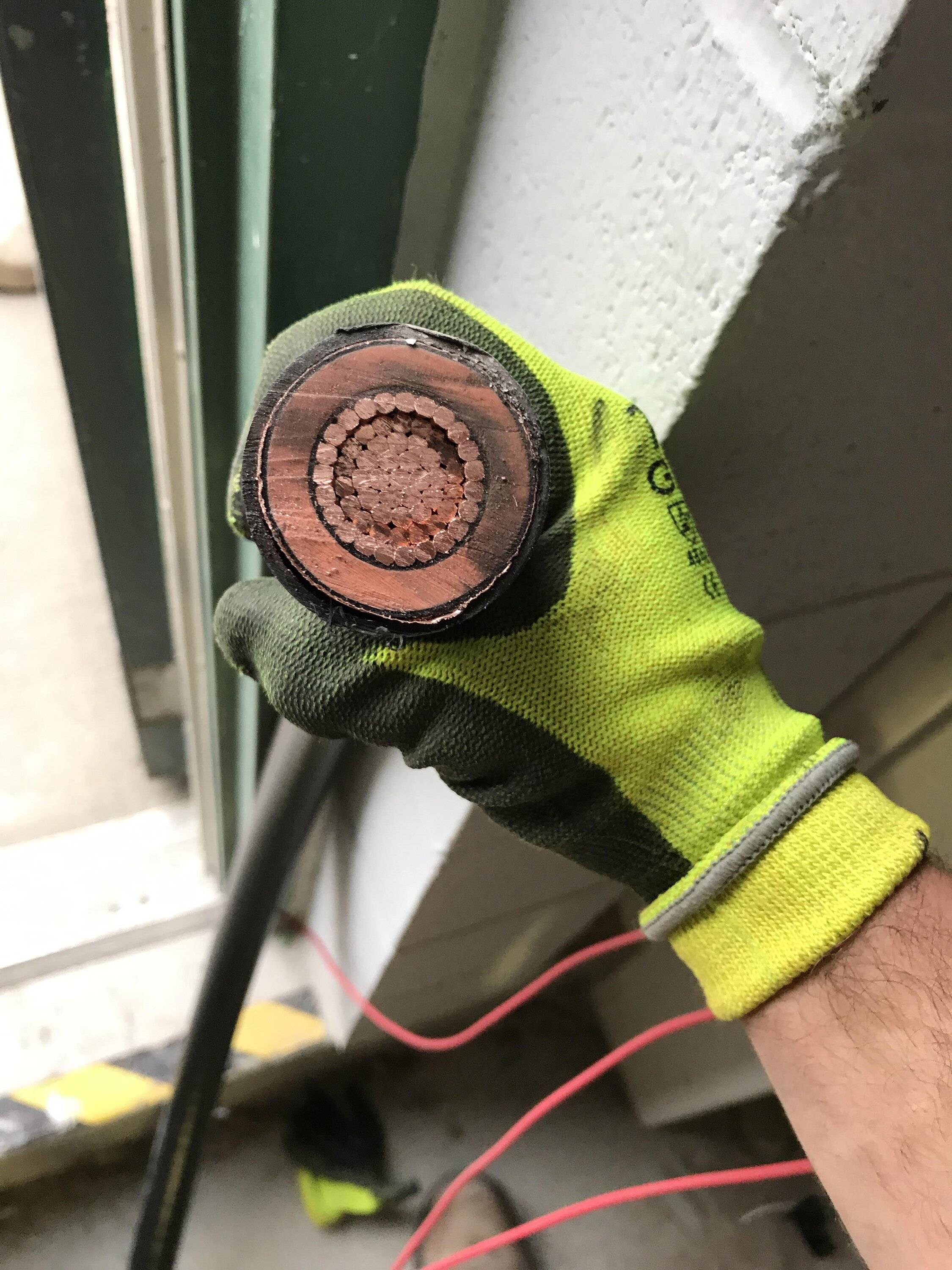

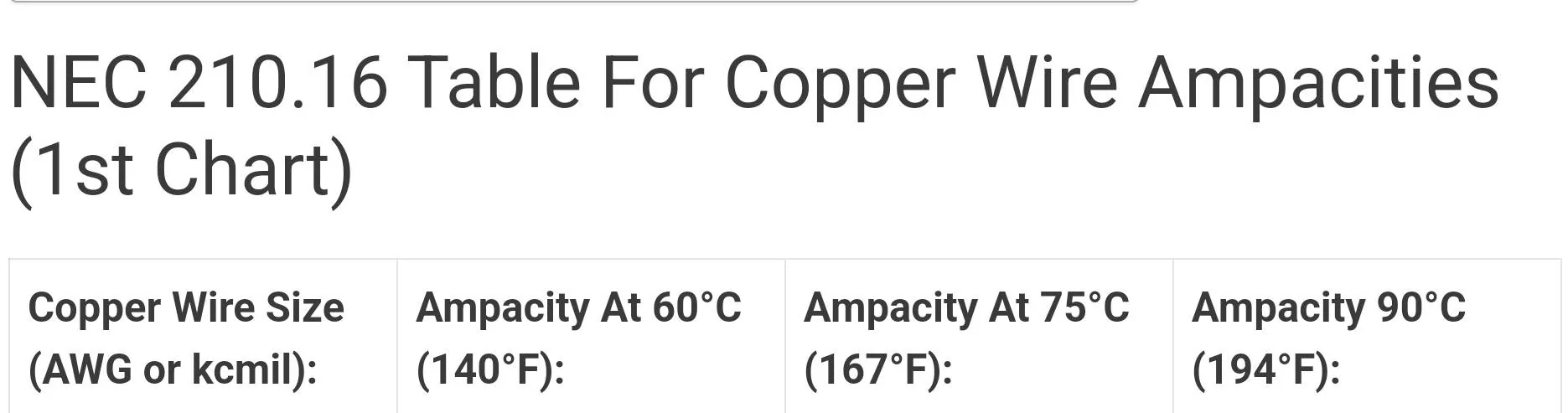

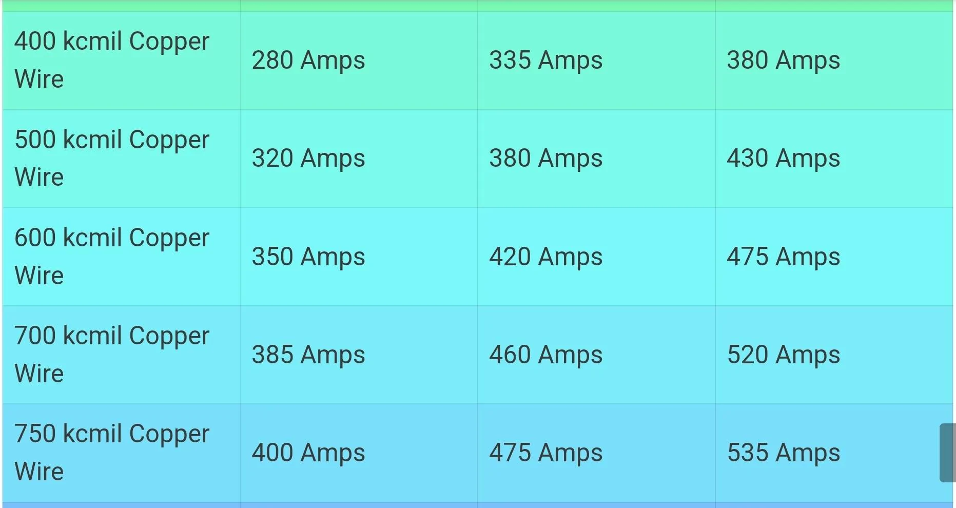

Some interesting information:
Ford Mustang Mach-E NACS Extension Cable Coming From Tesla 1000009116
Ford Mustang Mach-E NACS Extension Cable Coming From Tesla 1000009118
750 kcmil wire:
Ford Mustang Mach-E NACS Extension Cable Coming From Tesla 1000009119
