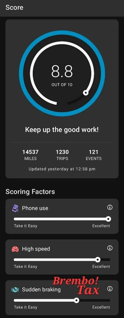

I live in tropical hell this time of year. If I walk out to the car and spot rusty rotors, I grin.
I know exactly how to shine those big gorgeous rotors with those big gorgeous Brembo buffers. ?
Admittedly, the Mach-E has dropped my score in the smartphone insurance nanny-app. I was sporting a nice A- 93 (out of 100) until I got the GTPE. Now I'm a B+. But if that's all them Brembos and Continentals and 1000+AMPs are going to cost me?

By doing a hard brake that exceeds the max slowing capability of regen and forces the friction brakes to kick it for additional slowing.
I always brake very slowly when driving in two pedal and the rust is still removed from the rotors. Is there a setting that I need to enable to use regen when in two pedal?
