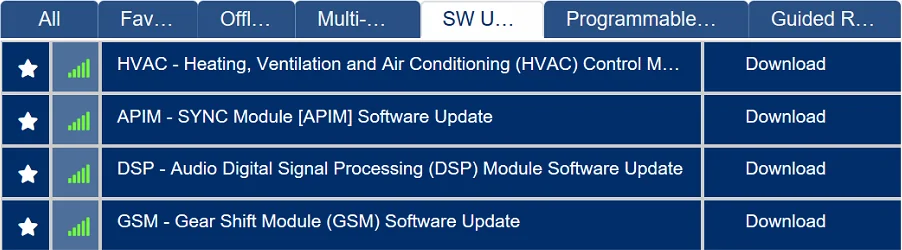

It looks like your dealer has been applying updates all morning, as well as running some configuration routines, but your car still has a few outstanding updates availalbe.
Thanks for this update!! Are those additional updates needed before completing the 21G01 programming? The service employee called me this morning with an update saying that it was updating for 9 hours yesterday. She said the technician ran into an issue this morning. She said crash alerts keep popping up and that the Blue Cruise icon disappeared. She said they are on the phone with Ford engineers to troubleshoot. Hmmmmmm.
The APIM update is definitely part of it.

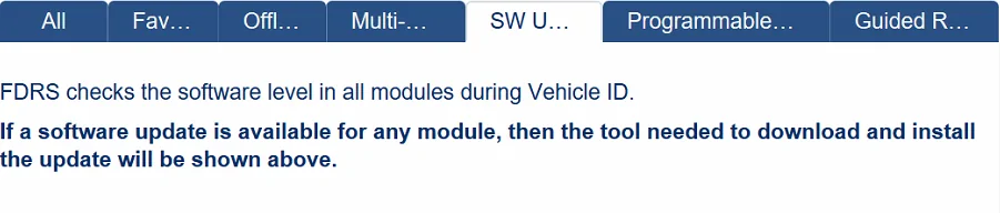

FWIW, here's another data point (FE, Build date 12/20). I did the hours long FDRS update March 14, before the detailed instructions of 21G01, just followed the FDRS instructions, no problems. It did take hours.
I show no more updates on FDRS, Sync Ver. 358 (understand I need to get to 364). Intelligent cruise control option is gone now too (no loss until someday they add % over instead of MPH over, I don't like it, I dont' use it).
There is no bluecruise/hands free under my connected services, and I received no email.
I had OTA turned off, which might have delayed my VIN (or not). OTA with schedule is turned on. Last time I had OTA turned off, FordPass complained that I had a pending update, so maybe not the problem. Maybe they are just not to VIN on some list yet.
The thing says "bluecruise" all over the place now, but no "hands free" anywhere yet (I did the APIM FDRS reset twice, now that I have read 21G01)
I think lane hold is now far less available than it used to be. I play with it often, and used to get the blue bubble pretty easy, even on many local roads. Now the blue bubble comes on slowly and infrequently. The system does watch and warn me if it thinks I am not viewing the road, so some hands off functionality is part way there.
I think (?) nothing is hung, and I am just waiting for my VIN number to come up in the Ford system to finish the update cycle (?). I check FDRS everyday. It shows no updates, so I guess I have no way to get to Sync 364 until they give me that APIM update on my FDRS SW Update page.
