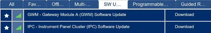

Hope you don't mind but I'm gonna DM you my VIN and see what's up before I head into service, again, next week. the dealer on the last service said they still had 2 module updates left, but I took that with a grain of salt.
Not a problem!
Looks like you only have an IPC and GWM update available
Ford Mustang Mach-E Optional Product Improvement Program 21G01 - BlueCruise Programming Screen Shot 2022-04-08 at 2.00.07 PM

Wow, so the dealer was on the up and up this time. :)
and THANKS!
Not a problem!

I'll mention it, thanks. Considering there were about 14 updates to do last time it was in it's nice to have some progress, especially after 3 days at the dealer.
I would not be surprised if the GWM update triggers a bunch of others. They should do the GWM first.
