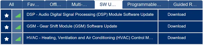

@bigdatabigdata
It doesn't look like you have any updates pertaining to BlueCruise specifically (aside from the GSM, but It might be tangentially related), but there are still a few updates available
Ford Mustang Mach-E Optional Product Improvement Program 21G01 - BlueCruise Programming Screen Shot 2022-04-08 at 12.19.46 PM
However, your car seems to be in roughly the same spot as mine. Stuck on SYNC 358

Very helpful! Thanks for the help. Hoping something happens OTA that gets us off of 358. My dealership folks (as nice as they are) were somewhat new to this it seems.
Dan
@bigdatabigdata

@bigdatabigdata
Mine is pretty much in the same place (been doing my own FDRS since last year). The question is are we "stuck" because something is not right? Or, are we just waiting for our VIN to be eligible for the last update that gets us to Sync Ver. 364 (an APIM update)?
As in your list (although I do almost all updates, so my list is clear now), there is no new APIM to update Sync from Ver. 358 to 364 yet.

That's exactly what I'm wondering - if the final update is not available to us yet since the VIN list hasn't cleared through whatever control point FDRS uses to authorize the updates.
