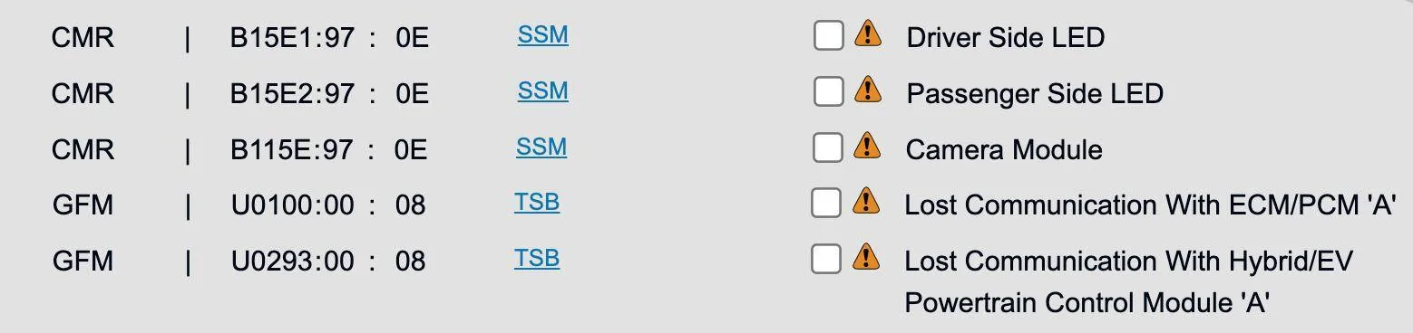

I'm seeing this exact pattern of codes in vehicles that are fully updated but still don't have BlueCruise FWIW. Performing the SSM steps doesn't seem to work either.
I‘m seeing those in my car too even with BlueCruise working fine. They can all be cleared, but they’re there again the next time I look for them.
