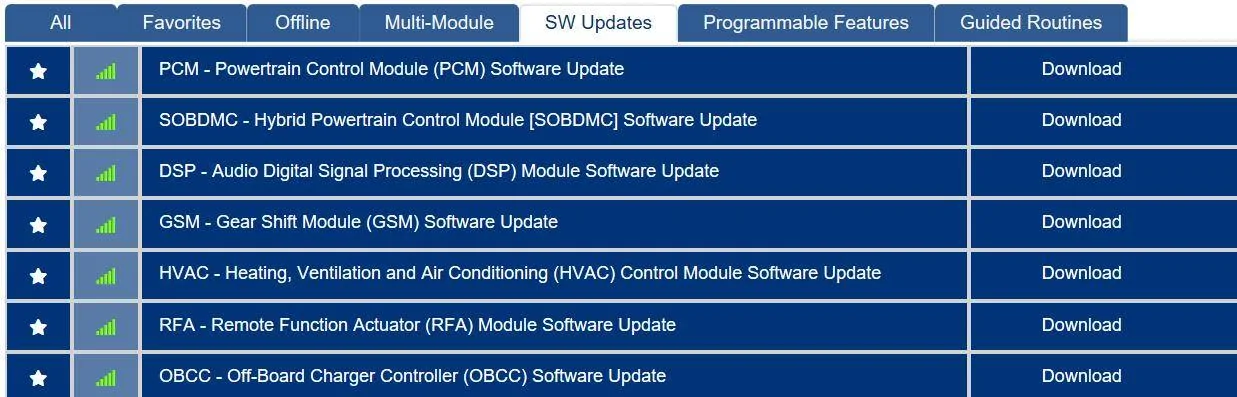

Some of the modules have multiple applications, so have more than one strategy listed. It seems FDRS picks one for display in the module part numbers list. If you select a module in the list and look below the list, the DIDs (PIDs) for the module are displayed.
On my MME the IPMA or ADAS module has these part numbers as strategies. It was updated with Power-Up 2.5.1
Strategy [F188] ML3T-14H102-ABS
Strategy [F120] ML3T-14H102-MDM
Strategy [F121] NL1T-14H102-SBD
Strategy [F122] ML3T-14H102-GAP
Assembly [DA01] LJ8T-14G647-FT
As you can see both -MDM and -GAP are in the list.
The current module revisions for my RWD ER MME.
CMR
Strategy [F188] ML3T-3G604-XH
Strategy [F120] ML3T-3G604-MD
Assembly [DA01] LJ8T-3G590-XH
IPC
Strategy [F188] LU5T-10F906-AA
Strategy [F120] LU5T-10F906-BA
Assembly [DA01] DSLJ8T-1A292-AK
TCU
Strategy [F188] MU5T-14H085-DG
Strategy [F120] MU5T-14H090-ADG
Strategy [F121] MU5T-14H090-BAY
Boot Image [D027] MU5T-14H241-DG
Boot Image [8068] MU5T-14H240-DG
Assembly [DA01] DSMU5T-14H074-AAX
APIM
Strategy [F188] MU5T-14G676-EJ
Strategy [F0E9] LJ8T-044R30-AC
Image [8033] MU5T-14G682-JT
Boot Image [D027] MU5T-14H234-BD
Boot Image [8068] MU5T-14H236-LA
Assembly [DA01] DSMU5T-14G670-EJ
If you want to fully verify your modules are updated, this is the way

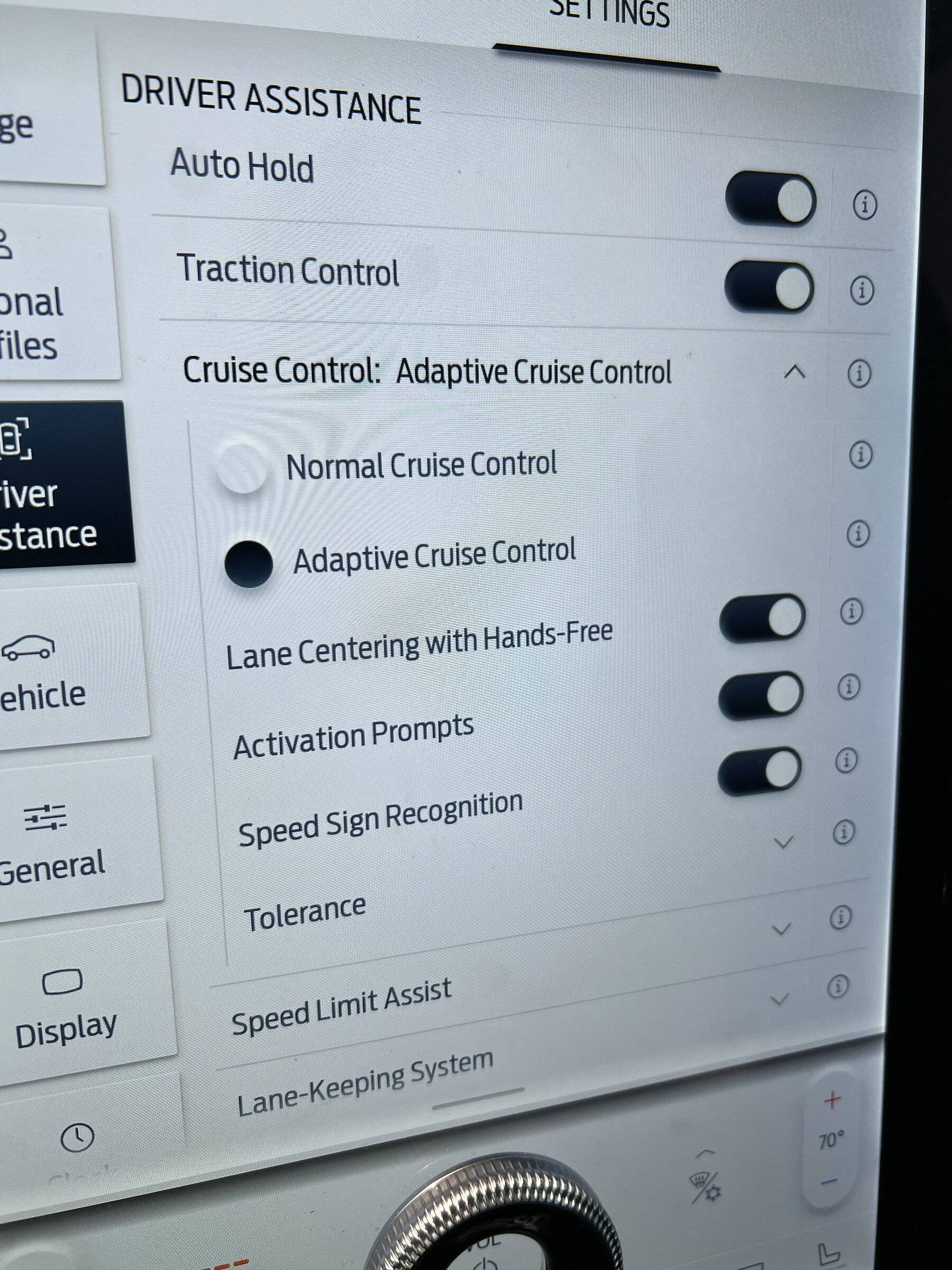

Just went and got the car. General manager just happened to be there and overheard the same service guy we spoke to yesterday get condescending with us again today. As we were walking out the GM stopped us and talked to us. He wasn’t happy with the way he talked to us.
They never got blue cruise to work or “blue drive” as they kept calling it. ?
I do have SYNC 364
I can tell something’s are different.
Lane Centering is better
