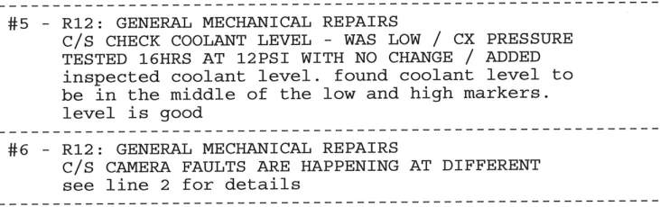

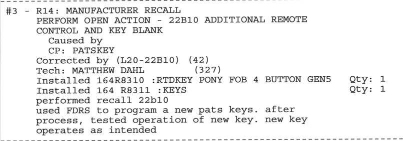

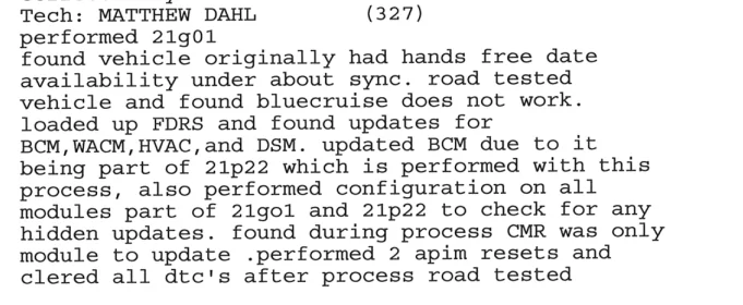

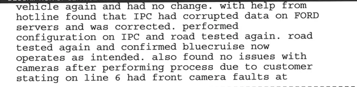

Adding some info here in case it helps anyone else with same scenario.
History.
4-11-22 thru 4-13-22: Dealer attempted 21G01 BCHF software install. Unsuccessful.
5-16-22 PowerUp 2.6.0 OTA successful
5-31-22 PowerUp 2.8.2 OTA successful
6-1-22 PowerUp 2.8.3 OTA successful according to SYNC yet BCHF still didn't work.
8-2-22 22S41 HVBJB recall OTA successful
8-8-22: Dealer's second attempt at 21G01. Successful.
Here are the notes.
Ford Mustang Mach-E Optional Product Improvement Program 21G01 - BlueCruise Programming 1660063425338
Ford Mustang Mach-E Optional Product Improvement Program 21G01 - BlueCruise Programming 1660063449992
Ford Mustang Mach-E Optional Product Improvement Program 21G01 - BlueCruise Programming 1660063475040
Ford Mustang Mach-E Optional Product Improvement Program 21G01 - BlueCruise Programming 1660063563739
Ford Mustang Mach-E Optional Product Improvement Program 21G01 - BlueCruise Programming 1660063586291
Ford Mustang Mach-E Optional Product Improvement Program 21G01 - BlueCruise Programming 1660063636836

Aha, it was another missing IPC update due to corrupted server data. That seems to have been the fix for several "stubborn" vehicles where everything shows updated but it still doesn't work. @mpshizzle this was the same problem you had too?

Hmm. I may have spoken too soon.
  • Ford Motor Company is offering a refund for owner-paid repairs covered by this program if the repair was performed before the date of the Owner Notification Letter. This refund offer expires on February 5, 2023. Refunds will only be provided to the owner plus applicable tax, in lieu of providing additional remote control and key blank.
It says nothing about who you purchased the fob from but since the dealership provided you with a new one, it would not be in lieu of providing another one. They have probably already claimed reimbursement for the new one they gave you.
Details are in the attached pdf:

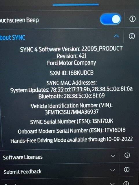

I am a Job 1 Car. I was just on a 4 hour trip today on a major highway in PA Interstate 81 it said BC was available, but it never engaged in handsfree only hands on the wheel. When I would look away it would beep to say look forward, so the eye detectors worked but I was not able to take my hands off the wheel. Is there a way to update the Bluecruise it says handsfree expired 2 days ago despite not having it for a full year? I just got it in May or June of this year. It worked for a month or 2 now it wont go in handsfree mode.
I'm almost certain that's the American way of displaying October 9th. But even still that would be September 10th. And either way that's just when the maps "expire" not the feature
