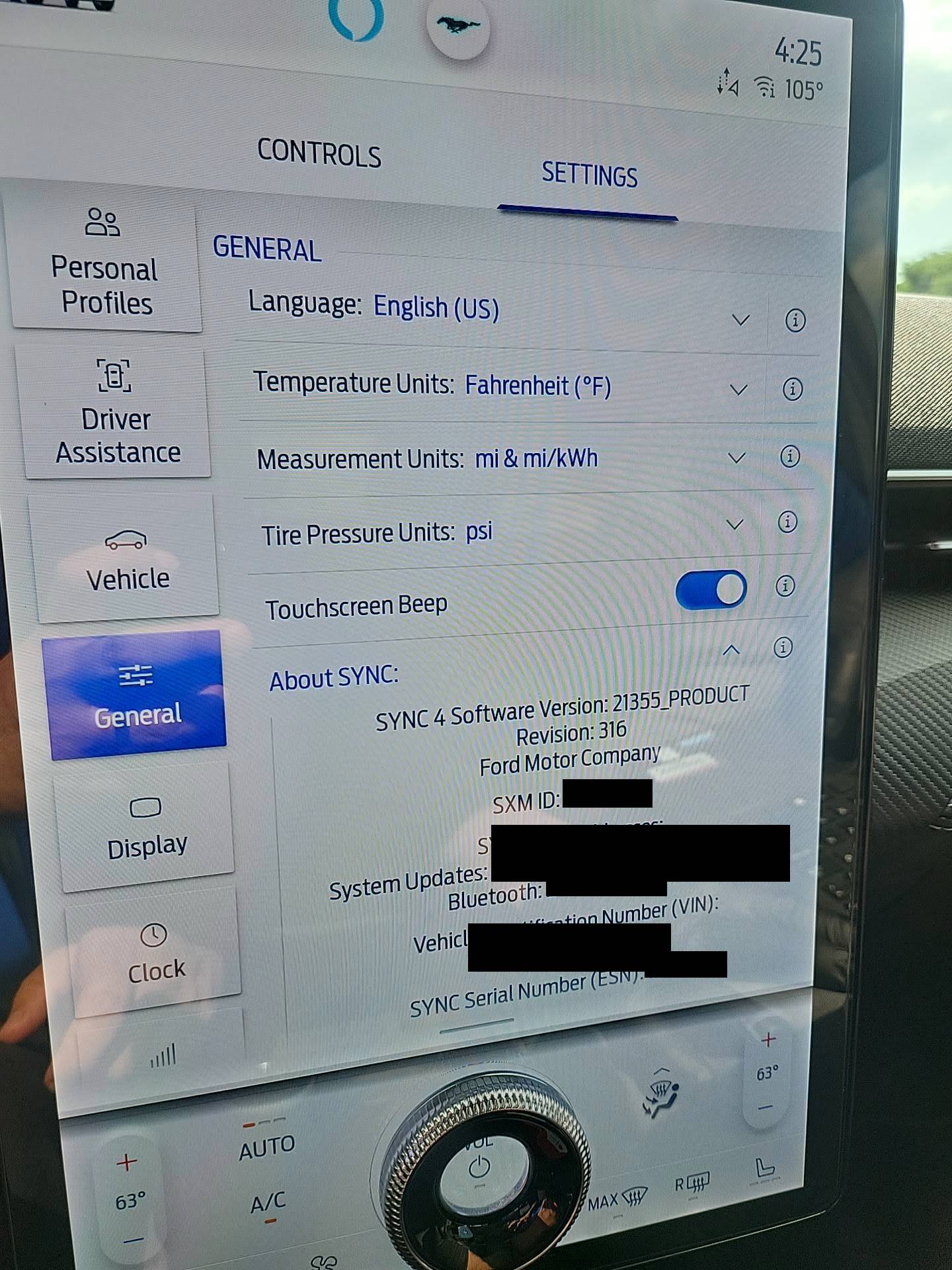

My MME is at my dealer for the module updates, which were not done before they sold me the vehicle. I provided them with hard copies of both pdfs from the first page of this thread.
I just got a text saying the work is done, but the photos show SYNC was not updated because it's still on Revision 316 and the FDRS "FD1 - CMR" and "MS1 - DSM" labels are orange ("CMDTCs detected"). I asked why SYNC wasn't updated, and the dealer said they are sending a message to the help desk to see what they say.
Is there any other info I can provide to the dealer to help with this programming? Or am I just stuck waiting for OTA updates?
Thank you.
