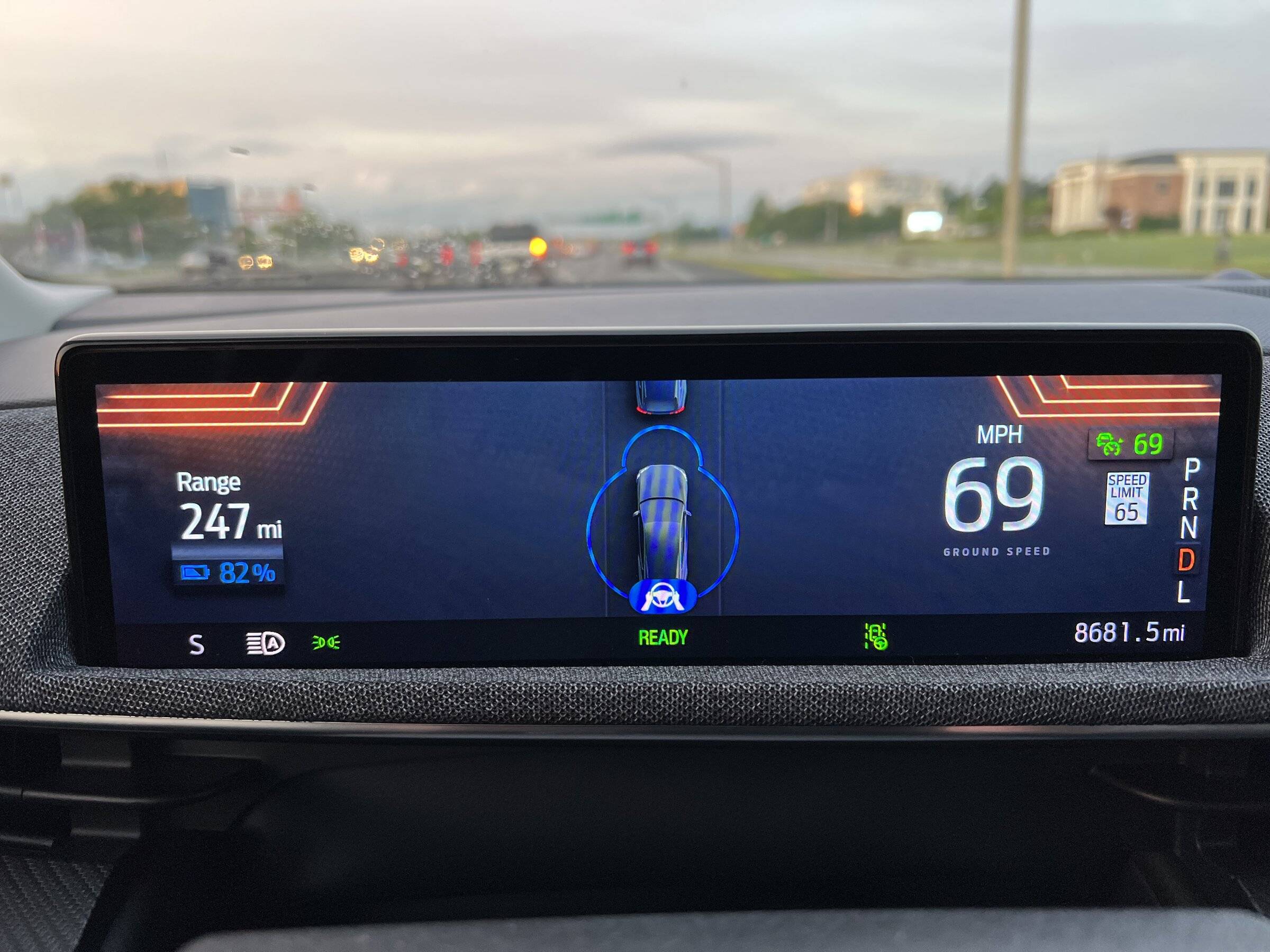

Looks like you're all set with the big stuff.
What about the small details? You need to turn on cruise control AND lane centering via the steering wheel controls, and be on a relatively straightaway portion of I-10.
Is there a way you can safely take a photo of your instrument cluster while you're on I-10? It will be helpful to know the color of the lane keeping system icon (bottom row, between the odometer and the READY message).

Ok, this all looks correct, too. The green lane keep icon indicates that the lane keep system is enabled and it is tracking the lane markers and you are properly between them.
The markers around the large/centered car visualization are indicating you have adaptive cruise control enabled with lane centering enabled and currently functioning.
Your set speed is well within hands-free limits. Your roadway is plenty straight enough. You're not in an exit/on ramp or interchange. Your earlier post shows hands-free mode is set up.
... I have no idea why you're not getting hands-free... You may need to bring it back to the dealer, sadly. :(

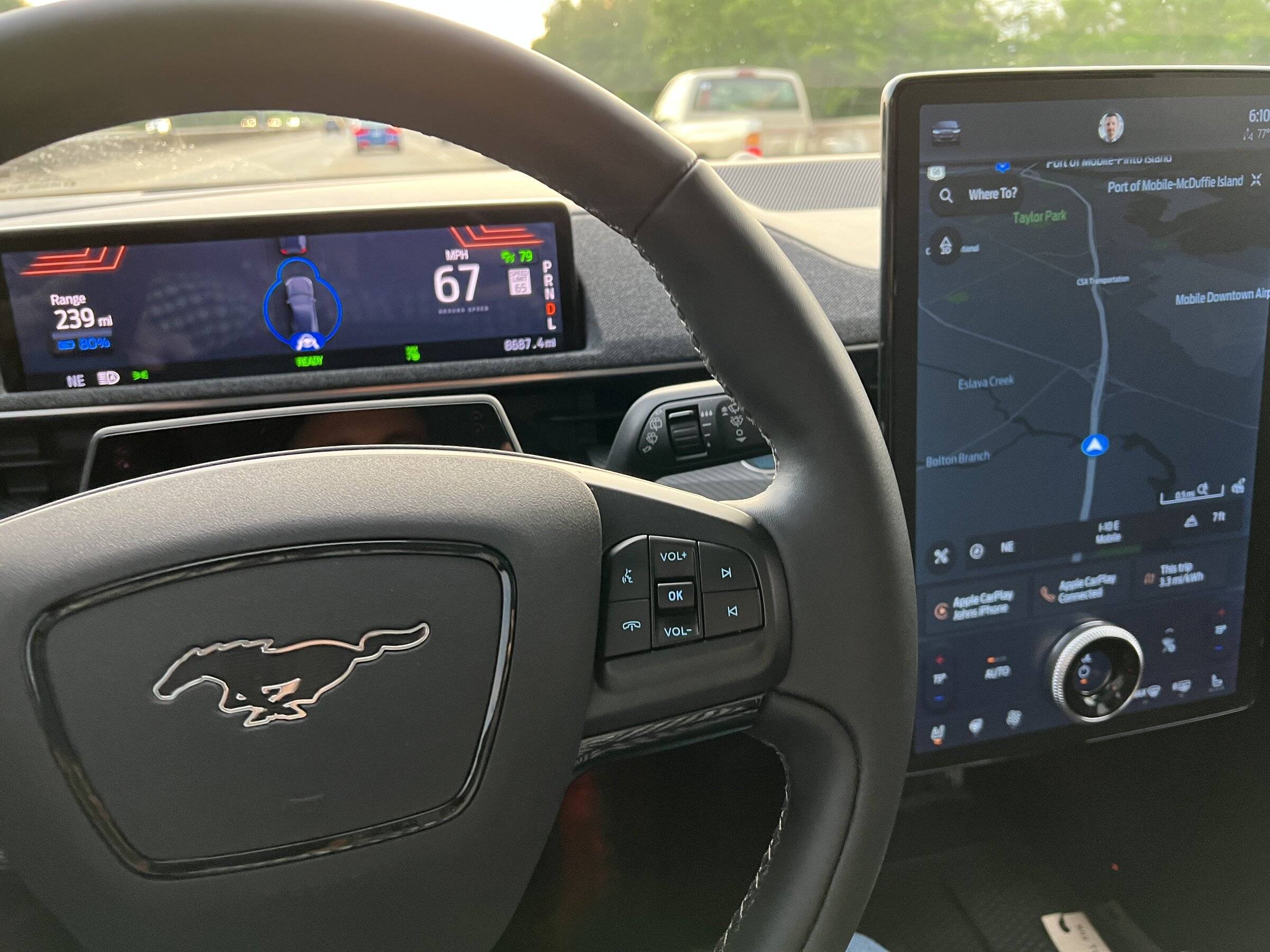

Alright everyone help me out. Spent a few days at the dealer. Got all the updates completed. Today I got the “Bluecruise” available message in the app and I thought it was ready. Tested on I10 today and there is no option to use, no icons, nothing. Attached picture of everything in place. What am I missing
Sorry if obvious, but are you sure this is an approved BlueCruise road? It sounds like you should have all you need.
It is, there are other Mach E's in the area that use the same paths and theirs work but they were "beta" testers.

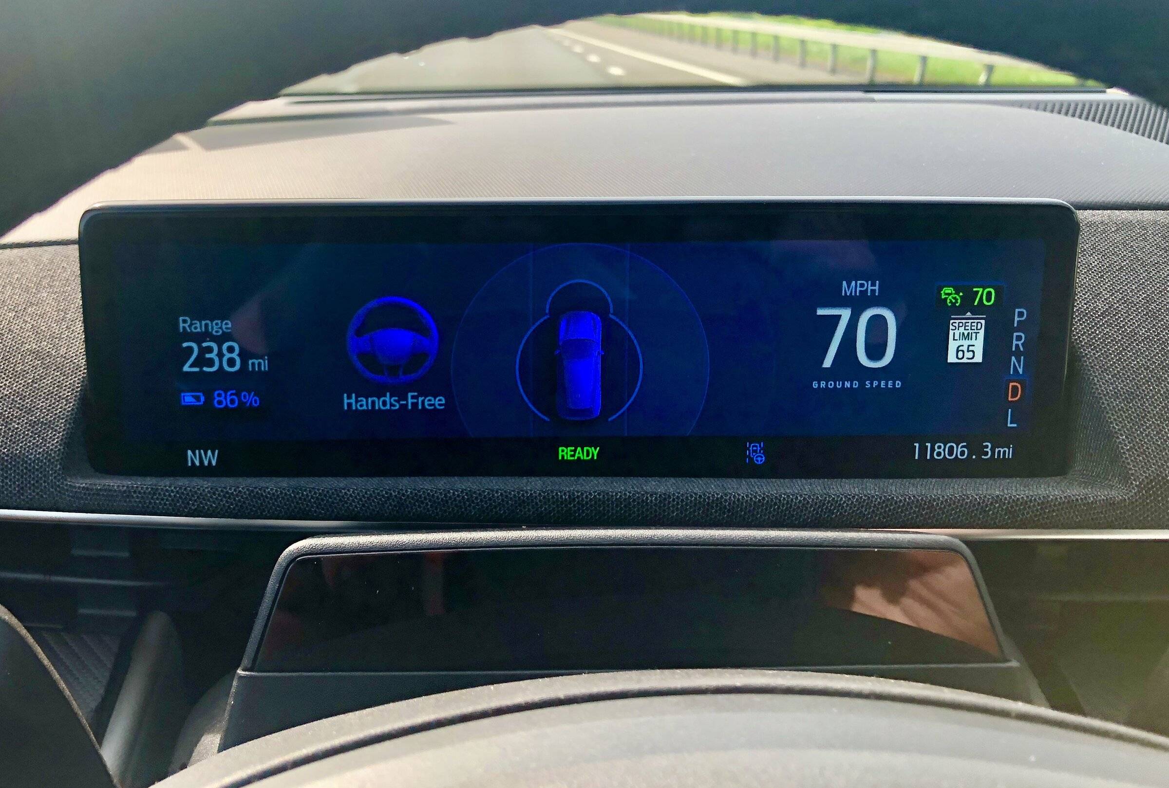

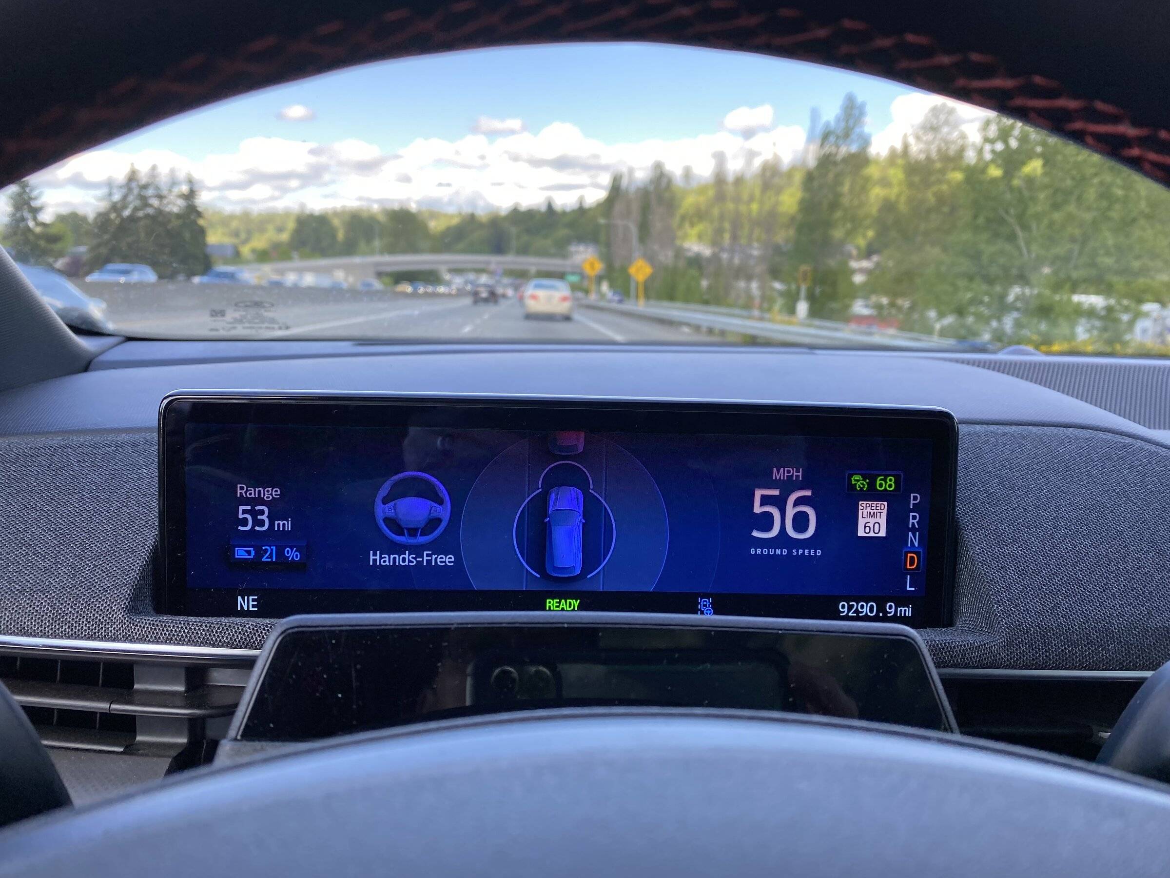

Ford Mustang Mach-E Optional Product Improvement Program 21G01 - BlueCruise Programming IMG_5378
Third what?
*Third week+ long visit to the dealer for a total of over a month. The next MME that goes to that dealer for BC should be in and out in 2 days.

Got this email from the Service Manager today...
Mr. Thomas -- All the
programing was successful,
our tech took a short road
test & utilized the BlueCruise
system - it is working as it
was designed.
It took a Ford Field Engineer working with Ford Engineering in Dearborn a full day's work yesterday to get it from a stuck 1.7.1 status to BlueCruise. I can only guess the dealership's one EV certified tech did get something accomplished during the previous days before the Field Engineer got involved, too.
Will pick it up later today. Want to thank @generaltso for all the VIN checks to see the status of updates through this 25 day ordeal, @louibluey a local Mach-e owner who offered to do the updates but I deferred determined my dealership do it (dammit!) and a person with connections to Ford who stepped in to get this thing done!
Maybe what they learned from my Mach-e with an early March, 2021 build date, will help others get unstuck and updated to BlueCruise.
