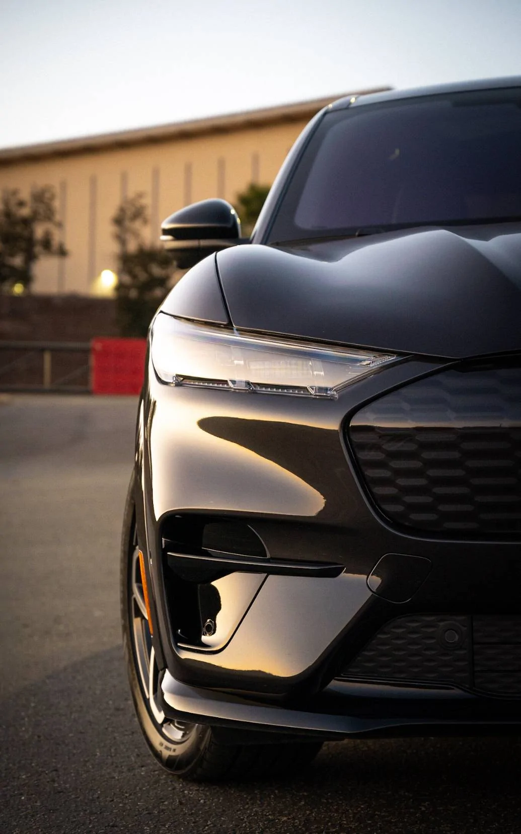

Love your avatar photo! ?
Thanks
Ford Mustang Mach-E PAAK issue.......I did a search too IMG_9074
