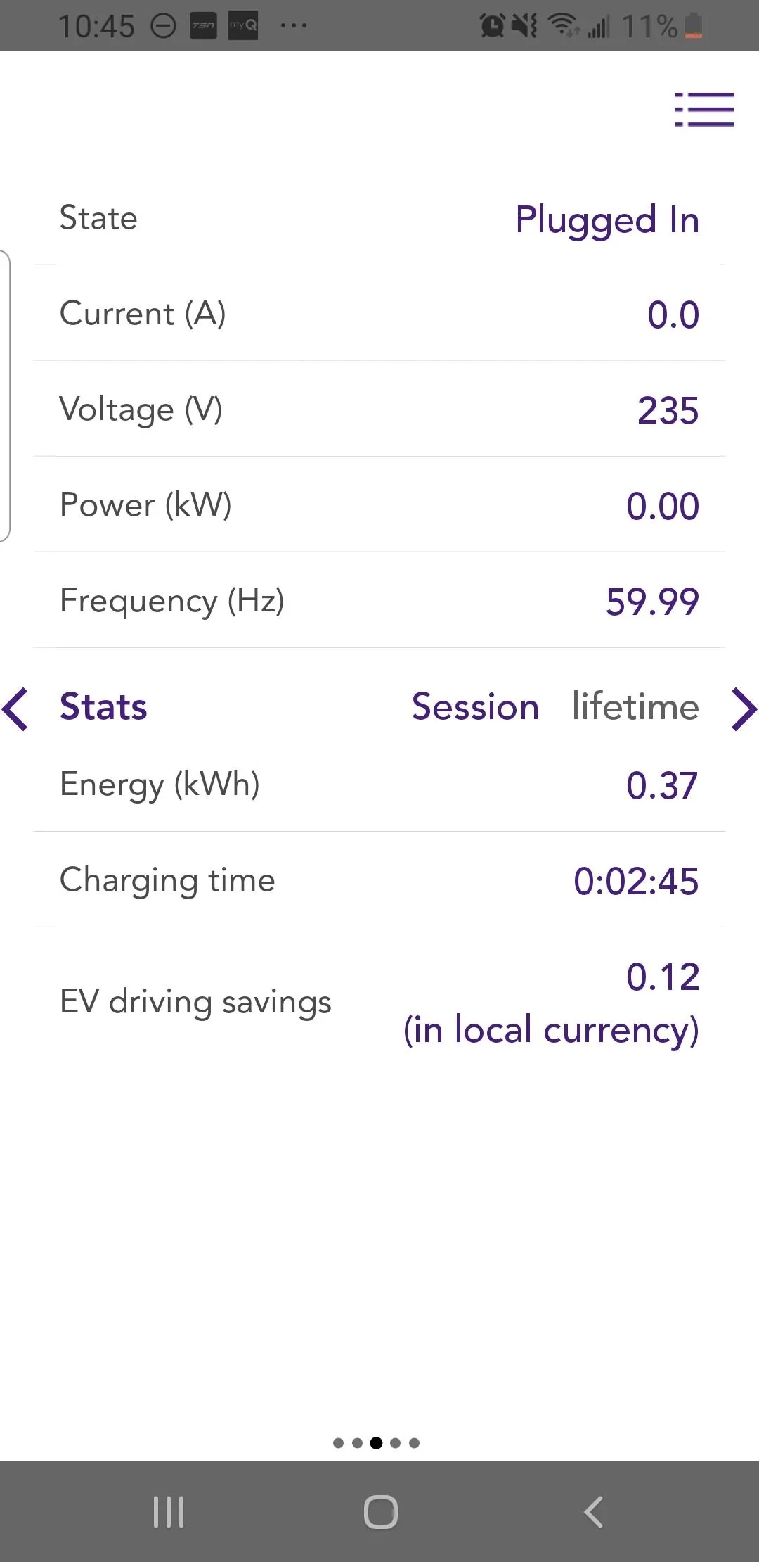

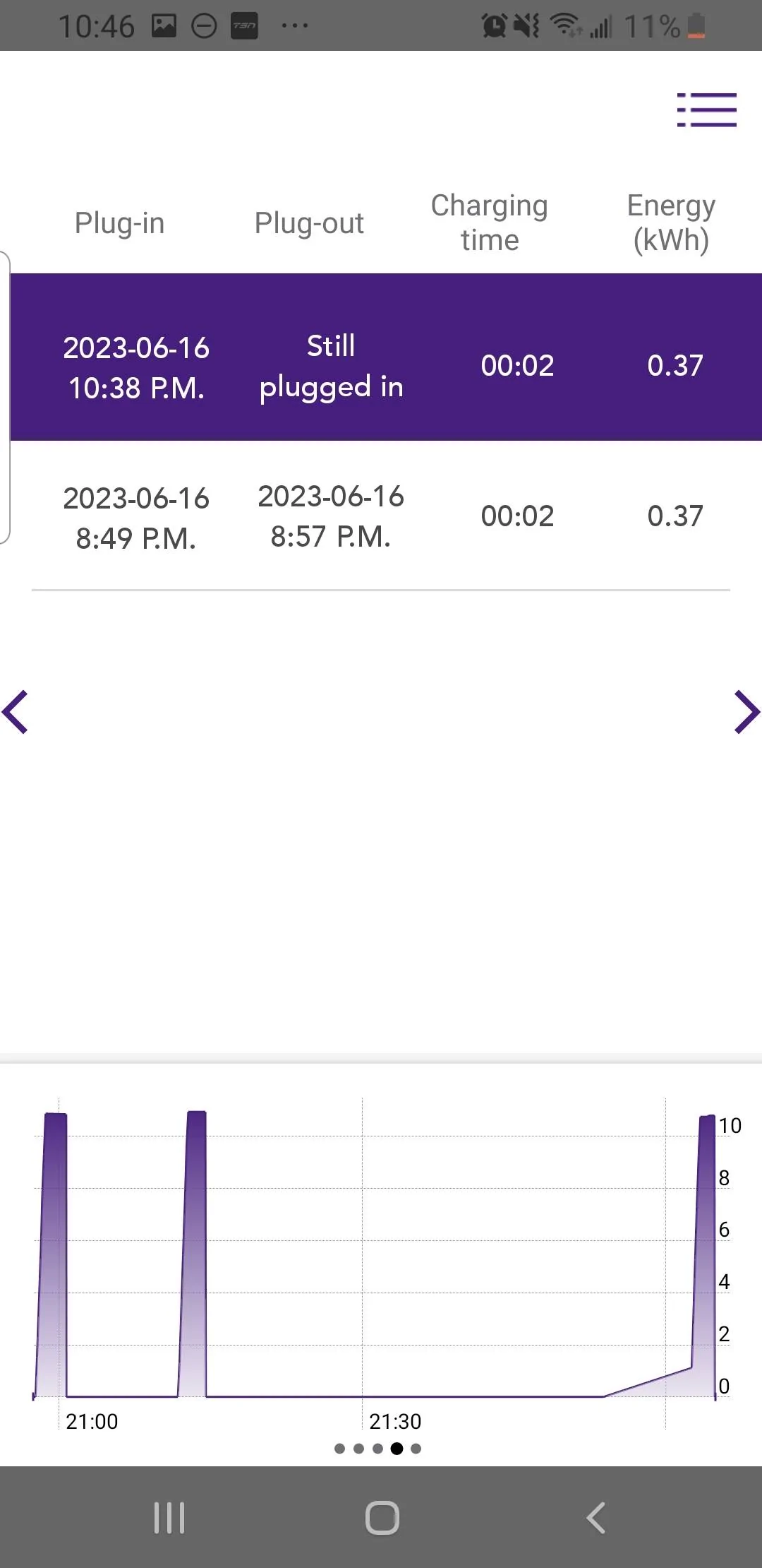

Hi Guys ive been charging lately with the 120v Ford charger since my juicebox died. I received my replacement today, brand new out of the box and I am having the same issues.
I received updates 2 days in a row.
11,436
25,239

The whole unit is brand new. Never happened before. I feel like the last update may have screwed up the charging. There's another thread with regards to chargepoint EVSE. It might be related since they it seems to affect smart EVSE's
Well if the Ford Mobile Charger works just fine but your Juicebox doesn't, then I'd say it's likely you still have a problem with the Juicebox? Can you try charging on another public Level 2 charger to see if that works okay or not?

Ill have to try tomorrow. My ford is plugged on 120 and my EVSE is hardwired so if their is a problem it can bd because of the EVSE but im leaning towards the car. I remember a couple of years ago this happened to Kia's where the EVSE's needed a firmware update to be compatible with the car after the car was updated.

Also note that neither my EVSE or the car are reporting any faults
What update do you think may have caused it? Was the first juicebox really defective? Could be the one they sent is a dud so one more test required at 240V on a different type of charger or try a different vehicle in the chargepoint, both. Can you press charge to 100% and it starts or does it not charge at all on 240V now on two chargepoints?
