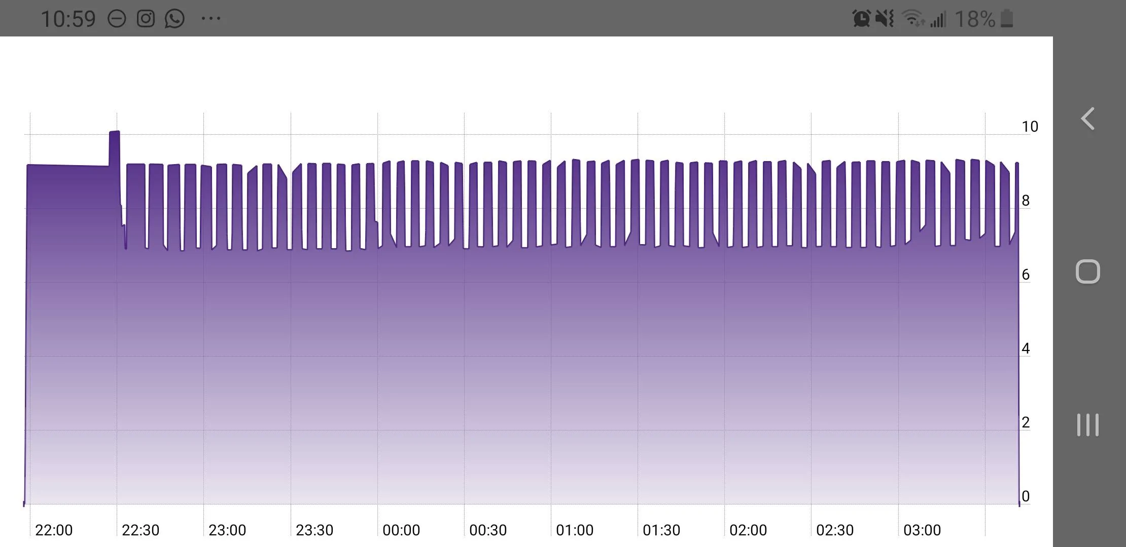

I dont know anymore. I kept it a 40 for an hour and it was fine. Boumped it to 44 it started to fluctuate between 30 and 44 and if i bumped it more it fluctuated between 33 and 48. Could it be a charging curve update that no longer accepts 48 amps at L2? Its going yo be hard to diagnose this since i dont think public L2's are 11.5KW

My last session after bumping it back to 48 after starting at 40, only to bring it back down. I really dont think it's the EVSE. If i leave it at 40 no issue. You can see what happens in the graph.
