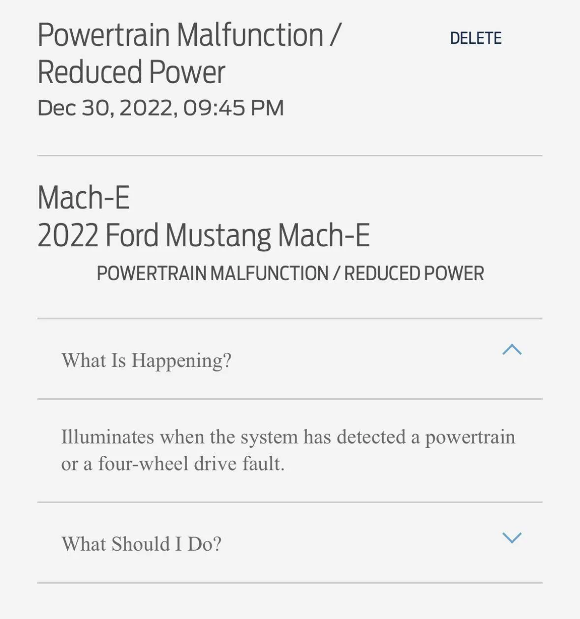

Just had this happen to me while charging at home?!
First a charging fault then I unplugged and started the car and was greeted with “Service vehicle soon”.
Happy New Year to me!
11,587
23,559
The good news is that not every “Service Vehicle Soon” message is related to the HVBJB failure. The bad news is that there are a metric ton of things that could trigger that message. You’ll need to pull the DTC codes to get an idea of what’s going on.
I’ll look at pulling those codes with my ODB link, it went away now - will it still be there?
I never ended up taking in my car. I got this after my first set of power up updates started rolling in… car sat for about an hour. Plugged back in and charged just fine. Haven’t seen the issue since.
mkhuffman
Nov 19, 2020
6,877
9,518
That might be the drive shifter bug that occurs when you try to change the drive mode without pressing the brake pedal. However you said it happened after charging, so maybe not.
I think the code will still be there until it is cleared out. I would not clear it out until you have the dealer check it.
