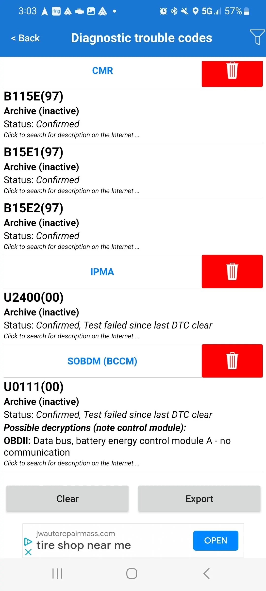

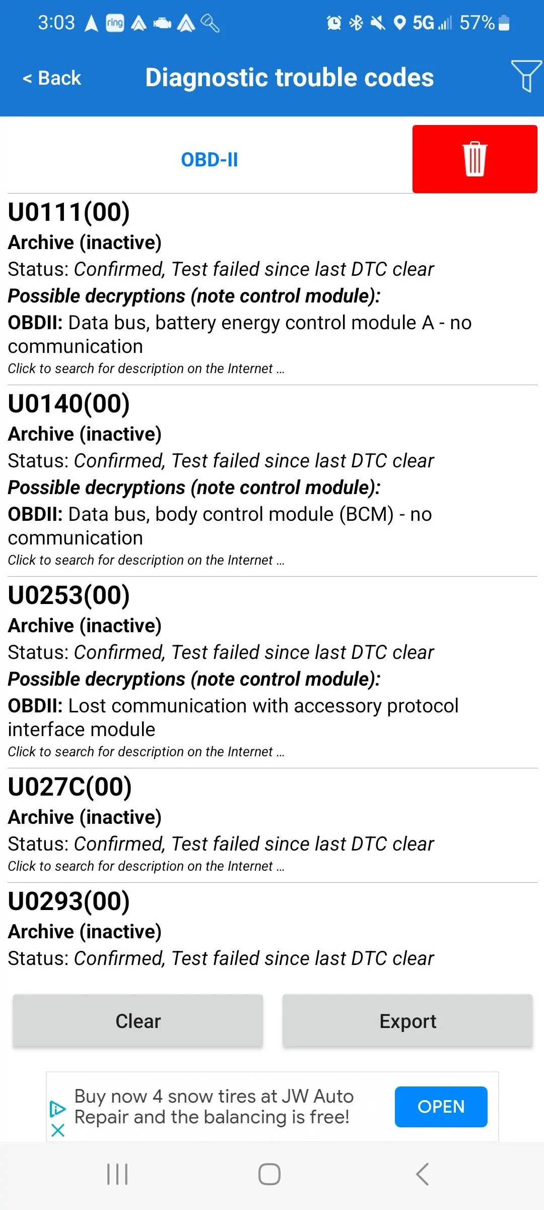

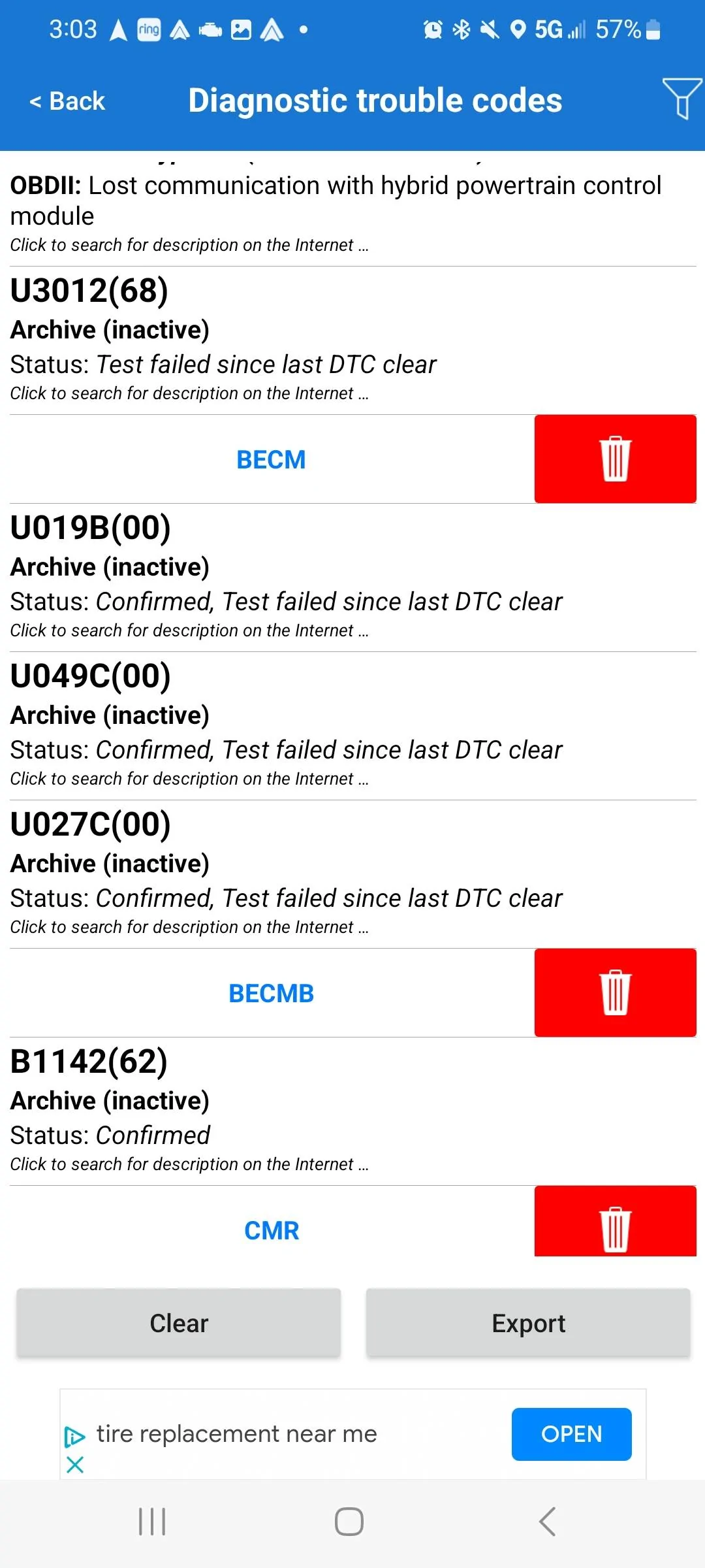

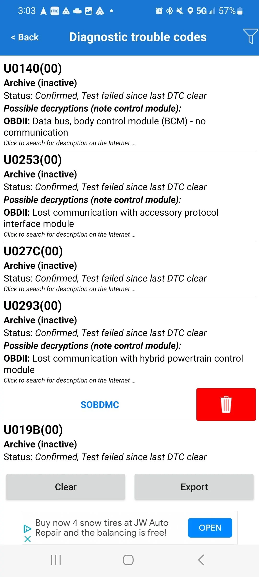

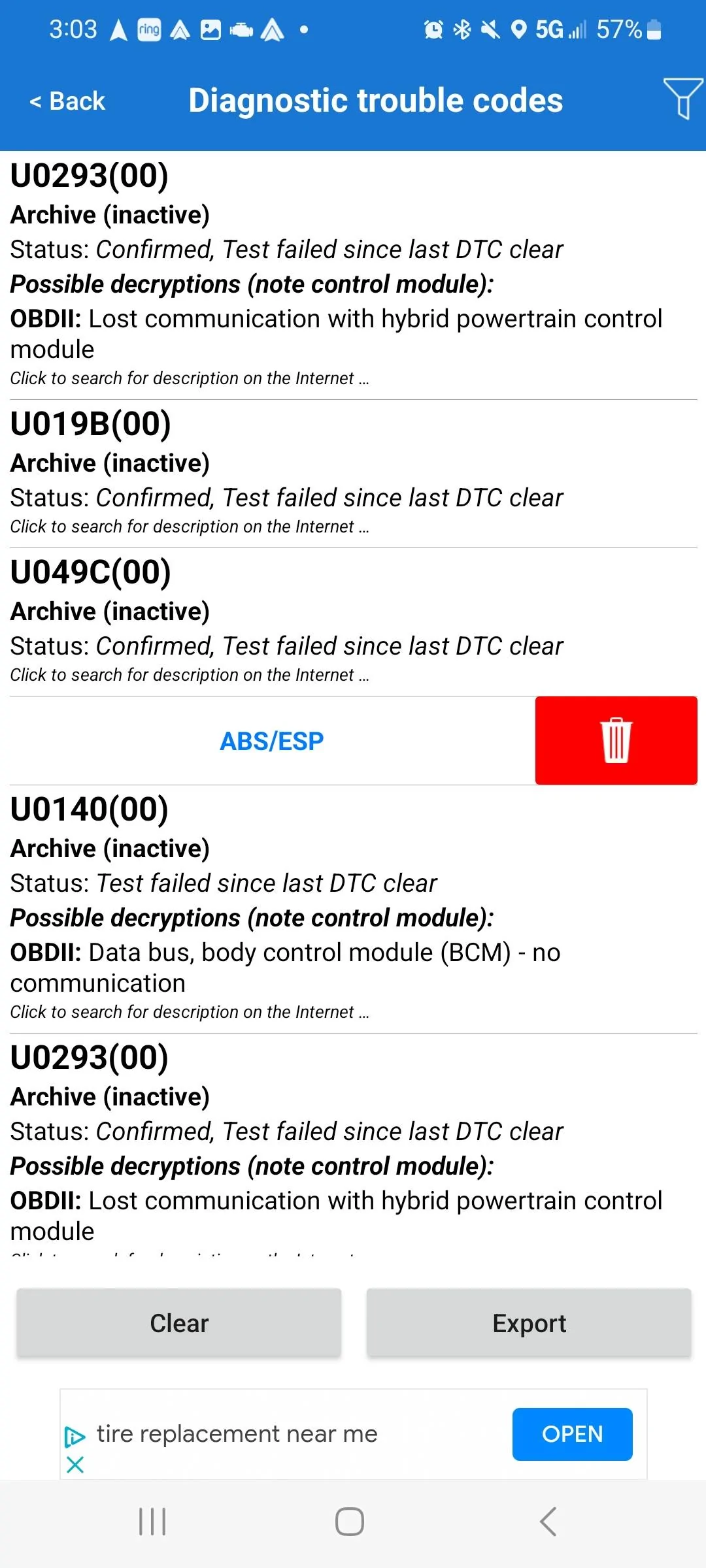

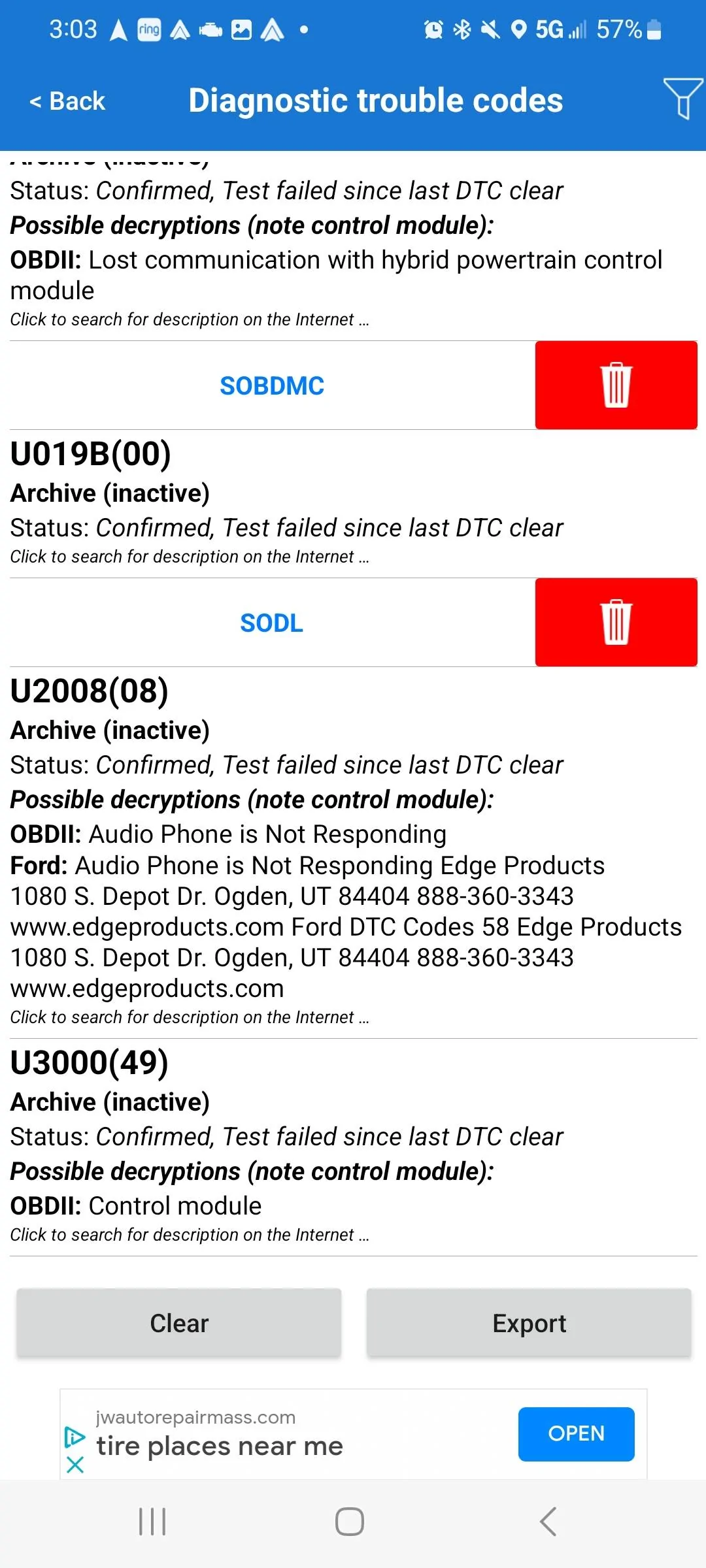

Our car received the Power-Up 3.6.1 update at 2am last night, and shortly after my wife started the car at 7am, this powertrain malfunction / reduced power message showed up. I read out the DTCs with CarScanner, but haven't a clue which would have been the cause. They all look benign enough, where the explanation is given anyway.
I'll just hope it was a glitch related to the update.
