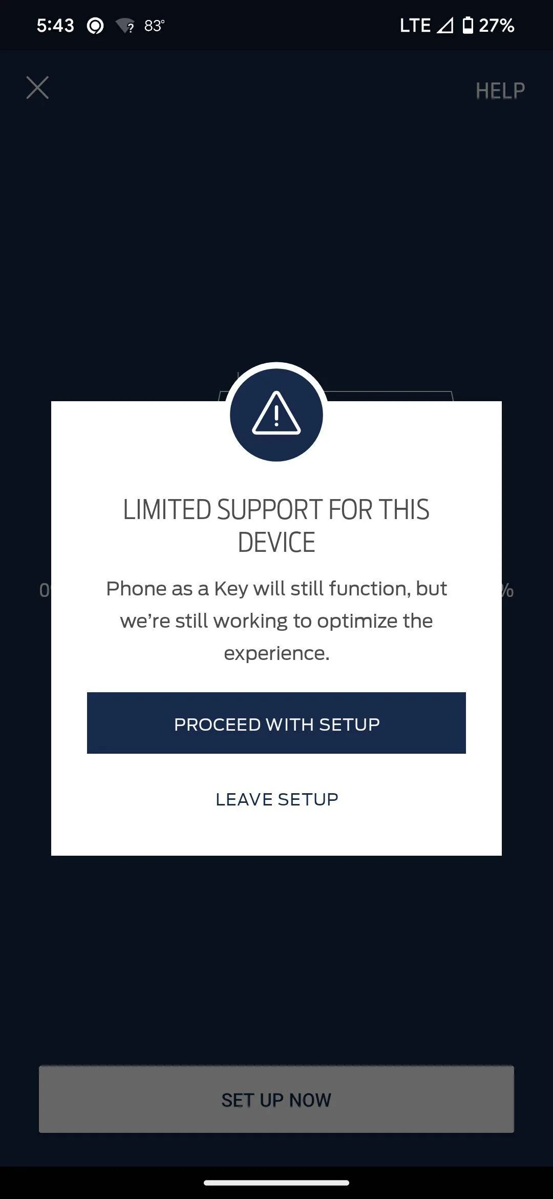

I have a Google Pixel 7 with Android 14 and Jan 5th, 2024 security updates. I have a 2023 Mach E CR1. PAAK does not work at all for me. I tried deleting the key and trying again but the deleted key hangs on to the screen (See picture). I've had difficulty adding new keys and it always gives me an error. I've also had issues with the unlock button being greyed out. If that happens I log out and log back in and it works for a while.
What is my best option here? Can I do a master reset? Or a ford sync reset?

Clear the app data and start over. Make sure there are no keys listed in the vehicle (forget where that's at). You will need to login and start over. I have had decent luck for 2 weeks until last night where the app refused to connect to the vehicle but the display showed me as connected.

@BubbleGhost
the vehicle side to reset is: Settings->General->Reset->FordPass Connect Reset->Phone As A Key Reset.
this will clear ALL keys so if you have others using your car you'll need to re-setup for them as well.
i have a pixel 7 as well and have had a very good PaaK experience since the late a14 beta releases through now so hopefully you can get this straightened out as well.

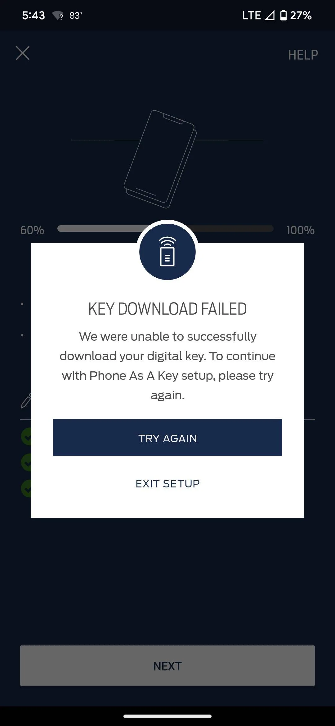

Thanks for the information. I tried it and cleared the keys but I am not able to add a new one. I get this error message. I might have to take it to a dealer but I'll try a few times before I do that.
