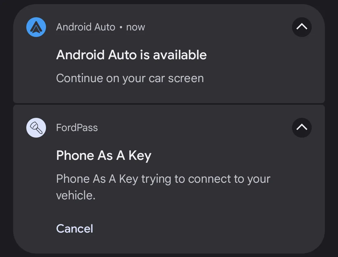

Fair. It gets to the part where it copies the code and waits for the car. Just sits there waiting, presumably for the car to do something. Here is what the phone notifications say:
Ford Mustang Mach-E [PSA] - PaaK and Pixel 7 / Pro Screenshot_20221015-083748~2
No issues with the normal Bluetooth connection.
Edit: forgot to mention that it just eventually times out.

Ok so just to cover the basics. You must have a key fob with you and the car must be turned on to accessory mode at the very least.
Remove any bluetooth connections that you don't recognize from the phone. There could be some straglers that will discombobulate things.
When the phone prompts to allow the bluetooth connections, which there should be about 3 of, accept them all. Only 1 of them will require the copied code.
If all else fails, reset PaaK in the car one more time and try again.
I've tried fob just in the car and in the special spot in the center cubby. And tried both accessory and full on.
I only have the Mach-E normal BT connection and 2 Pixel Stands. I've also tried without the Mach-E connection remembered. I suppose I could delete even the Pixel Stands.
I never get these now. I got 1 or 2 the first time I did this. But nothing on subsequent attempts. None of the attempts has resulted in it working. I did delete a BT connection that was like a MAC address from the first attempt.
Odd that the PaaK reset line itself is grayed out, so I did the Reset All instead. Only thing I haven't tried is the upper level Master Reset.
Thanks for trying to help!
The one that looks like a Bluetooth address (no name provided) is probably PaaK. For my vehicle, it starts with F8:8A.
The audio/phone connection starts with 28:38, and maybe as of Power-Up 3.x, it's sending its name as "Jonathan's Mustang" and it shows a Ford logo. When I paired the Pixel 6 a year ago, with older vehicle software, it was a more generic name and no Ford logo.
I had no trouble pairing the phone for regular audio/phone stuff. But the first time I tried pairing for phone as a key, I didn't get the normal pairing pop ups on the phone.
Then I used SYNC to disconnect from Android Auto and tried again... And it worked. I got the three or so bluetooth pairing request pop ups on the phone, like @DevSecOps described, with one of them prompting for a password.
