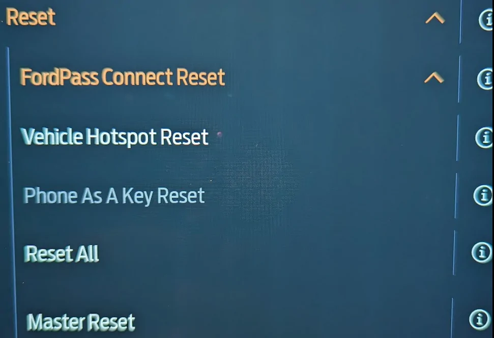

Does anyone know what it means if Phone As A Key Reset is grayed out? It may be hard to see in this photo, but it is grayed out in my car:
Ford Mustang Mach-E [PSA] - PaaK and Pixel 7 / Pro 1666122873600
Does it mean that it is already reset as much as it can be? If so, then I would think the problem is on the phone, but I have removed all BT remembered connections and cleaned off the FordPass app (force stopped it, cleared cache, cleared storage, uninstalled, then reinstalled). I am sure it's something simple I'm missing, but PaaK just won't complete setup.

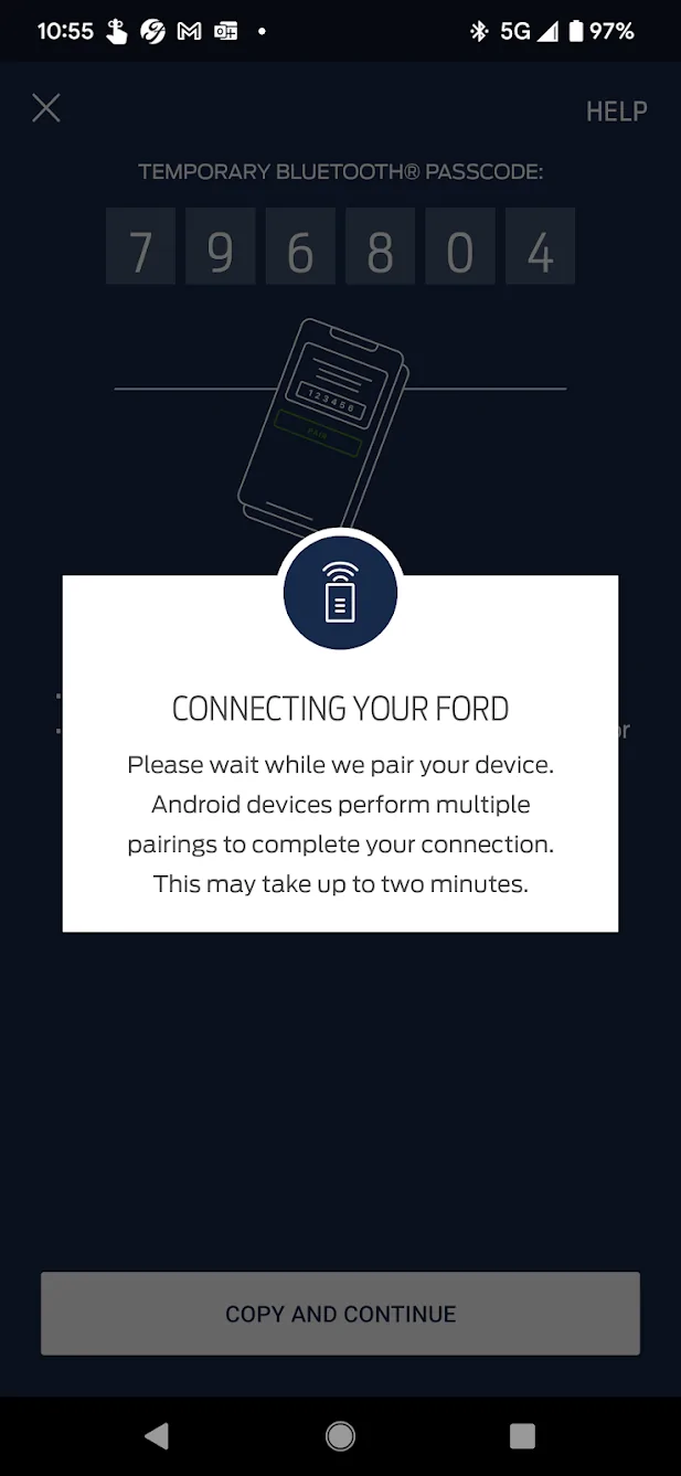

I added location permissions and still could not get it to setup PaaK. It gets here:
Ford Mustang Mach-E [PSA] - PaaK and Pixel 7 / Pro 1666123011092

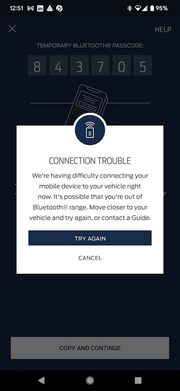

Then in a minute or so, it goes to this:
Ford Mustang Mach-E [PSA] - PaaK and Pixel 7 / Pro 1666123054040

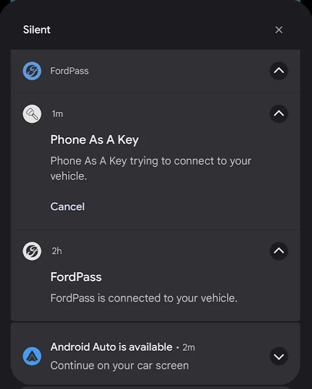

The notifications are:
Ford Mustang Mach-E [PSA] - PaaK and Pixel 7 / Pro 1666123111720
