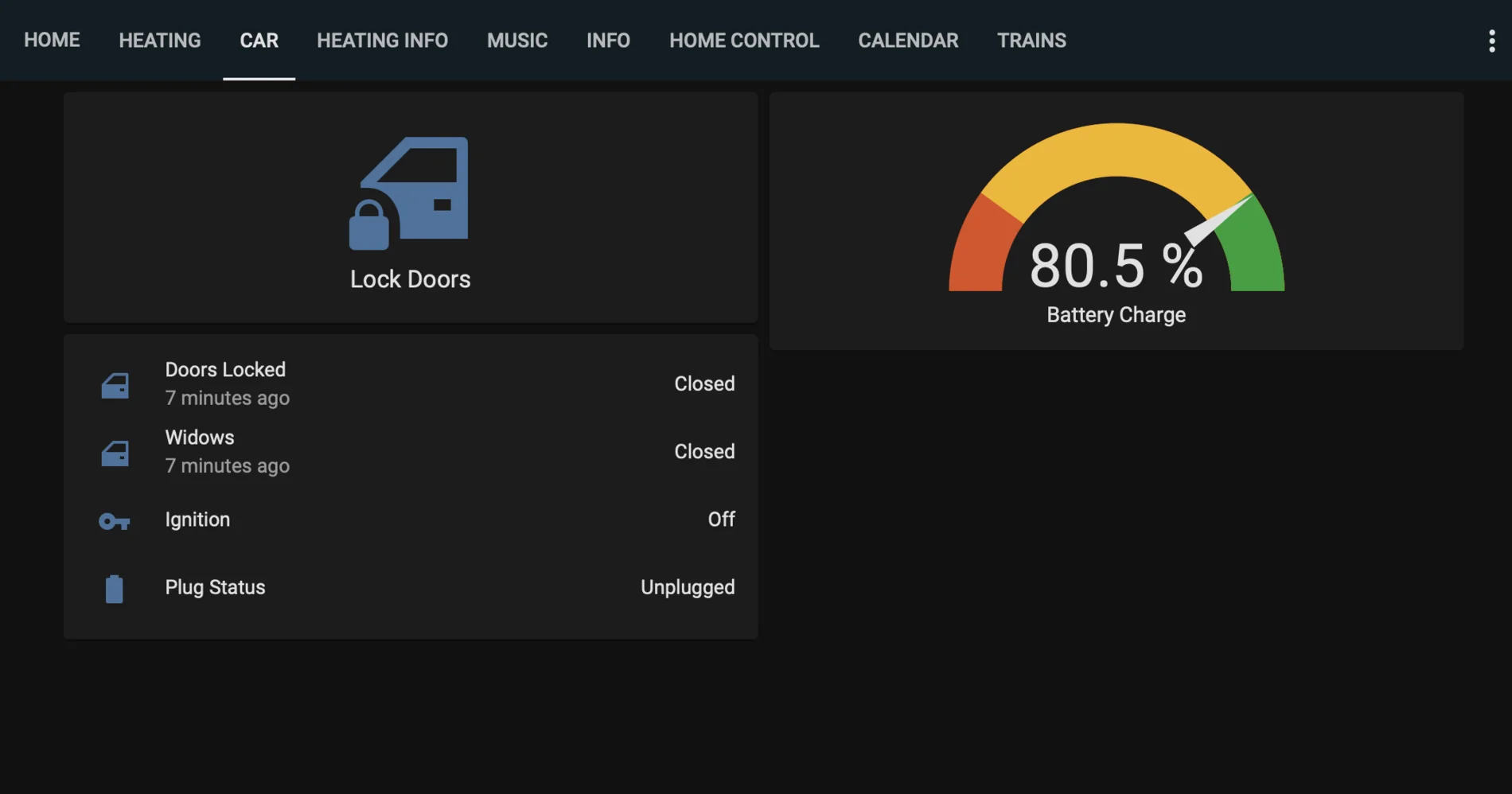

Thank you, I just made the Battery percentage work. I will add more info now I can see how to do it.
Mind sharing your config/template for the battery percent?
Nevermind - I figured out what I was missing!
