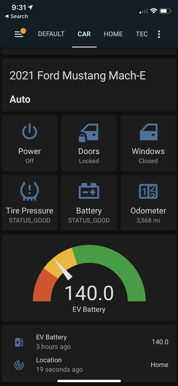

Personally, I’m still struggling getting the battery percentage from the attribute to show on my Lovelace card but I feel like it’s coming along nicely.

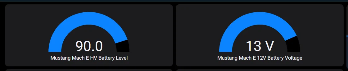

I have the integration set to imperial, but it still natively shows "range" in km. No that important to me as I don't really care about what range the car thinks it has. I'd rather just know the HV battery SOC.
Here's what I added to my config yaml to have that attribute show as it's own sensor, along with the 12V battery voltage:
Code:
sensor:
    platform: template
    sensors:
        mache_hv_battery_percent:
            friendly_name: "Mustang Mach-E HV Battery Level"
            value_template: "{{ state_attr('sensor.fordpass_elveh', 'Battery Fill Level') }}"
            device_class: battery
        mache_12v_battery:
            friendly_name: "Mustang Mach-E 12V Battery Voltage"
            value_template: "{{ state_attr('sensor.fordpass_battery', 'Battery Voltage') }}"

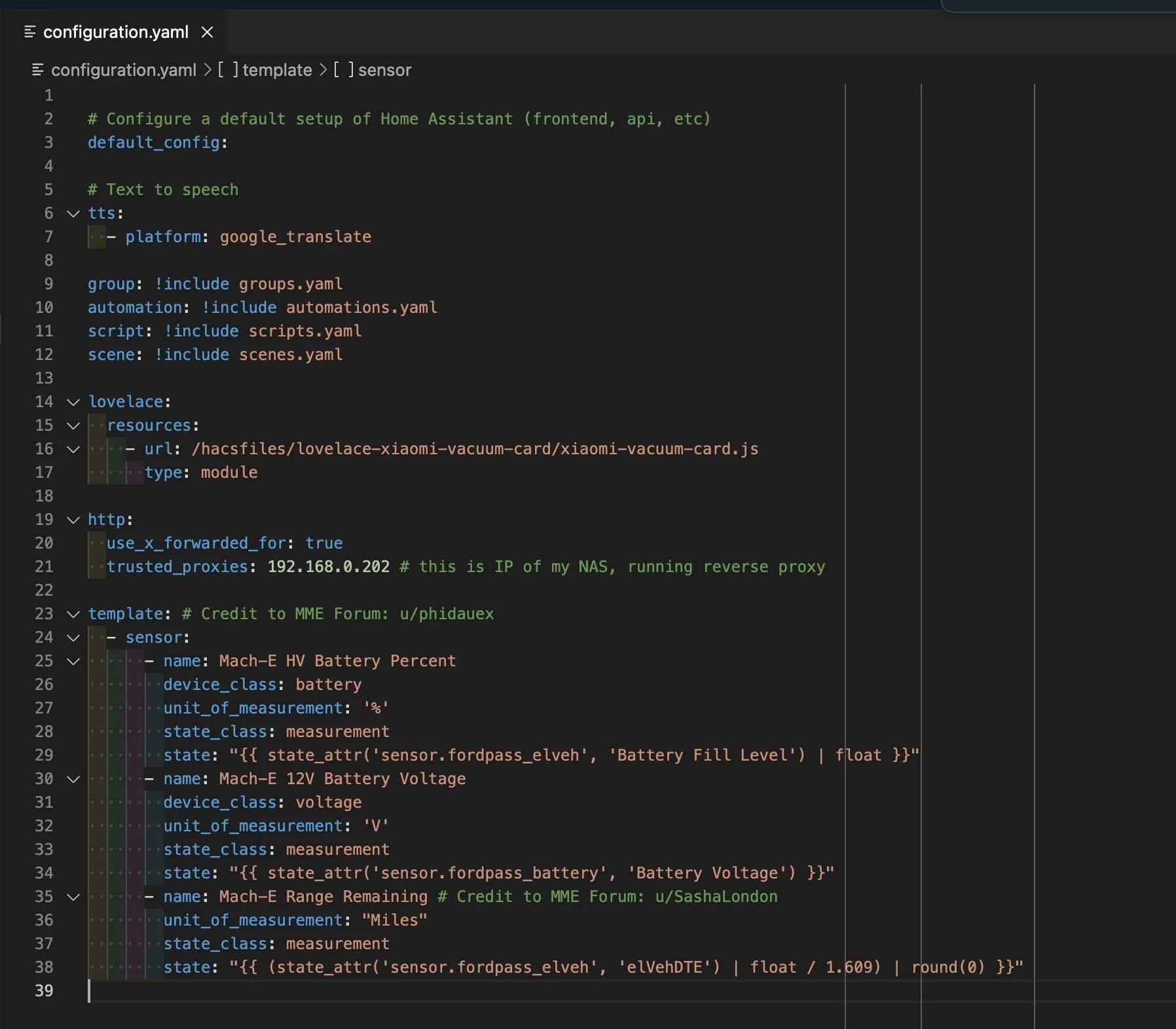

ford_range_left:
friendly_name: Range
entity_id: sensor.fordpass_elveh
unit_of_measurement: "Miles"
value_template: "{{ (state_attr('sensor.fordpass_elveh', 'elVehDTE') | float / 1.609) | round(0) }}"

ford_range_left:

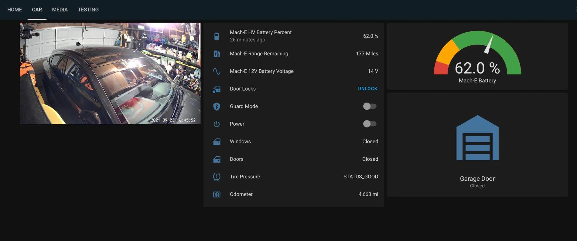

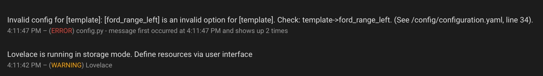

Thanks for your help with this. Initially, I had issues with my Lovelace instance:
Ford Mustang Mach-E Public API lovelace_error
I reworked it a bit and my config now looks like this:
Ford Mustang Mach-E Public API config_yaml
The end result for my current Lovelace card:
Ford Mustang Mach-E Public API home_assistant

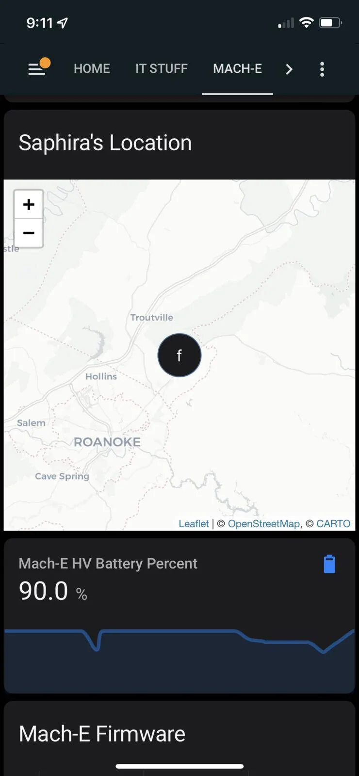

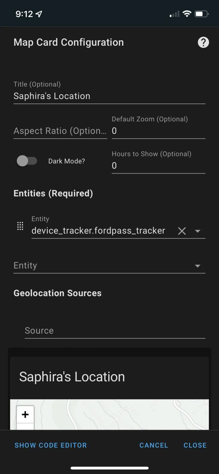

I believe there is already a tracker. I had this available without doing any editing myself…
Ford Mustang Mach-E Public API 86539600-CE47-4D46-9688-CDD0B708B538
usedit to make the map card which has always worked well for me.
It absolutely had one there, already. I was overlooking it for some odd reason. Thanks for the additional eye opening. I am quite happy with the setup.
