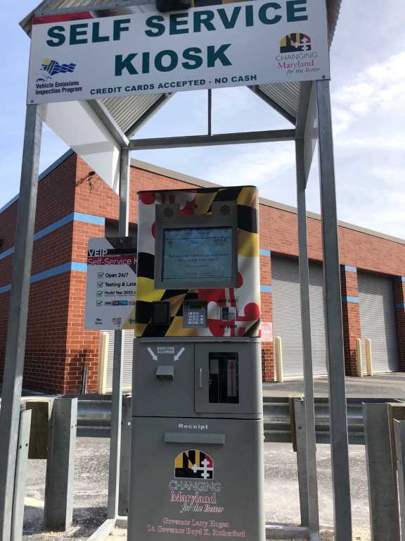

I want you FDRS experts to chime in....
Is it feasable to build a self-serve software update kiosk? Owners could connect their car with an OBDII cable originating at the kiosk to receive necessary updates. (Note: here in Maryland, there are similar devices for vehicle emission testing).

Yea, I guess so. The "kiosk" would need to include a power supply, the cable and a laptop with an active FDRS license (and a disclosure to use at your own risk). The user can bring their own USB drive. In theory, it is doable. That would be pretty cool if dealers had a set-up like that.

The issue would be disassembling the frunk to get to the battery so you can connect constant DC power. A lot of updates are 2+ hours and the battery will die long before then without a connected power supply.
If, however, everyone who uses the "kiosk" installed one of these (like me :)), then it would just be two plugs and a laptop.
Battery Quick Connect: https://www.amazon.com/gp/product/B0CSYGK72P
This power supply is pretty cheap and does the job if you want to set one up:
https://www.amazon.com/gp/product/B01ER3LH1G
Then you just need a laptop and this:
https://www.amazon.com/gp/product/B097NHQ7ZW

"self serve" and "kiosk" suggests something unattended. I'm not sure anyone would want to leave the required equipment just laying out in public like that. I wouldn't.
On the other hand, there are folks here who are willing to help out others. For example, I have the equipment needed (mongoose, PSU, laptop) and if someone was willing to cover the cost of the 2 day software license, I'd probably be willing to let them park in my garage and run the updates with them. I might also ask for a donut or pizza (depending on the time of day.)

Right - a kisok can be installed at a dealer. The technology is ready. The Maryland testing kiosk is fully integrated, and prints out a report, too. Only needs a credit card. Advantages are 24/7 access, little or no waiting, and several $ cheaper.

Unfortunately, FDRS is not just plug it in and click "Go". (Like say an iPhone update)
You have to read the steps on the FDRS DIY thread and be detailed oriented about following them.
It would be cool if a dealer opened up a bay with the license and equipment and maybe a tech gets you started in a few minutes and then you gotta sit with your car while it updates.
Dealers are in the service business though, and this wouldn't be a profitable option for a dealer to offer
