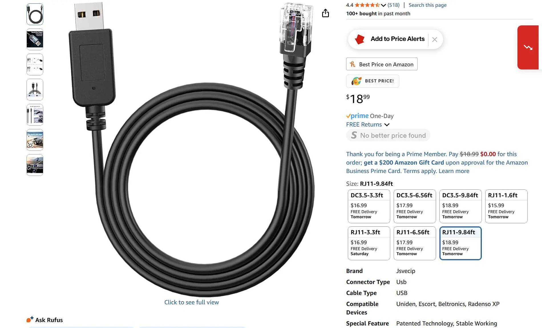

I have a Uniden radar detector with RJ11 port. I have looked and don't see a similar 5-pin mirror adapter with a RJ11 option. I can get a USB-to-RJ11 cable, but that is starting to get a bit messy since the cord is 1m length min.
Any better options?
Actually, I found a 1.6 ft. USB-RJ11 adapter by Jsvecip on Amazon. So, I guess that should work find with the Dongar adapter.
Edit: I need 12V for my detector, so the Dongar will not work for me. Still looking...
