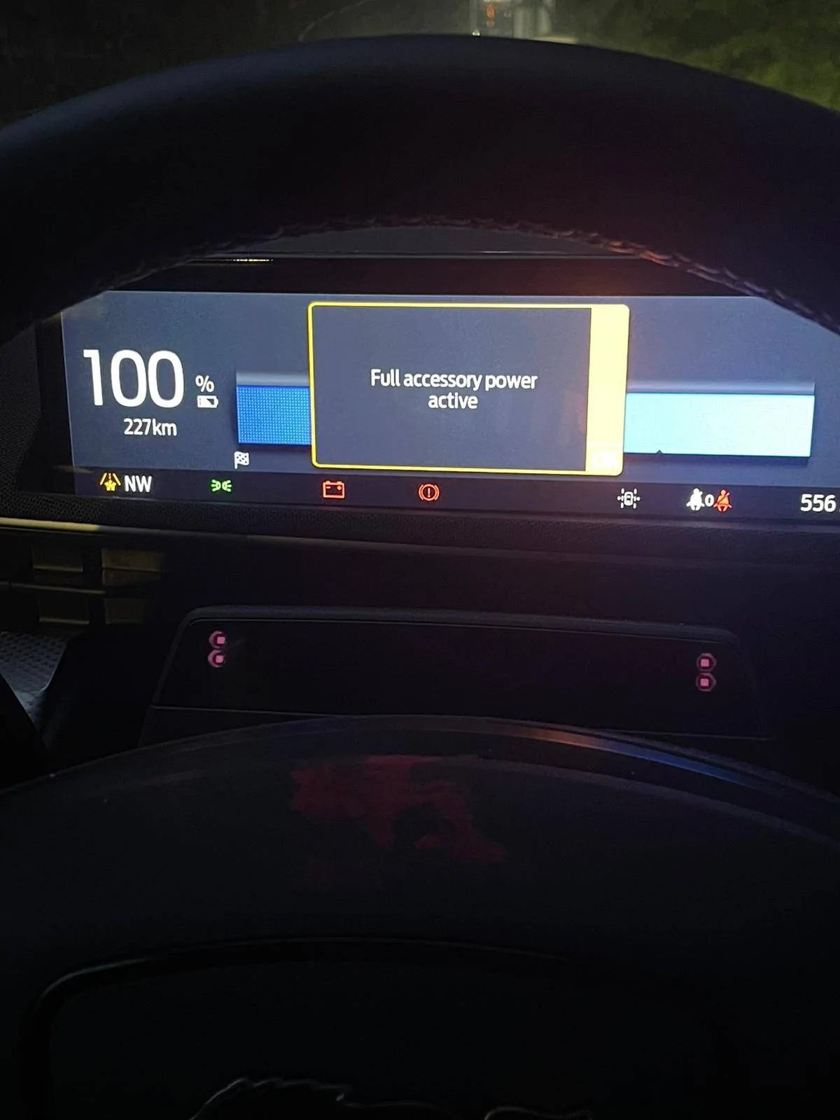

Hello mach-e owners,
I bought standard trim(RWD) last month which suppose to come around 370kms(230 miles) on 100% charge but i am getting only 227kms (141 miles). is this common for the vancouver climate or is it happening only to my car?
I just drove for 5kms and range suppose to drop by 5kms but it dropped 10kms.
Thanks
Mahesh Reddy.

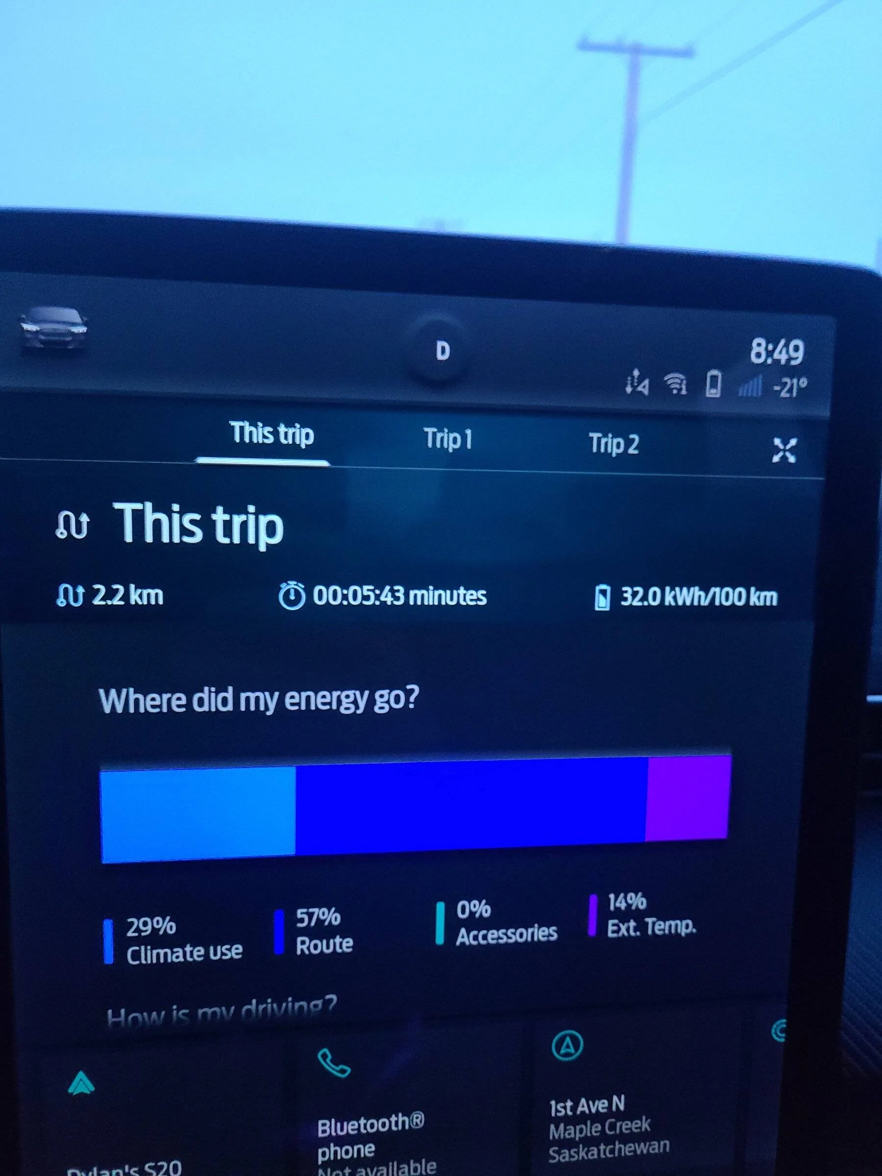

Just dropping kids of at school. Best car ever for it

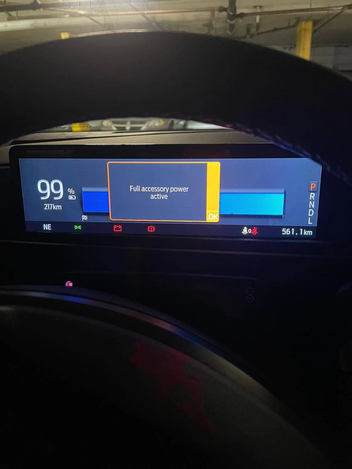

Thanks
Mahesh Reddy.
Fellow lower mainlander here, with a standard range Mach-E. I have AWD but also get similar range drops on my model during this winter and usually see around 215-235km range at 100%. As the temperature has been warming up, I have seen the range increase. I have also noticed that pre-conditioning the car while it's plugged in before my departure has also helped increase efficiency during my drive as it heats the battery up.
