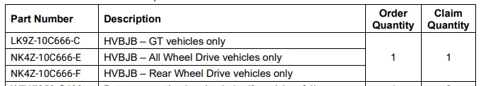

These are the replacement part #'s listed in the recall documentation in post #1.
The part put in mine was in late Oct 2023:
Ford Mustang Mach-E Recall 23S56 - HVBJB Replacement / Powertrain Software Update 1703032291175
So maybe I can get this new -E part as my car is still listed as needing this recall.

Ohhhhhh I wonder if I get a new HV box. I got the B back in 2022 but months before the Tsb came out and the recall has the C part now ???‍♂
