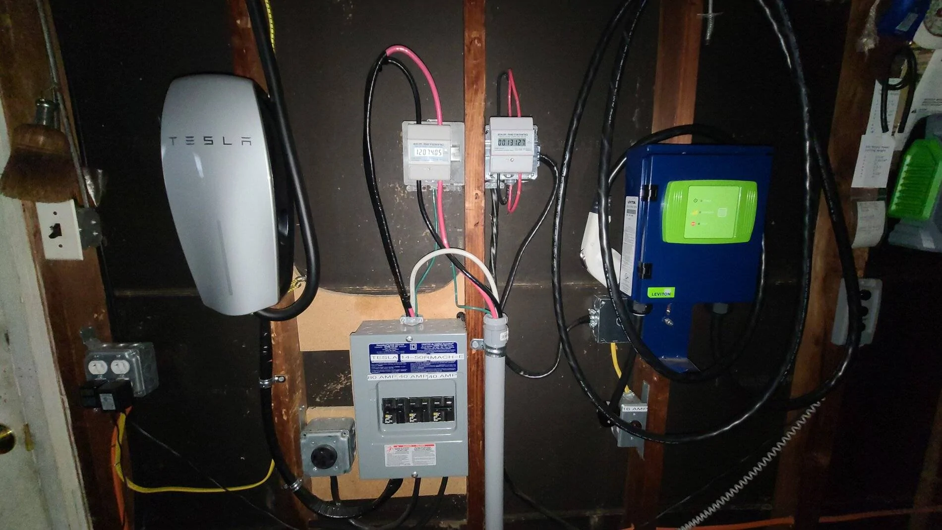

Does that need its own electrical box for it to be mounted on? I assume so, but curious to see your installationThere is always the manual approach where a kWh meter is wired in series with the feed line to the EVSE and the readings are written down on a sheet of paper.
I use this one.
https://www.ekmmetering.com/collect...ers/products/universal-single-phase-kwh-meter
It will maintain the reading for 10 years in the absence of power.
