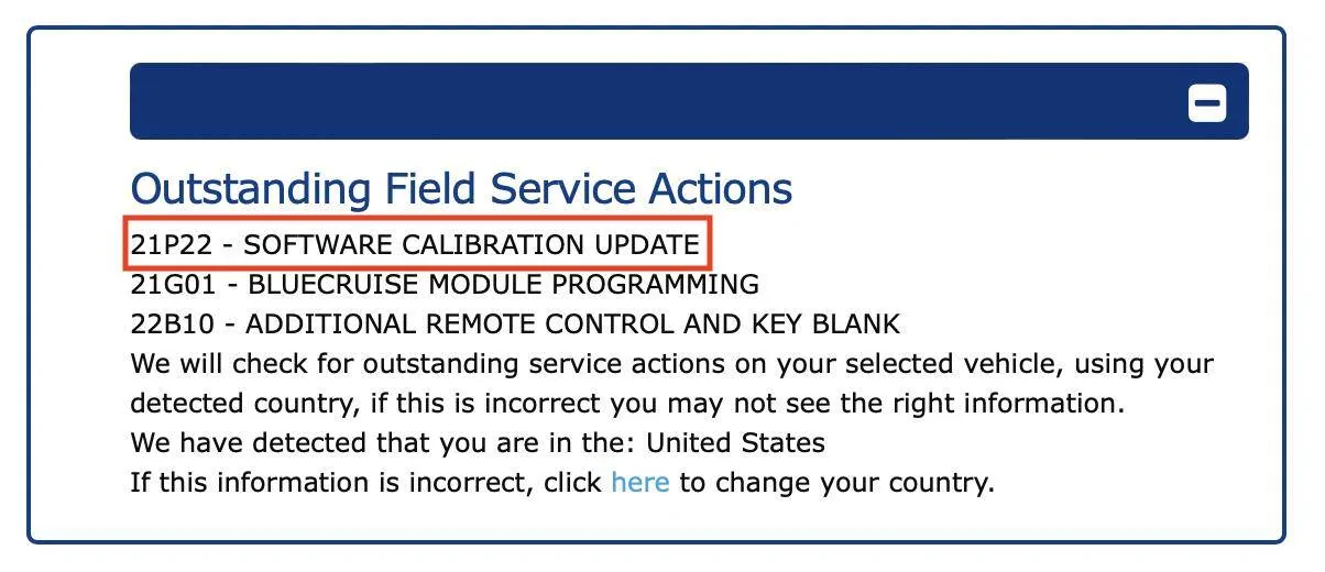

The 21P22 software update program is ending in two months. I strongly recommend anyone with a 2021 Mach-E built before Sept 30th 2021 get these updates applied (if you haven't already) while they are free. They provide many improvements in software made since your vehicle was built (such as PAAK). After the program expires, it will be much harder to get your dealer to update these modules without charging you.
Original forum topic: Customer Satisfaction Program 21P22 - Software Calibration Update
Due to current dealer service backlogs, try to schedule with your dealer ASAP if you still want 21P22 done! You might have to wait a month to get in.
How do I check if I'm eligible for the 21P22 updates?
  1. Go here: https://www.etis.ford.com/vehicleRegSelector.do
  2. Enter your VIN.
  3. Look at the list of Outstanding Field Service Actions for your vehicle.
  4. If you see 21P22 in the list (see below), then you are eligible for the updates.
What if I don't see 21P22 listed?
Then it was either done already, or your vehicle is too new to qualify.
  2. Enter your VIN.
