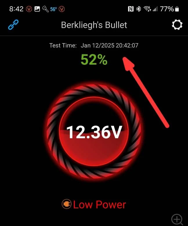

I'm literally sitting in my recliner watching the game. The car is parked just outdoors. It hasn't moved all day, although I did wake it up once to fetch my laptop out of it.
So as I type, I open an app on this phone.......
Ford Mustang Mach-E Remotely Accessing LV Battery Voltage from Ford.com with Chrome Browser Screenshot_20250112_204228_Battery Monitor

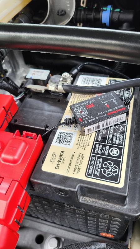

How is this installed
Physically attached to the battery. It's just a tiny low draw voltmeter that communicates over Bluetooth to your device. And the app downloads the voltage logging since the last Bluetooth connection. It allows you to review the voltage per day/week/month

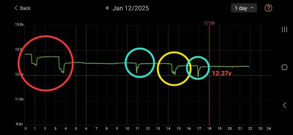

Ford Mustang Mach-E Remotely Accessing LV Battery Voltage from Ford.com with Chrome Browser 20250112_215109
Today's logs up until a few minutes ago (below)
Red voltage variations were just after midnight to about 4am. I honestly have no clue what activity is behind those current draws. But the 2 draws lasted for several minutes each and drew the resting voltage down considerably.
The 2 green circles were me walking past the vehicle with my phone today. PAAK woke the car. (11am & 5pm)
Yellow circle was me opening the door to retrieve the laptop.
