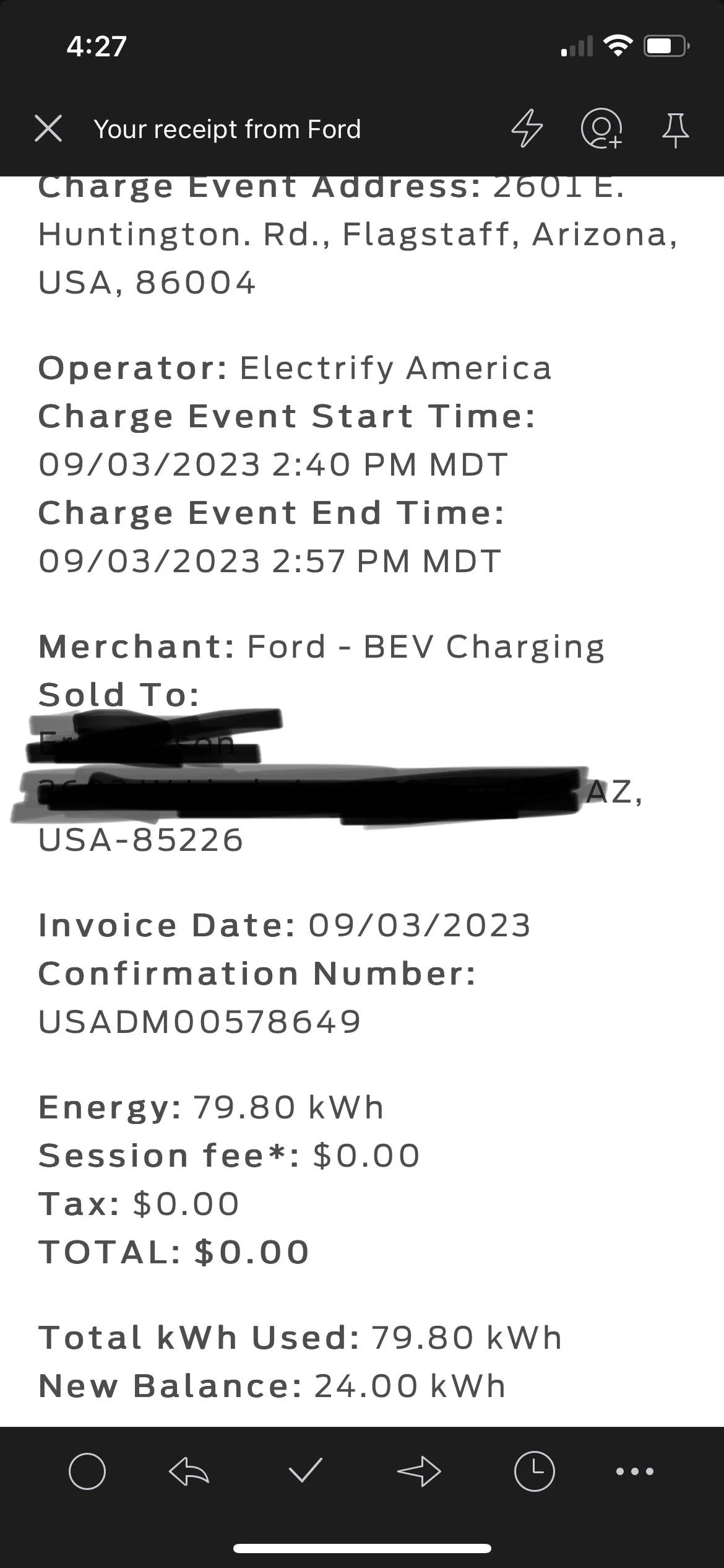

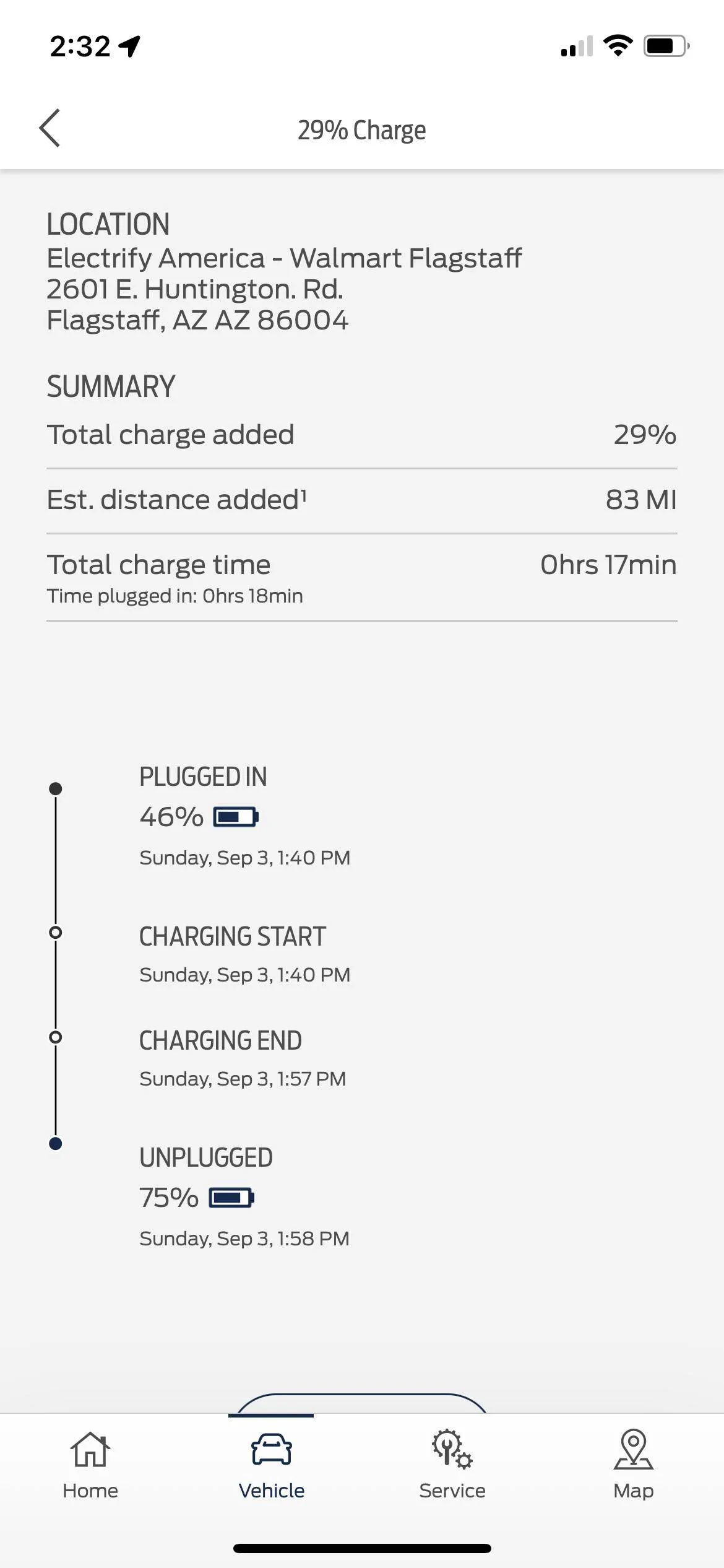

Maybe someone can figure out what I can’t. I plugged into a 150 EA charger for 17 minutes.
Yet I somehow put 80kW into my car in that 17 minutes.

Actually after talking to the BEV team this morning (who swear I can't possily use P&C, which yup, I can't) I started digging through my DCFC charge history which was an eye opener. From my First charge in January to last weekends snafu all kinds of free kW has gone missing.
Starting balance 500kWFeb '23
Balance:UsedSupposed balance from FordpassDate
500kW15kW (initial test)477Feb 9
47758357Feb 20
35711kW346April 11
P&C Expires and disappears All Connected services crap outApril 12
P&C reactivates250kWApril 20th
250kW17203May
?60203May 16
20317kW126June 2
1261kW (failed charge)125June 18
?80kW (magically in 17 min..)24kWSept 2
268
18,068
28,350
29% of 91 is 26.39kWh.
At a rate of roughly 1.6 kW per min, that would be 17 minutes.
So, right on. EA is clearly charging,you for the previous person's session.
on the other side of the ledger, my BOCN EA balance hasn't deducted any kWh in the last 3 sessions. maybe now we know what account they're being deducted from. ?
Yeah I think that's exactly what happend.
Want to know the kicker? The previous charger was, a, MACH-E as well! (who charged 72% added, I saw the bar when she went to unplug)
I plugged in about 2 minutes after they unplugged. I manually activated the charger, waited, plugged in, got in, still waiting for "Activating" or whatever the circle is while it's loading, got out when it finally went to the screen to "Start". Which I had to click Start (I have to every time) got in the car.
The % meter was correct. Power delivered went to 2kW then 74kW as it continues to charge 27% (on the % meter) the power delivered slowly crept up to 78.something when I stopped it.
Few min later I got the FP email and WTF'd it.
