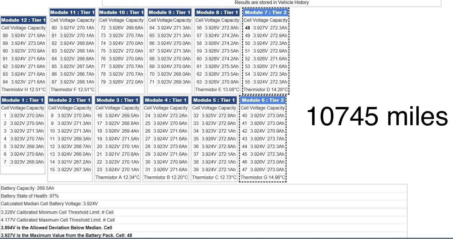

I wouldn’t worry with what obd tools spit out. Unless you run a battery health check with FDRS which takes a few minutes and generates a report like this. Then you can see cell voltage issues etc.
As you can see in image here I’m at 97% at about 10.5k miles
Rob, this is interesting data. I’m curious if your battery’s SoH shows differently in the OBD. Do you mind telling us what that figure is? As mentioned above, the BMS programming changed recently, which is what made my battery’s SoH drop from 95 to 85%

Many of the OBD scanners I have tried at my shop have been pulling the 12v SoH not the HVB. At the moment I only have the FDRS laptop. They have a specific BECM program that runs and polls all the cells and spits out this datasheet I attached.
Either way if the OBD is reading a HVB SoH value I am not sure it is updated as regularly and thoroughly as the actual BECM battery health program in FDRS is generating when it runs its tests.

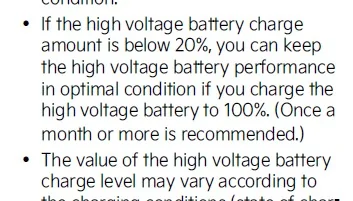

If you're DCFC I'm guessing you don't hit 100% very often, which is when I've seen the load balancing occur. If I recall correctly, we should be charging to 100% every month or couple of months. I don't know if it's explicitly called out in our manuals but Kia does in theirs so I assume the same logic applies
Never read or heard of such. I haven't been to 100% since end of August and my soh is like 99.6!
Ducked Kia manuals and then EV6 and opened the PDF. CTRL F 100 in the PDF came up with this
Ford Mustang Mach-E Significant drop in SoH Screenshot 2024-03-29 074810
What's the logic if any? But now we have heard of it ;)
