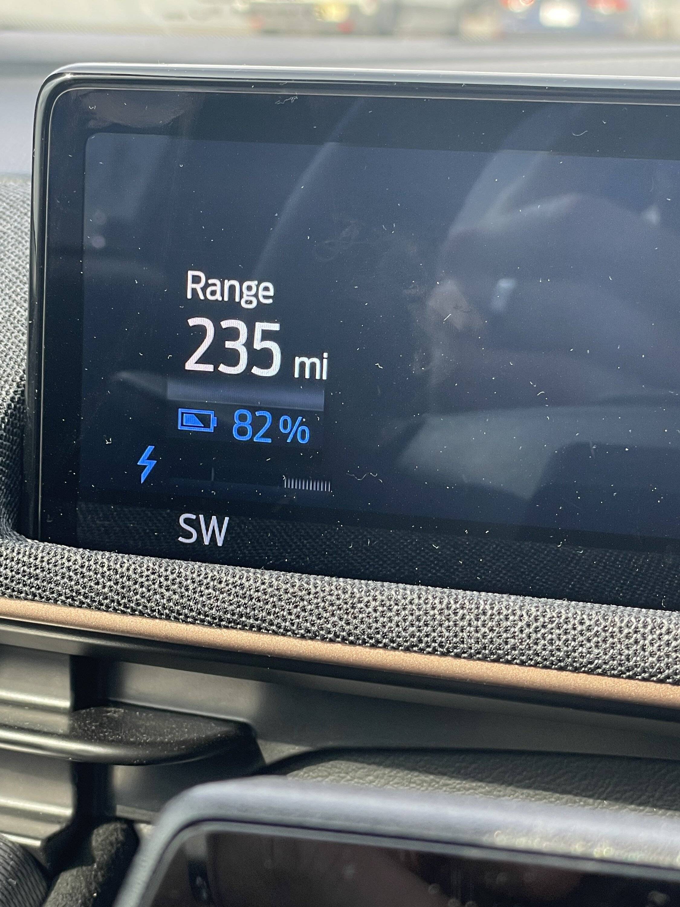

People keep speculating that it’s a “cooling issue.” It isn’t so simple.
The gray bars of death seem to show up at different times.
Exterior temps very low. (Obviously not a cooling issue).
High cruise speed. (Potentially a cooling issue).
5 seconds of full throttle from a stop (a programmed limit, too short of a time to be a cooling issue, does this no matter the temperature).
The only one I really care about them “fixing” is the artificial 5 second limit.

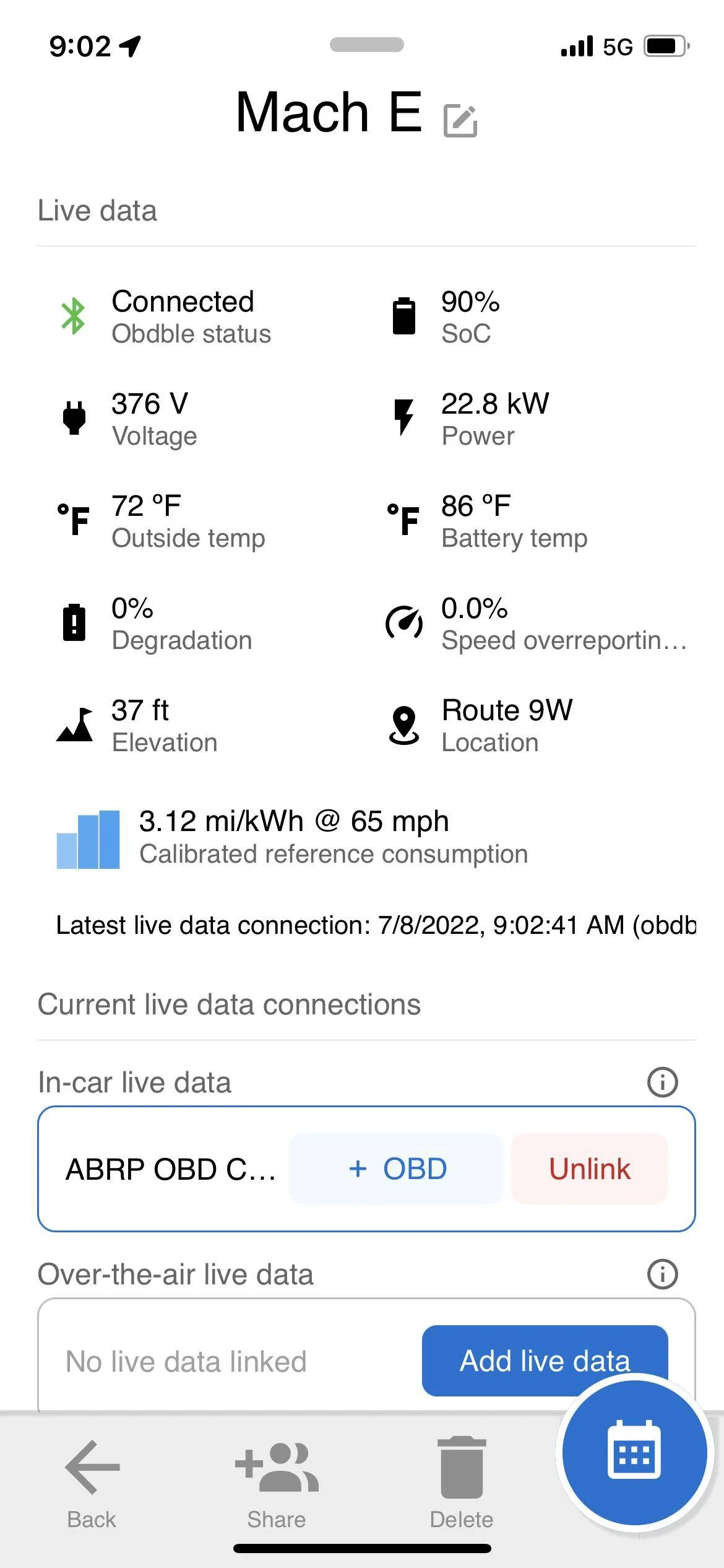

I level 2 charged overnight from 44-90%. Car was charged indoors at 75*. I had half power for my entire drive of mixed city and highway for over an hour.
Ford Mustang Mach-E So so so many power bars 86677B89-3C46-4F58-9336-9832A152315A
Ford Mustang Mach-E So so so many power bars 23C864F6-354F-4CBF-83BD-361B793BCD6E
Mach1E
10,509
13,295
That’s not normal.
Have you had the recall work done?

@JRuggiero Sometimes I get the bars for no reason at all. I think it’s a glitch in the startup of the computer. If I pull over and shut the car down for a minute when I restart they’re gone.
Wow, that is giving me a winter flashback.
