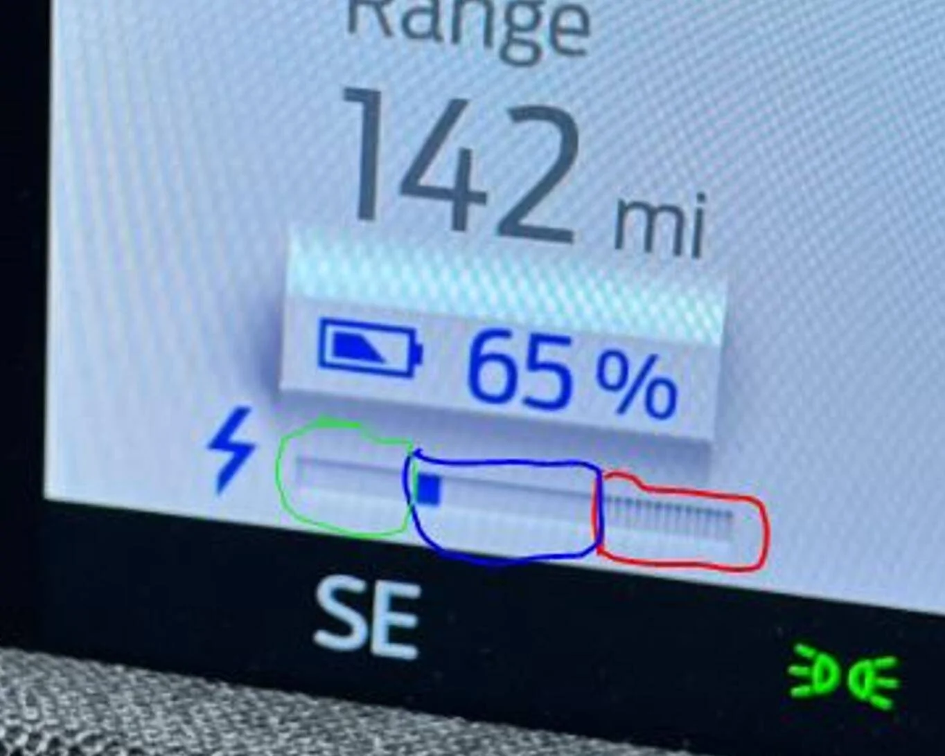

GTs have a tiny "power bar" in the lower left corner (the fact that it's tiny and in the lower left corner is another issue) and when the GT lowers the power output of the motors due to being too hot or you going too fast or you having recently fast charged it grays out part of the bar which if you look closely you can see on the right side of the power bar. The green circled part is where it shows if you're regenning, the blue part is available power, the red part shows how much power isn't available.

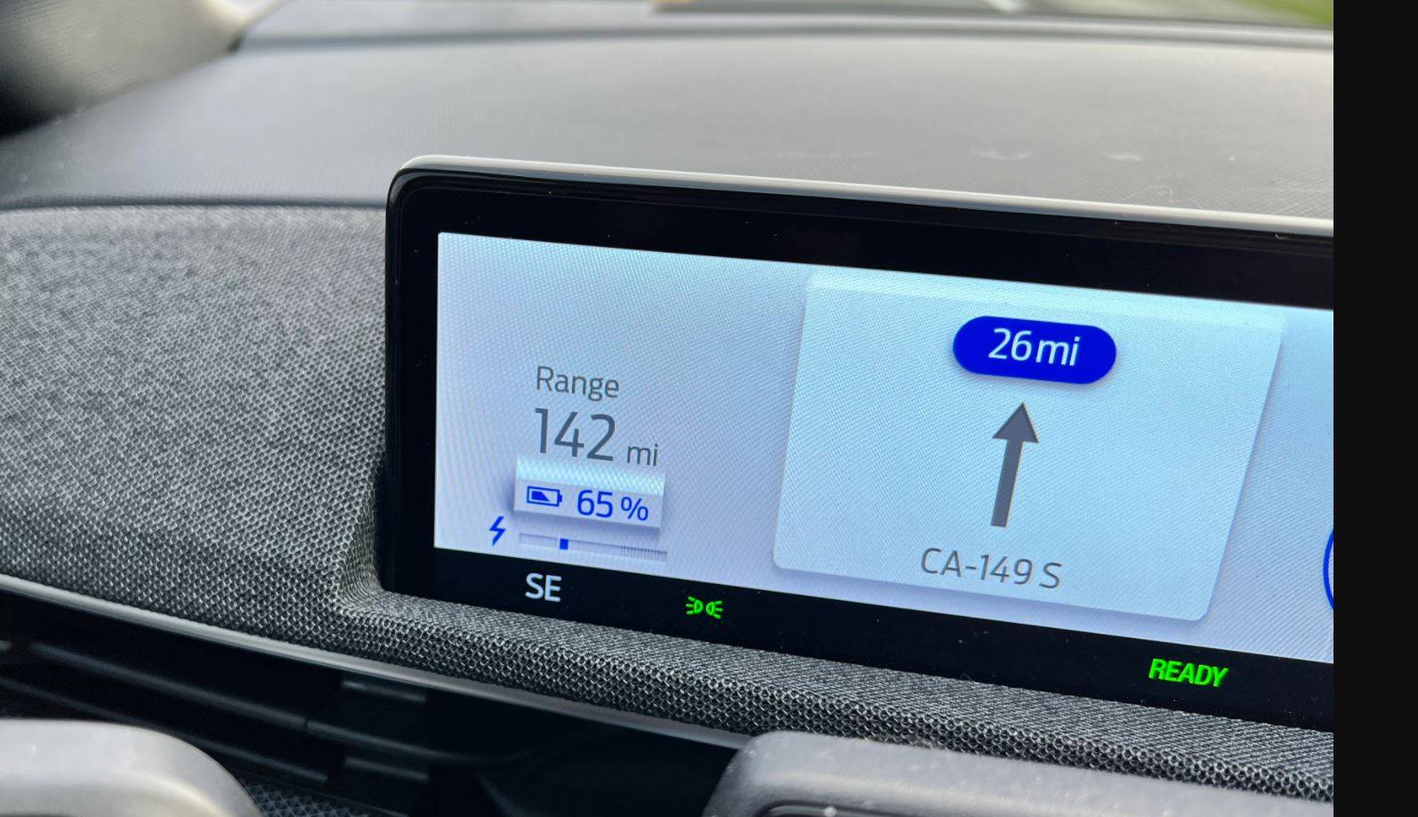

Has anyone ever seen this many? What the hell? Forget about being slower than a 2.0T Accord with this many bars, I'm pretty sure the thing was slower than a Prius. I took a video of 0-60 which seemed like it was 8 seconds or so but need to figure out if I can edit a timer into it to see for sure.

Your picture shows 65% SOC (meaning this point is irrelevant for why you had bars in this moment), but also important to remember that as your pack SOC gets low (below 30%) those bars get larger and larger as voltage starts to significantly suffer. At 7% SOC I had half (maybe less) power as the pack voltage was toast. This is normal. Polestar can’t even maintain highway speeds below ~5%.

It was after DCFC but it stayed that way the rest of the day basically. They never went away (until I stopped for the day). I understand if it happened for like 30 minutes after DCFC but they stayed for hours. I guess its normal for the car but I'd never seen anyone mention anything this bad with other EV's and I didn't really expect the bars to stay around all day.
And the amount of the loss of power was surprising. I got beat to 0-40 mph by an F-150. An F-150 that wasn't racing. Literally ~8.2 seconds to 60. I kinda would expect 5 or 6 seconds but 8? Jeezum crow that's slow.

All the MME's have limited power after certain things like hard acceleration or DCFC. With the GT models there's a power bar that illustrates this. On the Non-GT models it still happens but it's not illustrated in the cluster.
If you look at his picture under the % of charge you'll see a lightning bolt. To the very far right there's bars that show limited power. It's very hard to see in his example, but they are there.
