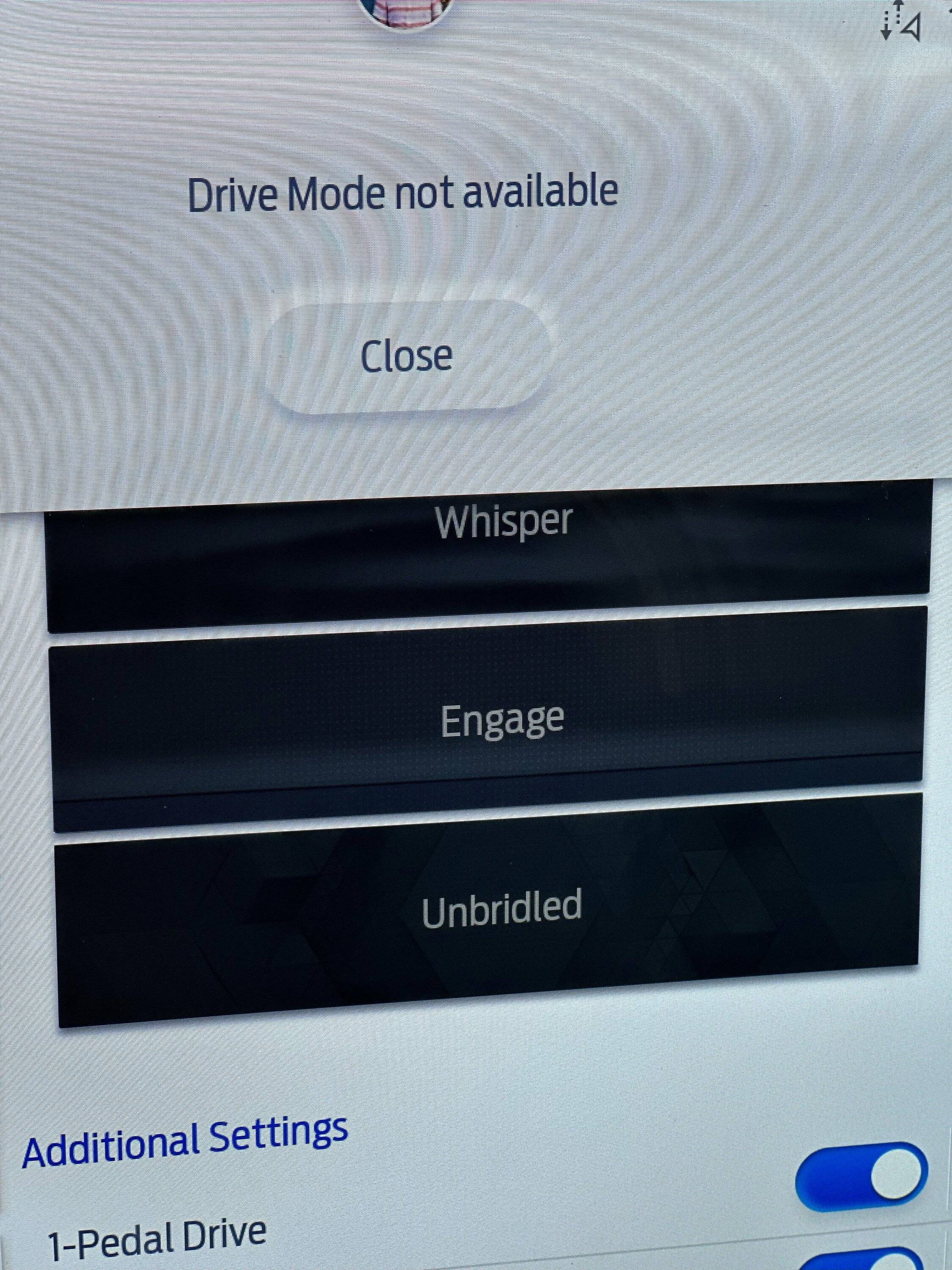

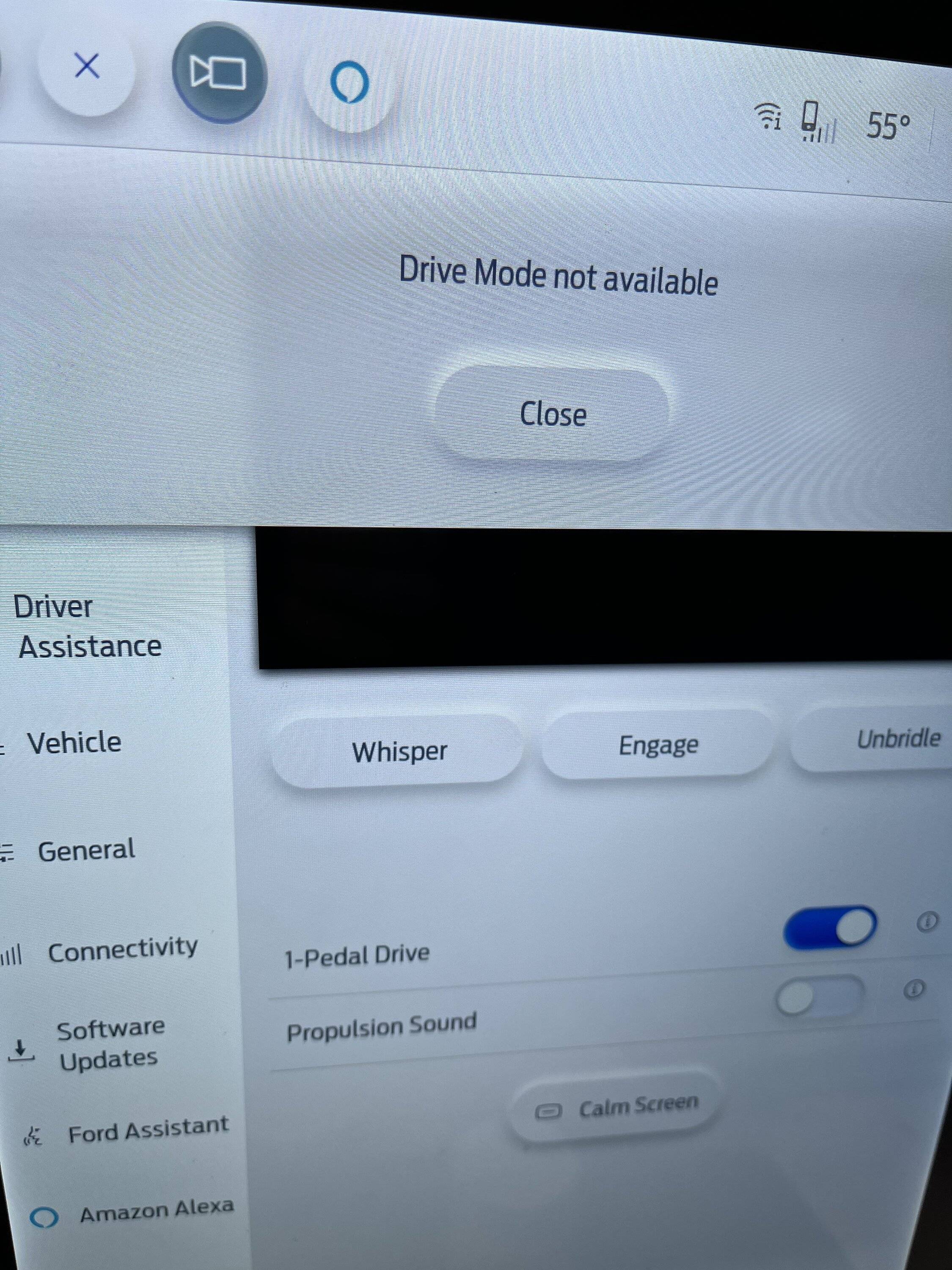

*edit as I see with last update Unbridled is misspelled when I looked at the pic I just uploaded…Come on FIRD, check your spelling ??
Add my Job 1 SR/AWD to this annoying list.
Car has been largely error free lately (funny to type that, that’s where we are with these tech-laden vehicles) so it was frustrating. Mine occurred 3 times in a 10 minute period today while city driving. It was vey noticeable as it seemed to default to Whisper as was stated earlier in the thread, but it did not register that on screen.
I drive always in Unbridled, so the difference in the OPD let off pulling up to a stoplight surprised a bit.
I toggled the ‘settings screen‘ back to Unbridle {sic} and it ”held“ that setting for a couple blocks, and then did it once more before I got to destination and powered off for a bit. After restart seems that reset worked. Will see if it happens again, sounds like a trip to dealer anyway,, and then can acquire my freebie 2nd fob which will sit collecting dust with its brother. I am a PAAK man.
