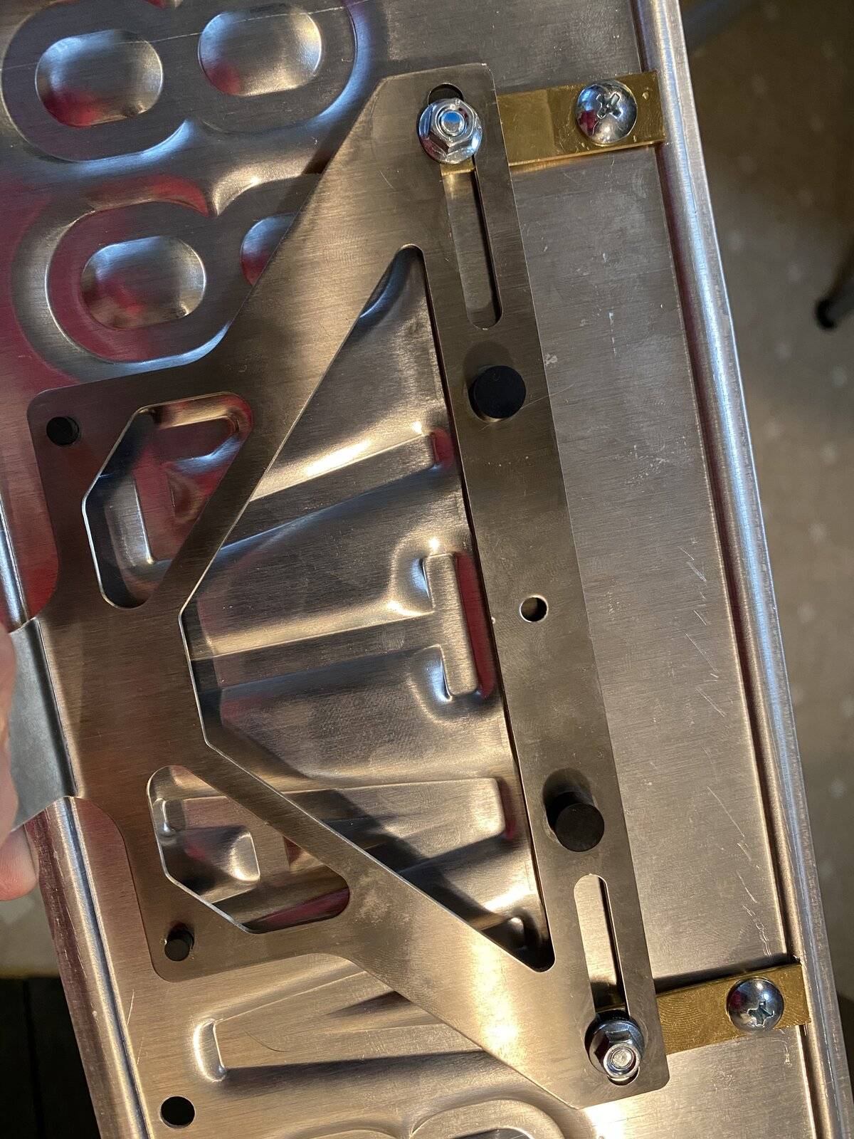

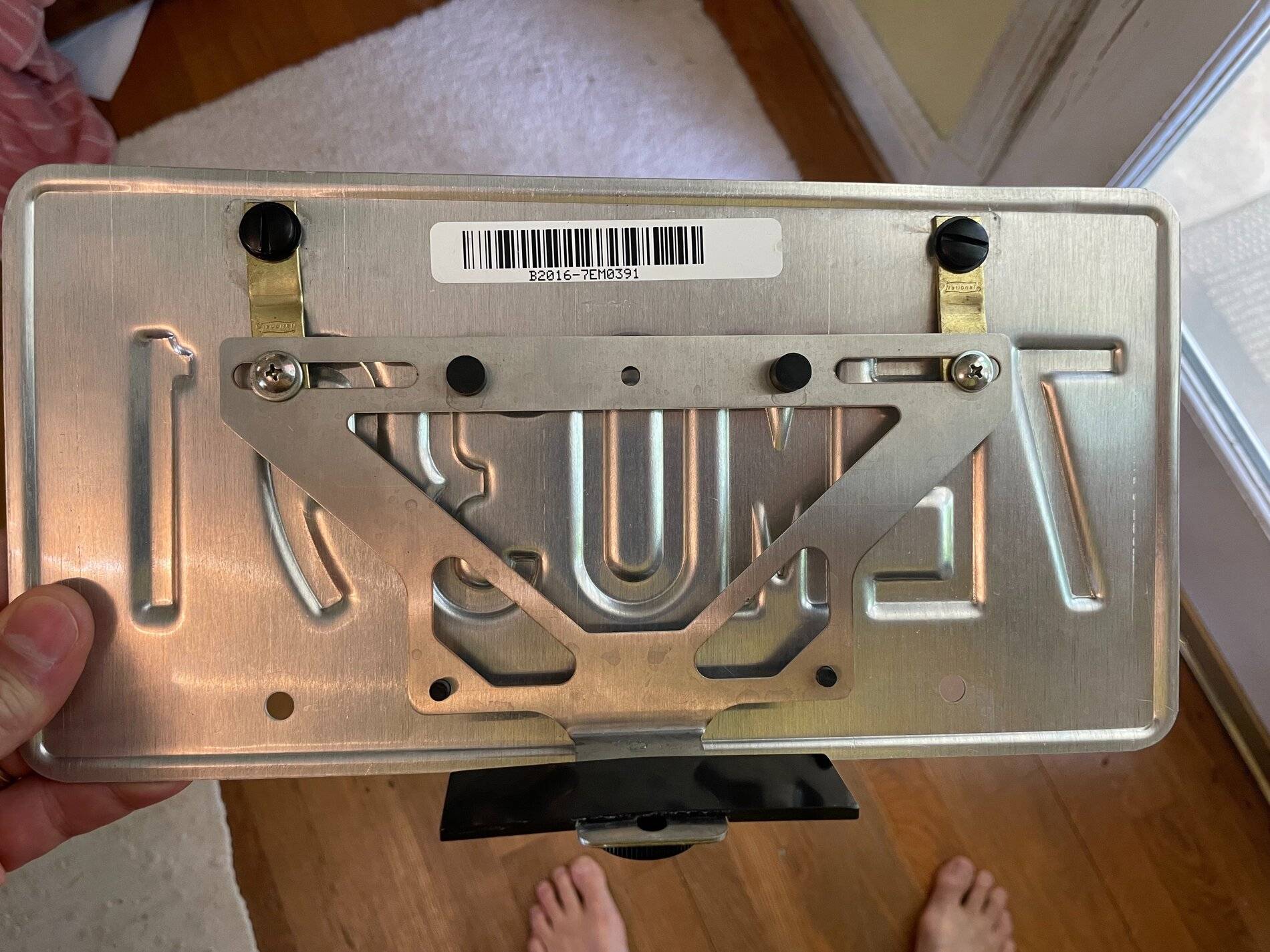

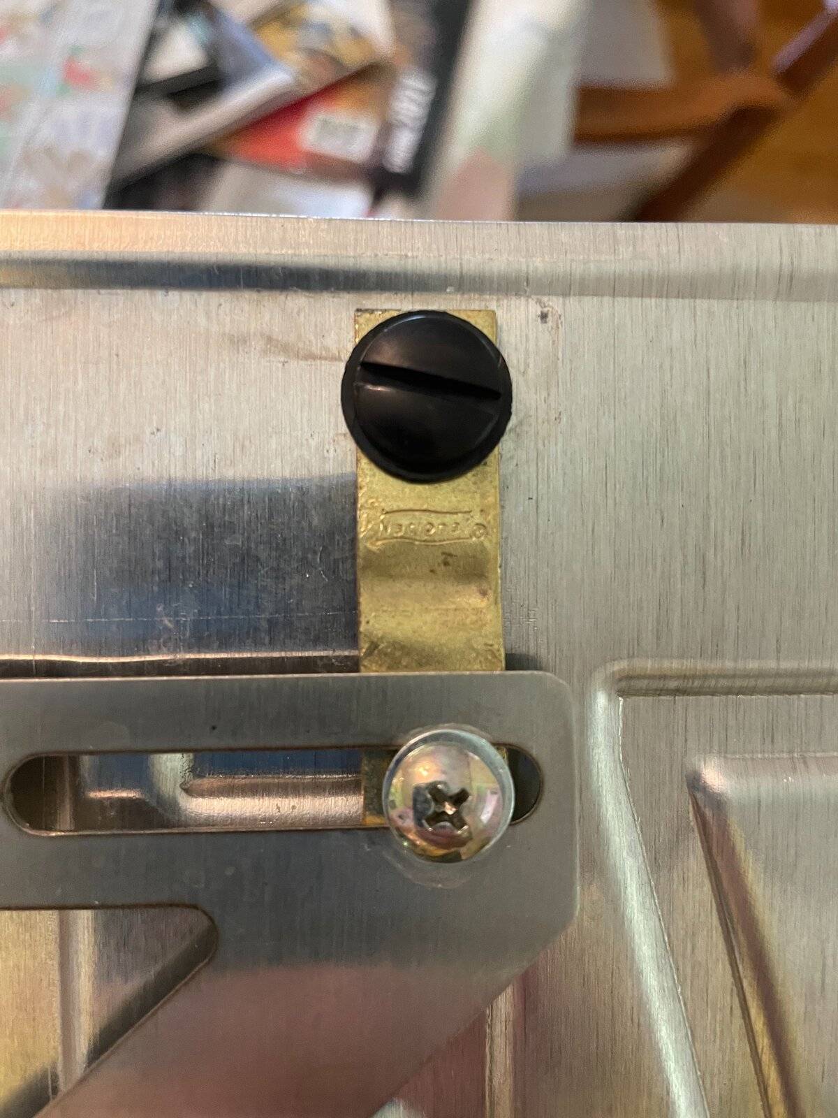

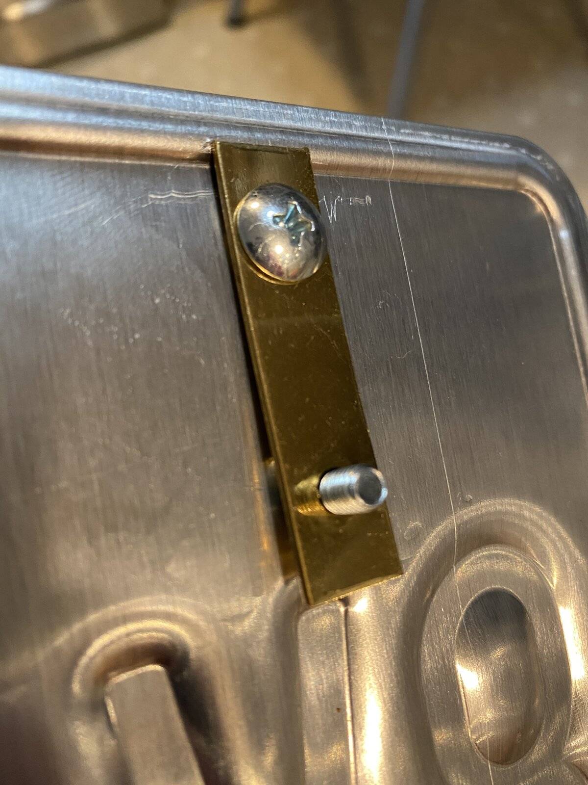

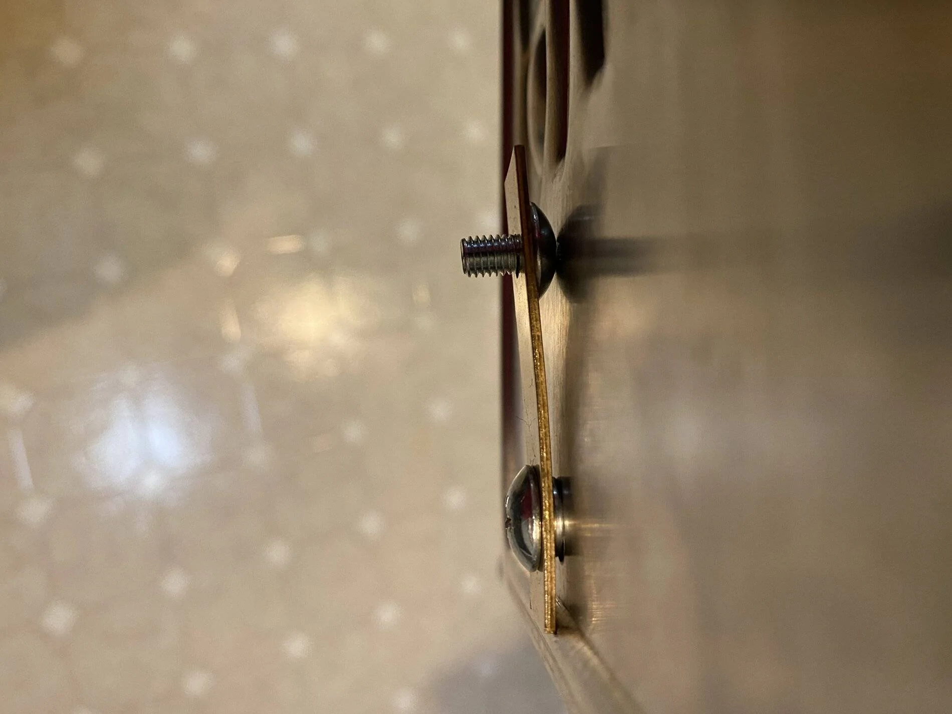

So I got my permanent plate and sure enough it’s causing the sensors to go crazy. I decided to try a DIY solution to make the Craig’s bracket work and it works great! Everything was off the shelf parts from a local hardware store for less than $5.
I used 5mm bolts (2 x 9mm long and 2 x 10mm). Flange nuts, safety washers and a drop of locktite.

Craigs mount lowers the position of the plate from the factory location and it apparently intersects with the sensor area. Raising the plate up a bit fixed it.

I found everything at my local hardware store.
The bracket is about 2” long and fit the 5mm bolts perfect.
