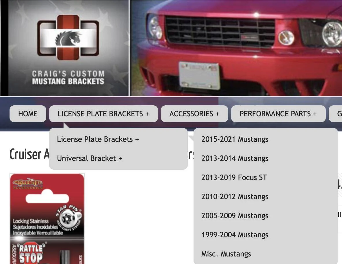

While the 2021 Mustang Mach E page (http://ccmustangbrackets.com/product/2021-mustang-mach-e/ ) still exists, Craig no longer promotes this page on his menu:
Ford Mustang Mach-E (Solved) Craigs front plate mount causing issues Screen Shot 2021-08-04 at 12.06.36 PM
This bracket is still found under the Universal Bracket tab. When I emailed him about my failed adhesive, he informed me he has no plans to make a bracket specific to the Mach E.
11,317
22,868
