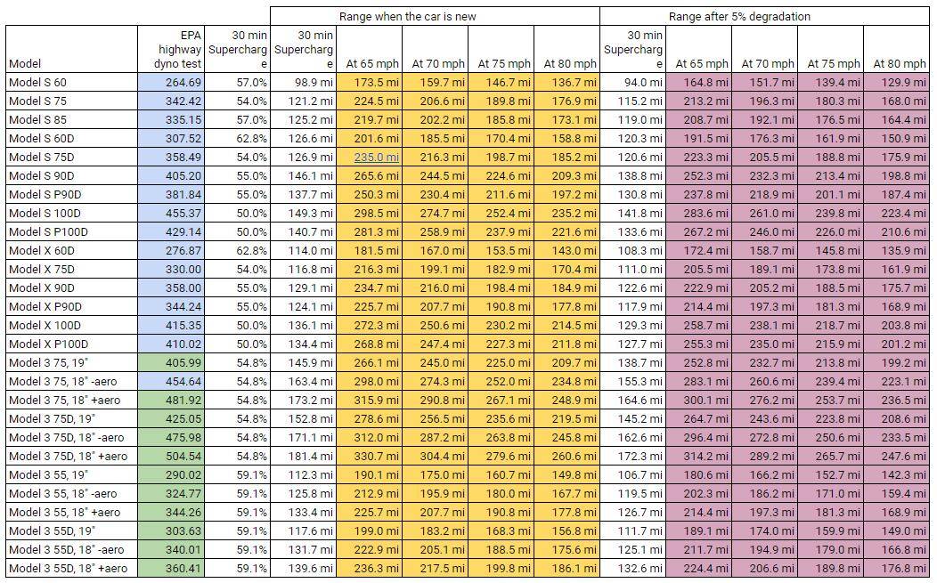

And this is where Tesla's advantage is apparent. Not only does Tesla have faster charging but cheaper as well ($.30/kwh) - it IS cheaper using superchargers than gas. Eventually EA might get cheaper, but only if there is legitimate high current competition OR Ford et al subsidize the charging like Tesla does
During interstate driving with usual speeds, your efficiency will drop as will the range. Since we do not have actual MME owners reporting on such, we can turn to the Tesla forum(s) ( https://forums.tesla.com/forum/forums/model-3-consumptionrange-75-mph-constant-speed) for such-(model 3 more aero than the higher and heavier MME) :
83 mph 355 Wh/mi
80 mpg 320 Wh/mi
75 mph 305 Wh/mi
70 mpg 280 Wh/mi
65 mph - 232 w/mi
70 mph - 262 w/mi
75 mph - 302 w/mi
60F No heat or A/C @75 mph - ~233 Wh/m
75 °F with A/C @75 mph - ~237 Wh/m
85 °F with A/C @75 mph - ~239 Wh/m
50 °F with Heat @ 75 mph - 262 Wh/m
32 °F with Heat @ 75 mph - 299 Wh/m
23 °F with Heat @ 75 mph - 320 Wh/m
a chart for comparing model S-X-3:
Ford Mustang Mach-E SR Battery or ER Battery 1593357889855
The owner reports and figures "vary", In short, your cost to recharge the BEV is likely going to be higher than "official" range/efficiency attached to the BEV.
