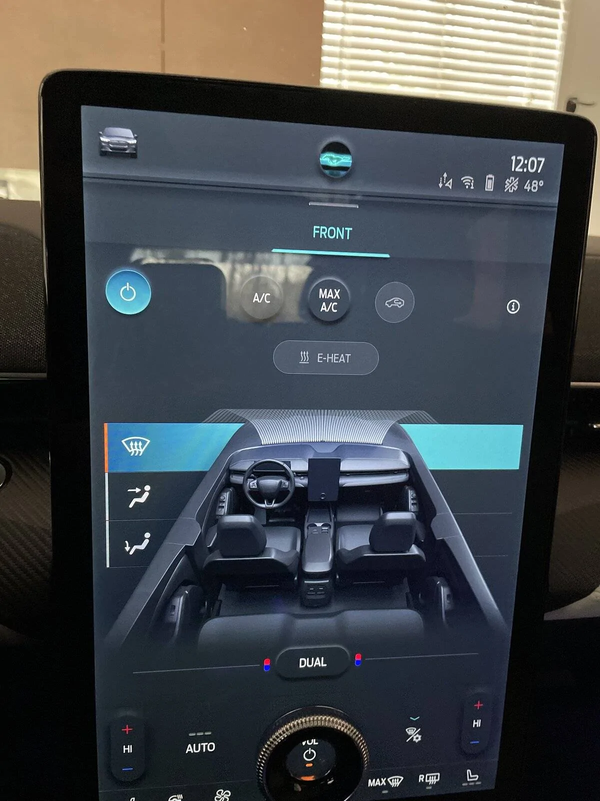

The air is being warmed by resistive heat for defrost. This doesn’t save you any power if you are just doing this to heat the cabin. If they didn’t heat the defrost air it wouldn’t clear the glass.I’m a new owner. Been doing a lot of research on the E-HEAT.
it would appear you can heat the cabin (at least while driving) with the defrost .
with the e-heat button OFF the air coming out of the defrost is warm to hot.
can anyone describe why defrost seems to provide warm air without e-heat switches on?
im not complaining! Just want to understand.

thank you for the reply. I wonder why the E-Heat doesn’t light up when defrost is on (producing heated air) yet e-heat does light when face and foot vents are activated?? Again, thanks for the reply.The air is being warmed by resistive heat for defrost. This doesn’t save you any power if you are just doing this to heat the cabin. If they didn’t heat the defrost air it wouldn’t clear the glass.
in a few model generations all EVs will have heat pumps to make heat as it saves about half the power that resistive heat requires. For now the MME uses resistive heat…. Cheap and easy to engineer but uses a lot of power…. That’s why the suggestions are to rely more on seat heat than heating the cabin…. It’s still resistive but is much smaller than heating the entire inside of the car.
In your photo, the recirculation and e-heat buttons are displayed in their disabled states. Meaning, you could tap them, but your taps will be ignored -- no change will occur. Notice how they are "flat," unlike the three dimensional A/C and MAX A/C buttons?thank you for the reply. I wonder why the E-Heat doesn’t light up when defrost is on (producing heated air) yet e-heat does light when face and foot vents are activated?? Again, thanks for the reply.

thank you. I can say for SURE, regardless if the Eheat button is illuminated, the car is consuming energy from the battery! The range is severely reduced relative to actual miles drive when defrost is on.In your photo, the recirculation and e-heat buttons are displayed in their disabled states. Meaning, you could tap them, but your taps will be ignored -- no change will occur. Notice how they are "flat," unlike the three dimensional A/C and MAX A/C buttons?
It looks like maybe the Mach-E's UI designers accounted for a disabled state, but neglected to differentiate disabled-but-on from disabled-and-off. It's one of those fine details in UI work that is often overlooked.
Either that, or it's disabled and OFF but as you suggested, it wouldn't make much sense for the defrost mode to turn off e-heat, especially since defrost also set your temp controls to HI. It's more likely that e-heat is locked ON during defrost.
