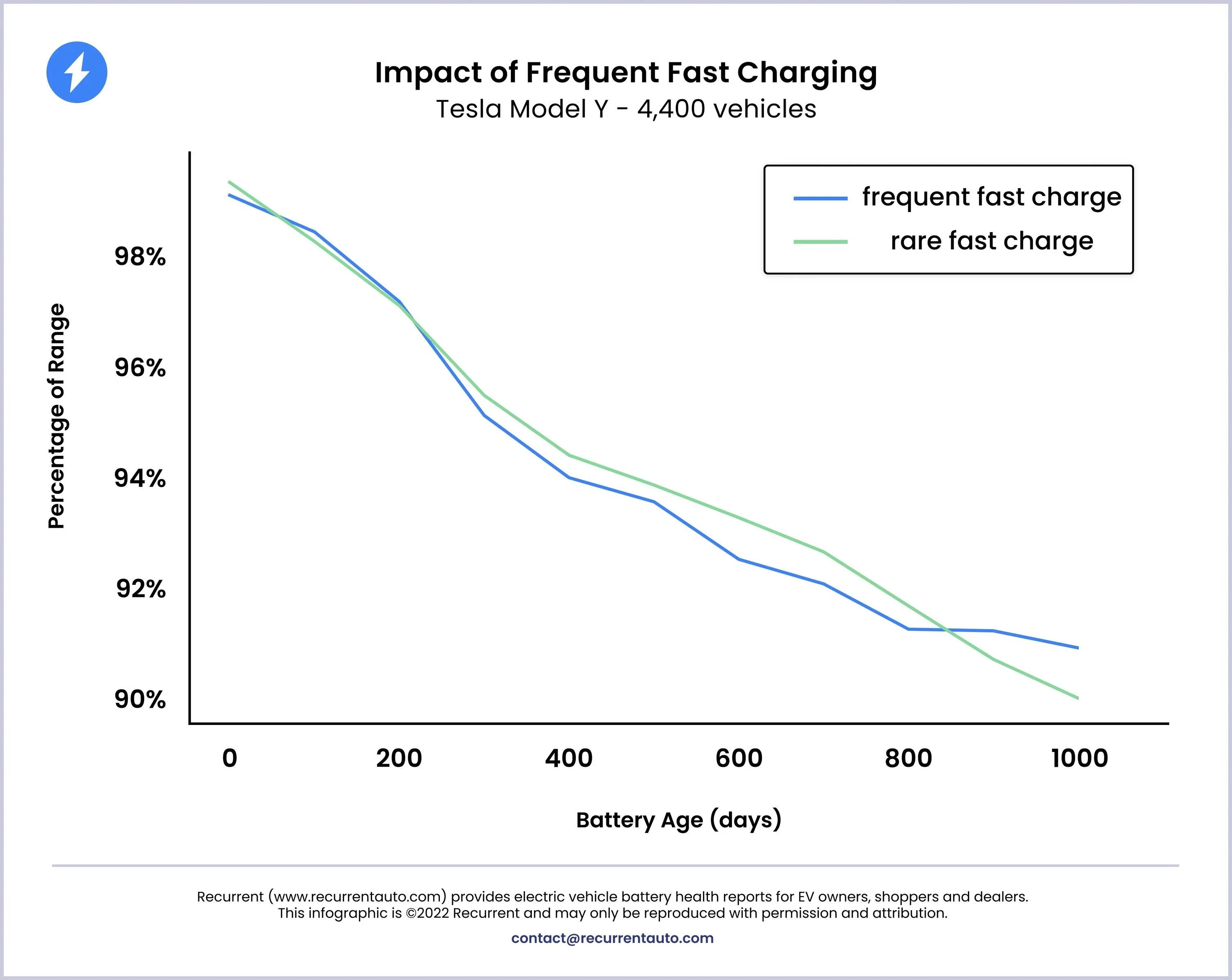

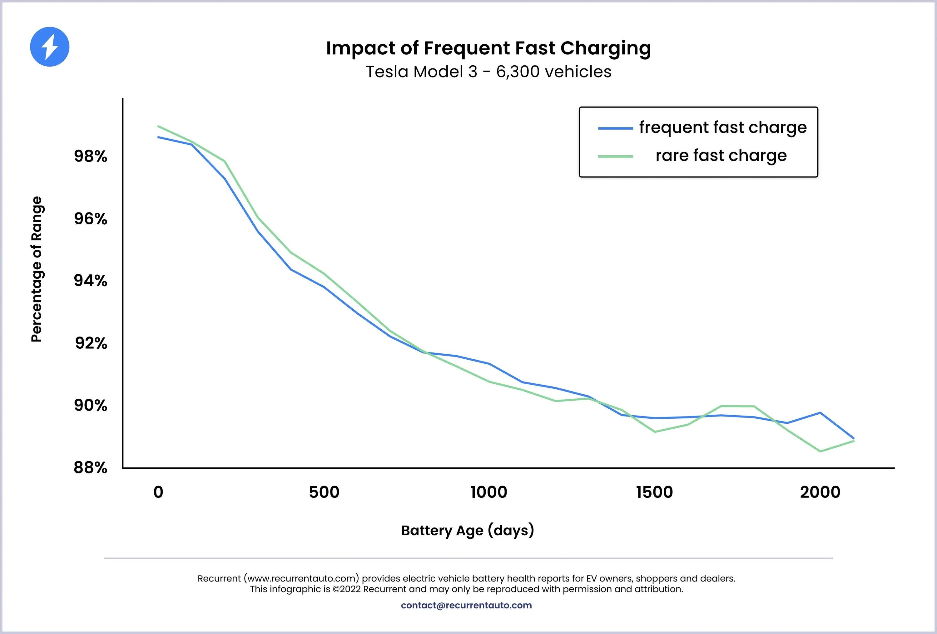

It's still unclear just how "bad" lots of DCFC is for the battery. Same with frequent 100% charges. Sounds like it used to be worse with EVs and batteries made a decade ago but I'm not seeing many reports of it hurting much on cars made in, say, the last 5 years. Most don't have a ton of miles to know yet, but some do.
The only data I've seen is from Teslas tracked through a 3rd party data collector I don't recall the name of. Which showed very little degradation. But Tesla does things differently enough that I don't feel too great extrapolating that to non-Teslas.
I haven't noticed any significant degradation in mine at 51k miles and probably 40-50% DCFC (lots of road trips and no daily commute). But it's also hard to tell in the cold months. Pretty much have to compare summer to summer.
I believe this is what you are looking for:
https://www.recurrentauto.com/research/impacts-of-fast-charging
Ford Mustang Mach-E Supercharger Update Recurrent_impact of DCFC_Tesla Model Y
Ford Mustang Mach-E Supercharger Update Recurrent_impact of DCFC_Tesla Model 3

Yep, thanks. Basically shows that age is the main factor. DCFC made almost no difference.
It's possible some that is a byproduct of their BMS, cooling system, etc. that wouldn't apply to non-Teslas. But I'd guess most of it (if not all) is just better, modern battery tech that we all have.
Hard to really say yet. Time will tell.
note that recurrent is using the tesla dashboard displayed range as a proxy for battery degradation. this is using indirect variables that may vary over time - too many for my taste.
tesla notes:
Displayed range in your Tesla is adapted based on fixed EPA test data, not your personal driving patterns. It’s natural for this to fluctuate slightly based on how you charge the battery throughout its life and how the onboard computer calculates range.
so, battery charging during its life is one component but also is pinned up by other factors.
