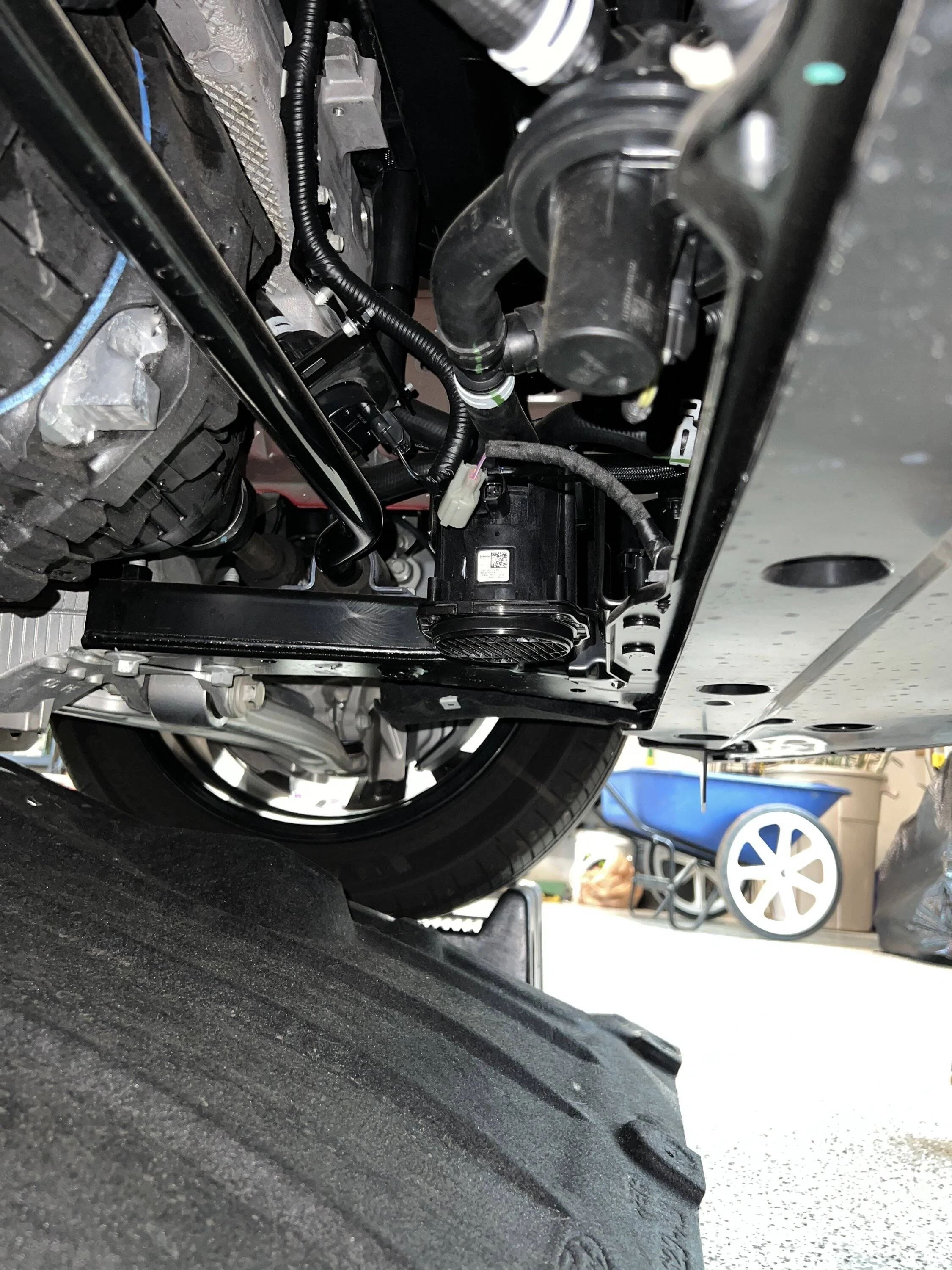

Can anyone confirm that the speaker is in the same location on Job 2's as it was on Job 1's? I didn't recall seeing it when I put on my hitch and have everything pulled down. I just pulled out a few screws to peek in there again and I still don't see it. I purchased the bypass kit from MegaOhm but if I can't find the speaker I can't do much with it.
(Its entirely possible I'm just looking in the wrong spot!)

The speaker is in the front driver’s side, just in front of the axle. Only one speaker provides backup beeper and UFO sound at slow speeds. See photo….

The rear speaker is not the one that generates noise for the reverse or forward motion warnings. As @Miav8r said, it’s up front. ??
Wait... its in the front? ?????? - No wonder I couldn't find it, I was looking around the back - I could have sworn the sound was coming from there! ??‍♂
interesting about the UFO sounds; I didn't know it killed that too.. Might have me re-thinking this..
