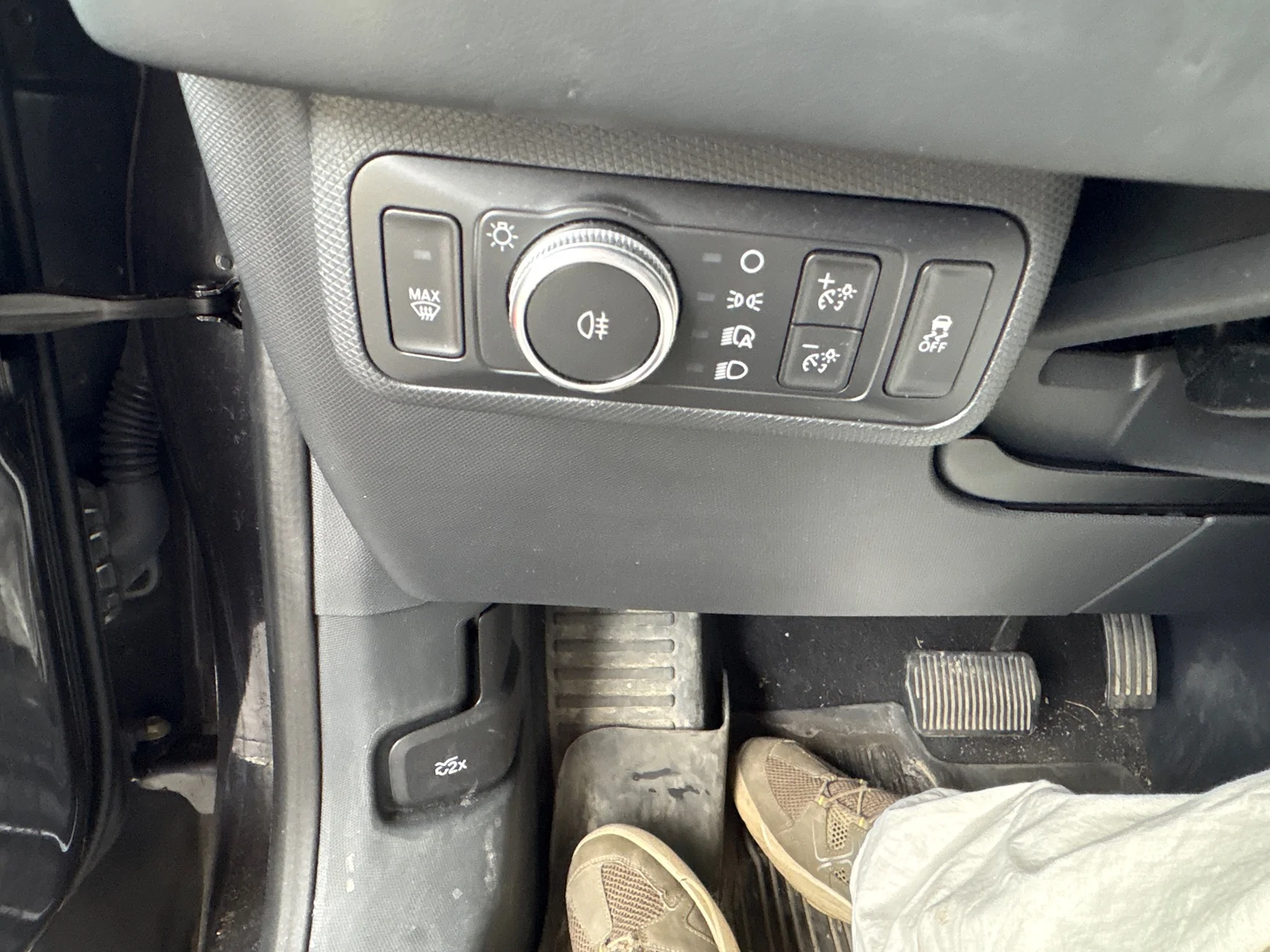

Not in the US. As far as I know, China is the only country that requires a physical max defrost button. I know both Tesla and Rivian do not have physical max defrost buttons and their might be others.
Not sure if it’s regulated here in EU, but at least in Norway we have a max defrost button too, down with out left leg (where brightness buttons are). Maybe it’s US marked not having it?

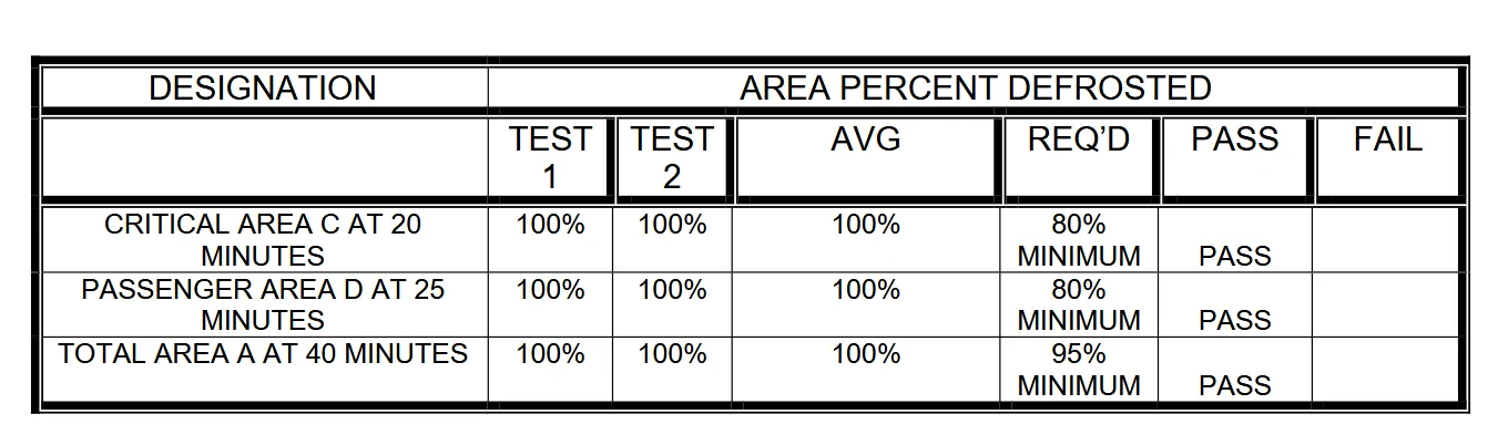

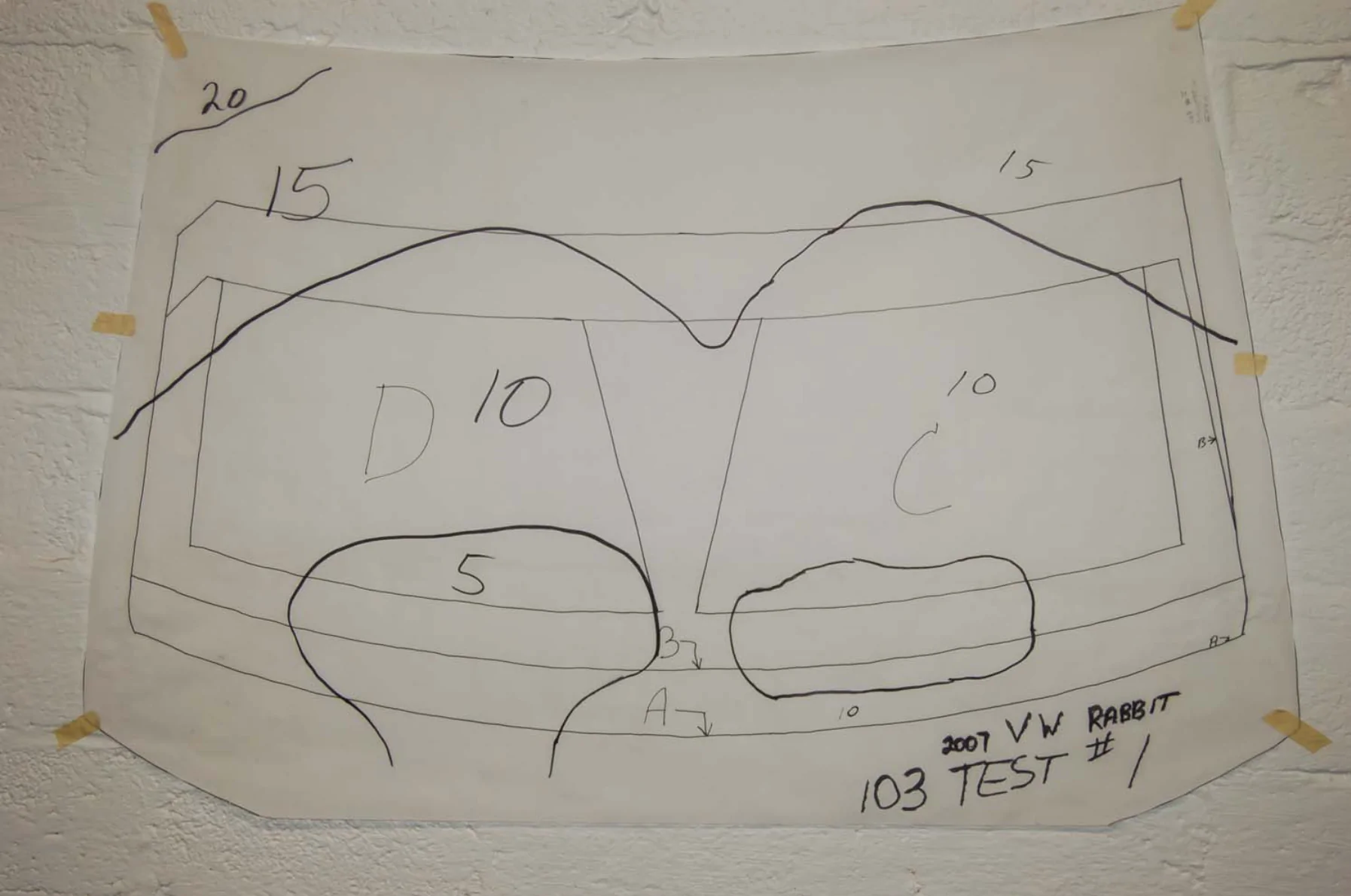

That is correct. The requirement is a set time until defrosted so if you only have a software button and your software takes a little long to boot or your screen doesn't turn on, it's an automatic recall.
The set time is 40 minutes per 103...
Sample test with outlines at 5 minute intervals
Ford Mustang Mach-E SYNC-26.2.8.3 (the big SYNC update) 1785017964824-xv
Pass/Fail areas with required minimums to pass at a specific point in time
Ford Mustang Mach-E SYNC-26.2.8.3 (the big SYNC update) 1785018238701-6z
BTW, this was on a Rabbit with manual controls. It beat test minimums (which are still the same) with 20 minutes to spare...
Bottom line: if a car can meet or beat the minimums at 20, 25, and 40 minutes it passes, even if it does little or nothing in the preceding minutes.
