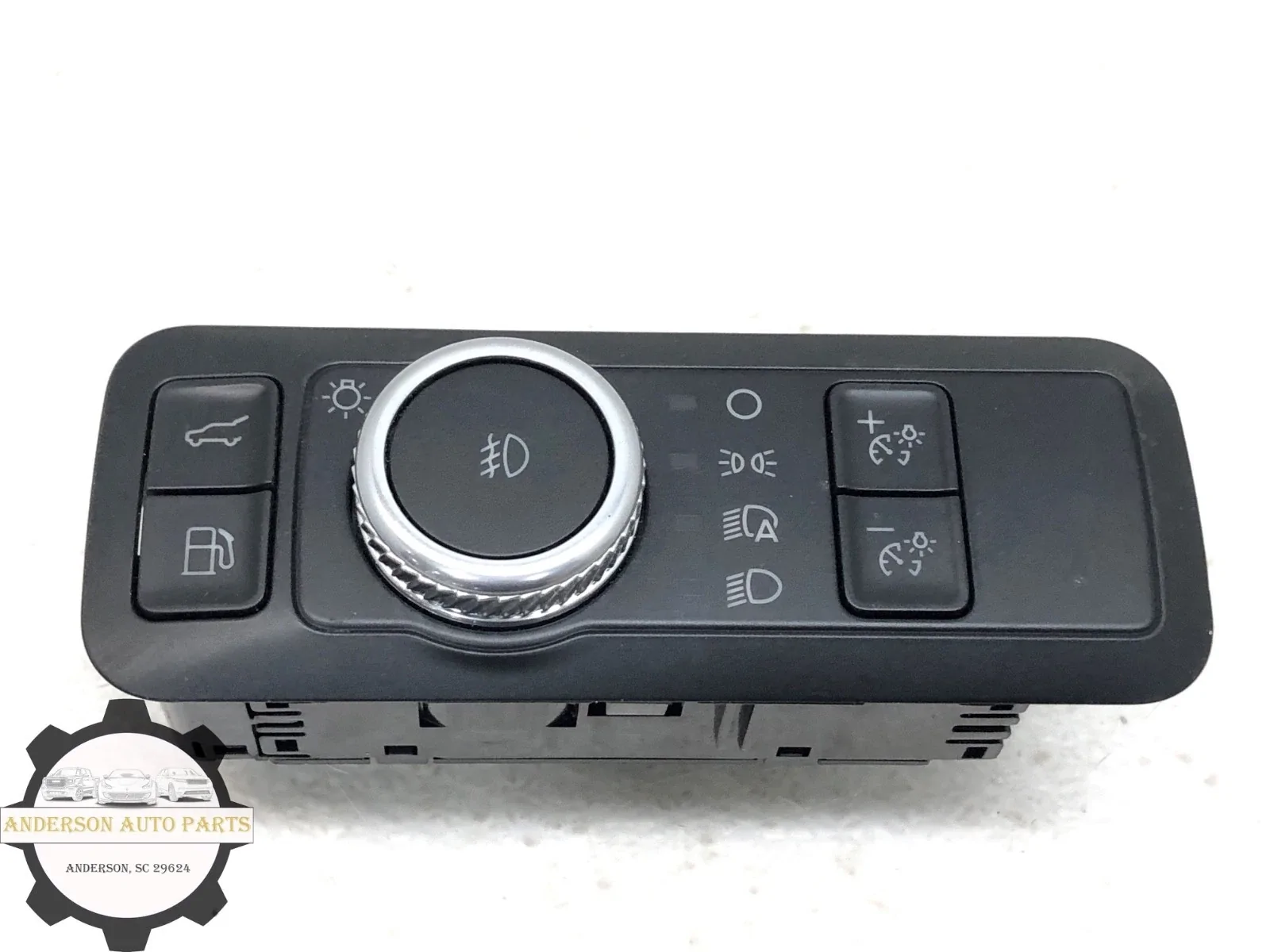

There is a reason my "Adding a Physical Liftgate Interior Power Switch" thread has had 131,412 views. I think people especially if they have had a Ford before, are used to a physical switch for the liftgate/trunk. If I had to guess, I've probably installed this switch in at least 25 Mach-E's.
Fastastic... here I was relatively happy with life, now I'm searching for LB5Z11654SA and LB5T13D061NB on eBay.

Here's an interesting one - @markboris - maybe the fuel door button can be used for a Frunk Switch :D
No, you can't add a physical switch for the frunk like you can for the liftgate. It is not controlled by the BCM like the liftgate is. It is a completely different system and if you were to connect the inside frunk release switch to a switch inside the car, you would find you can open the frunk at anytime even if the car is in Drive.
I seem to remember you saying that before, maybe a latch for the charge port door?
That seems like it would be less a mod than a serious overhaul given that the current charge port door is mechanical.
