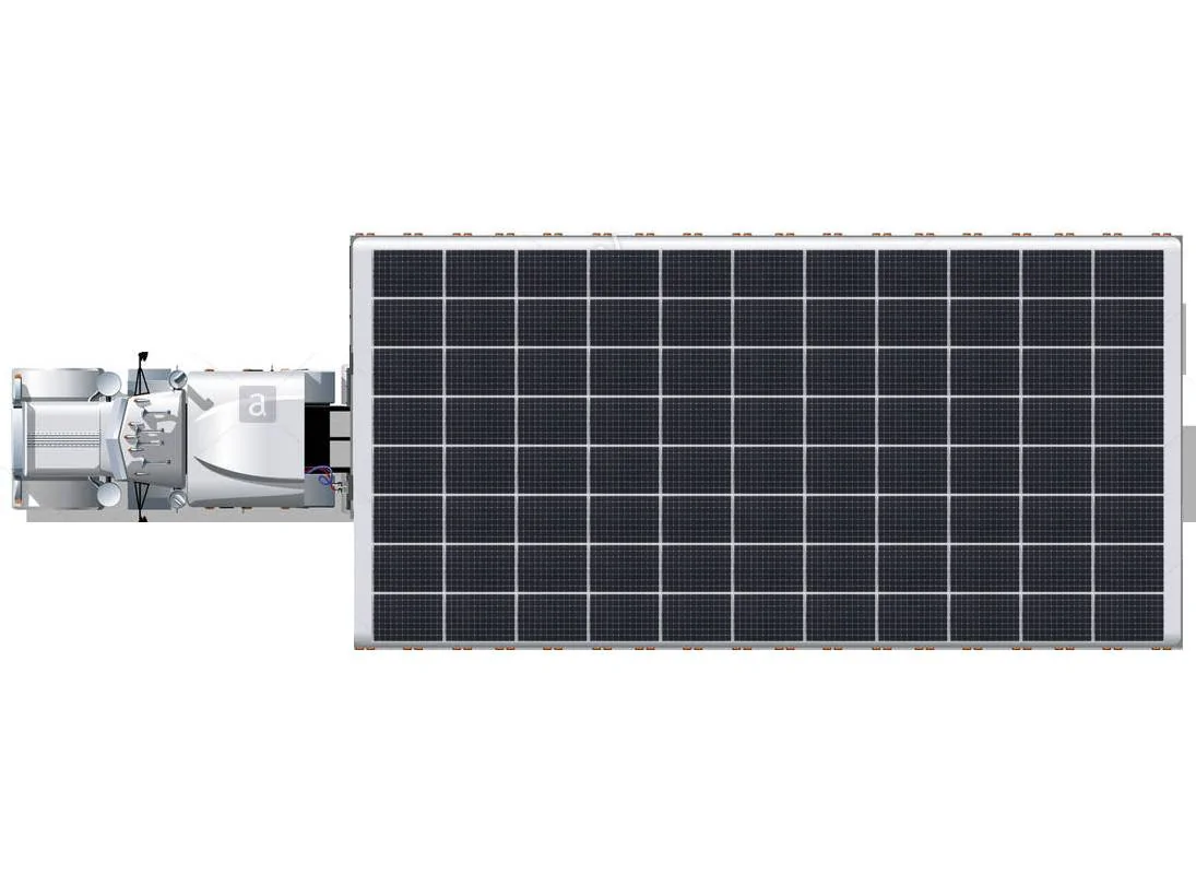

It's super easy, barely an inconvenience:
1. You start with an arbitrary claim, such as that a 100kW solar array will fit in 1,000 ft^2 (never mind that a 100kW solar array needs at least 7 times that much area).
2. You then imagine that a 40 foot trailer is 25 feet wide.
3. You then imagine that the 25 foot wide trailer has batteries with enough capacity to always be able to store the converted energy.
4. You then imagine that all tractor trailers will have an efficiency pulled from the Tesla website, despite that estimated efficiency being a function of the Tesla design, and that a mix-and-match will be significantly less efficient, even more so since a good 8-and-a-half feet of the trailer will be sticking out from each side rather than tucked behind the tractor.
5. You then work backwards. If it requires 2kWh/mile and I want to say my 25 foot wide tractor trailer will gain 100-200 miles each day from the 1/7th scale solar farm on the roof, it only needs to be in the sun for 2-4 hours.
Q.E.D.
