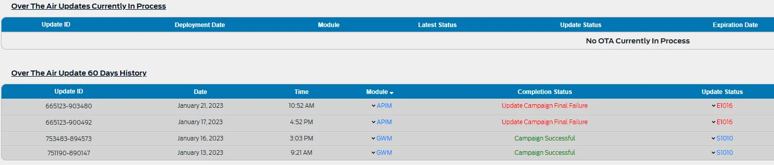

I'm just a bit frustrated because I just bought a mongoose plus cable with power supply and now I'm stuck with FRDS license. I don't see before that it is not possible to bought 2 days session code in my country (France)...
Ford, are you serious ?!
My car is with an old APIM version and no OTA updates can be made.
Ford Mustang Mach-E The Complete DIY Guide to Updating Your Mach-E with FDRS 1680249287949
I will have to discuss/negociate with my dealer to update this. but don't have chance to update all the modules...
Or someone had possibility to buy a 2 days code for me and I paypal him ?
