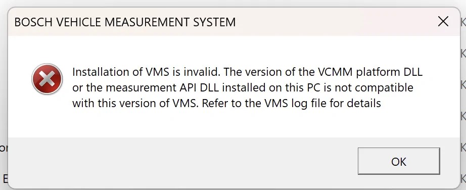

Any suggestions on how to resolve this error trying to launch app on my PC?
Ford Mustang Mach-E The Complete DIY Guide to Updating Your Mach-E with FDRS Parallels Desktop - Windows 11 2023-09-15 at 2.24.21 PM
